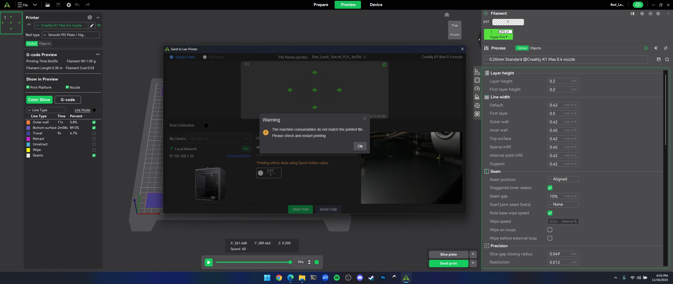

The slicer thinks I have the CFS multicolor but I don’t even own a CFS so why is this happening and my printer is the k1 max

Simple solution: choose for SEND ONLY, after uploading the file you can start the print!
Seems there is another solution, by changing the filament in the DEVICE-tab (haven’t checked this, printer is busy printing)…
Yes Creality ******-up with the latest firmware update (3.5.5.18)… they already blocked this update…
Just send your file after slicing to your printer. Activate the print then from the display panel of your printer

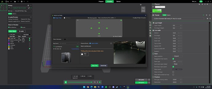

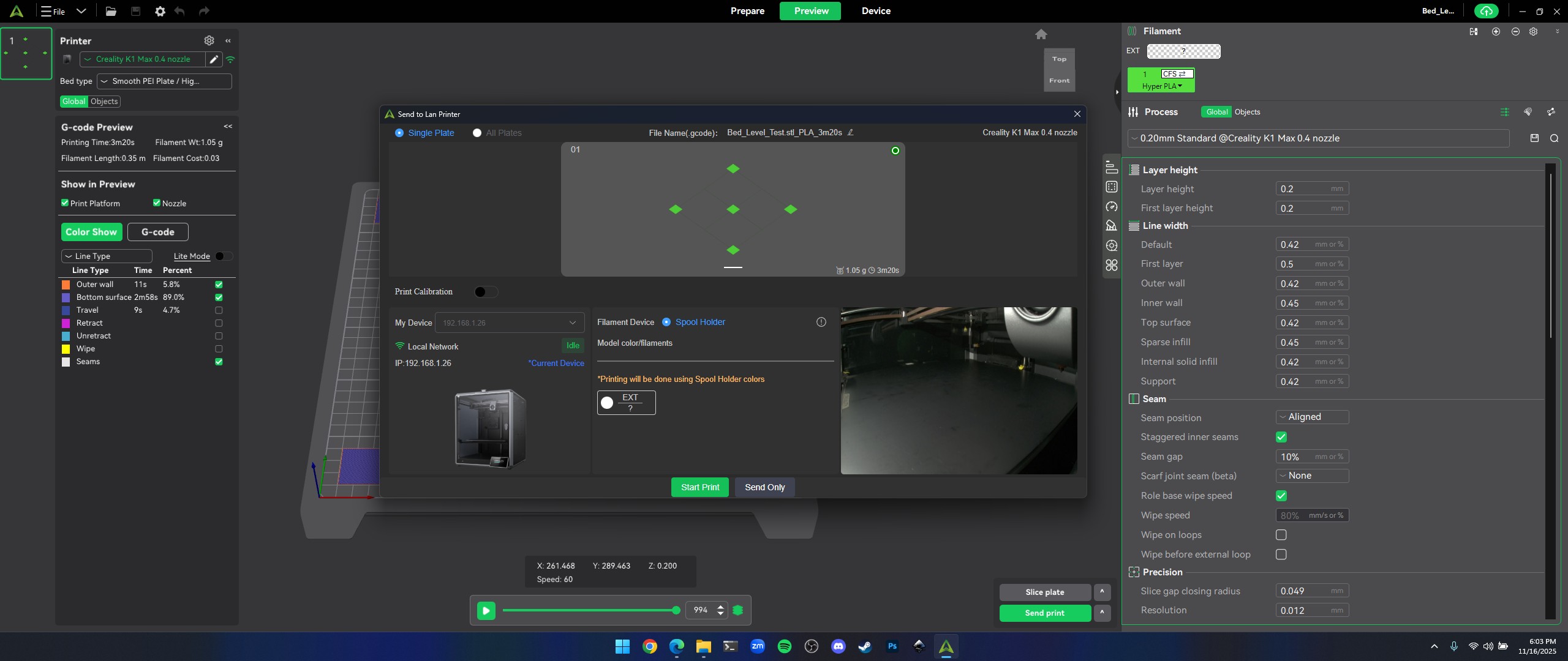

You can simply solve the problem by doing this:
- Open Creality Print
- Go to DEVICE-tab
- Click on DETAILS-button (on the right side of the screen you will see FILAMENTS)
- Click on the pencil-icon beneath the Spool Holder icon
- Change the settings or at least the color
- Press OK
From now on you can send and directly PRINT again like you did before…
