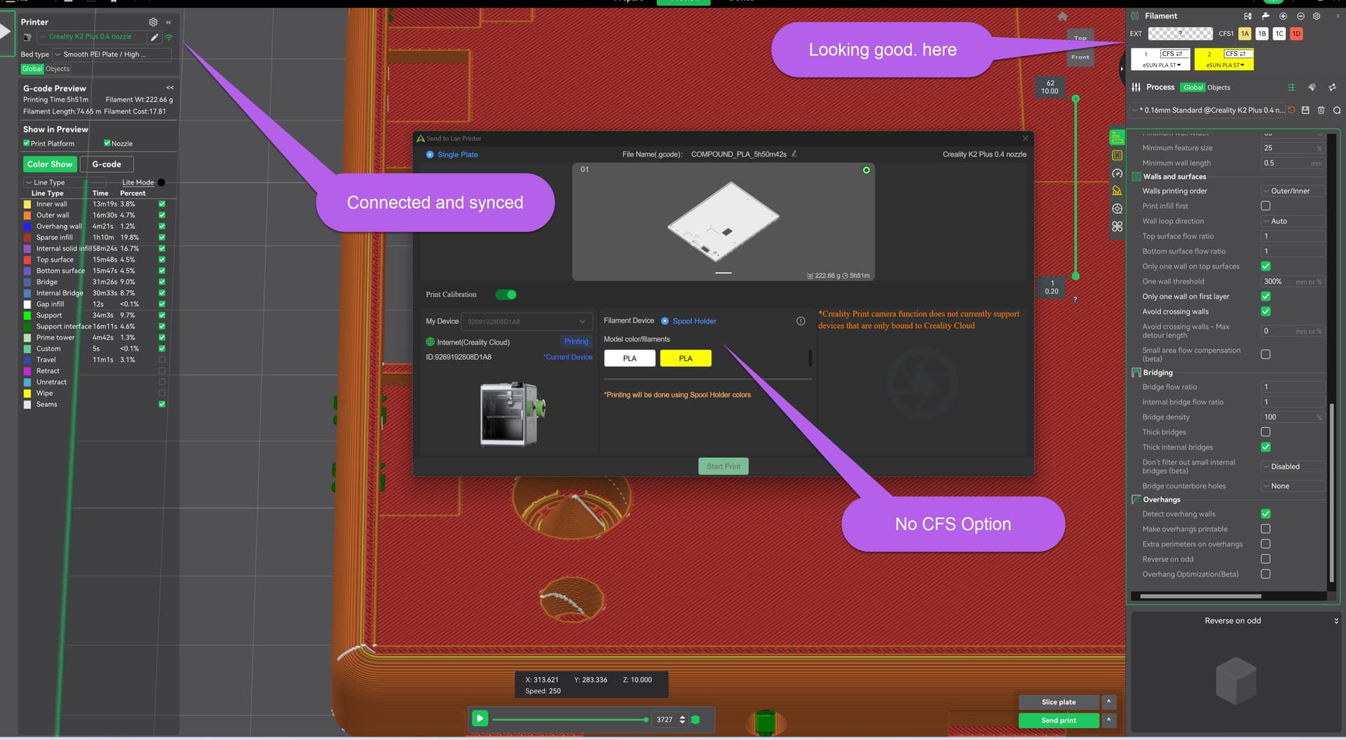

Can't print using CFS from Creality Print
Was working fine but not anymore.
If I upload to the cloud I can print with the CFS using the android App
Software version: 6.2.0
Plz assist.
tnx
Same problem for me. I’ve reinstalled latest 6.1 version and it work.
I’ve installed latest version 6.2.2.3204 on PC and now it works.
