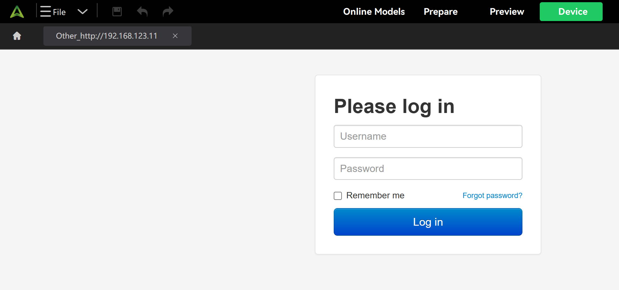

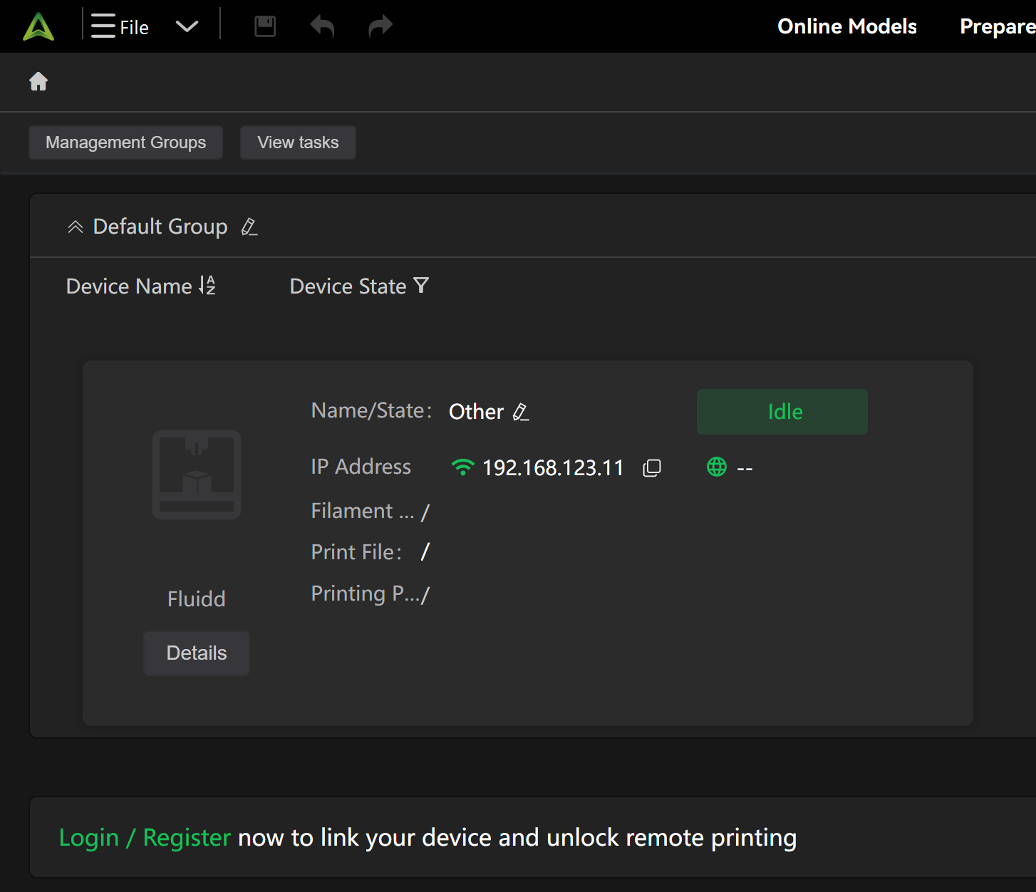

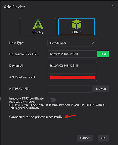

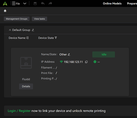

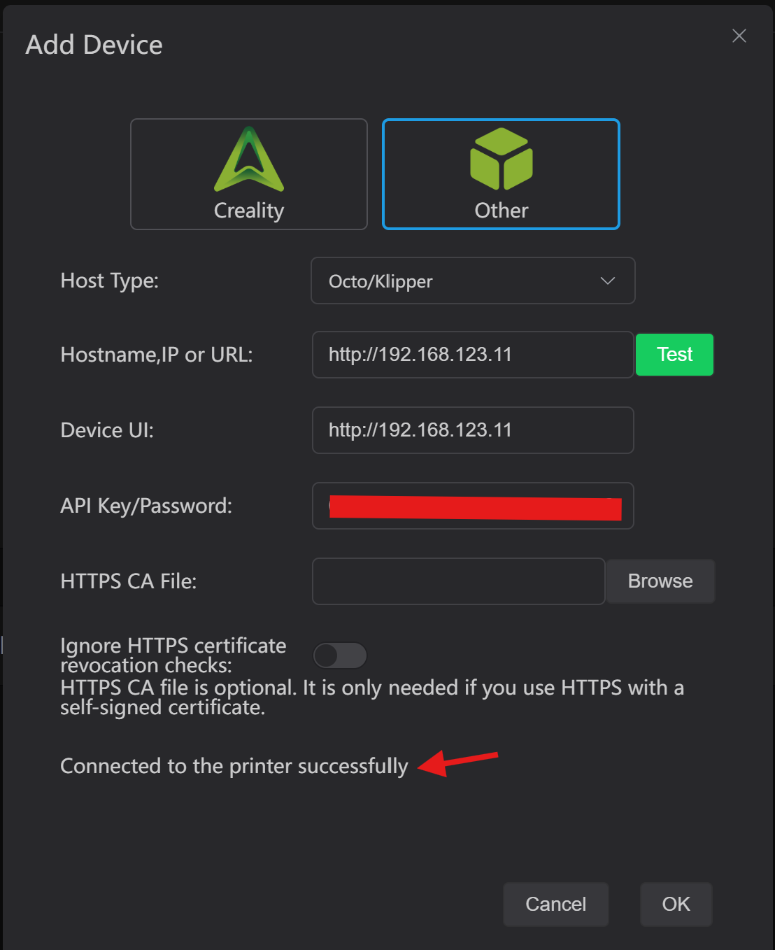

In the Device section of Creality Print, I manually added a new “other” printer of type “Octo/Klipper”. I gave it the IP address and API key, and the test connection is successful (screenshot #1). The new device appears in the sole device group (#2). I can click “Details” on that device, and the OctoPrint web UI loads in Creality Print (#3).

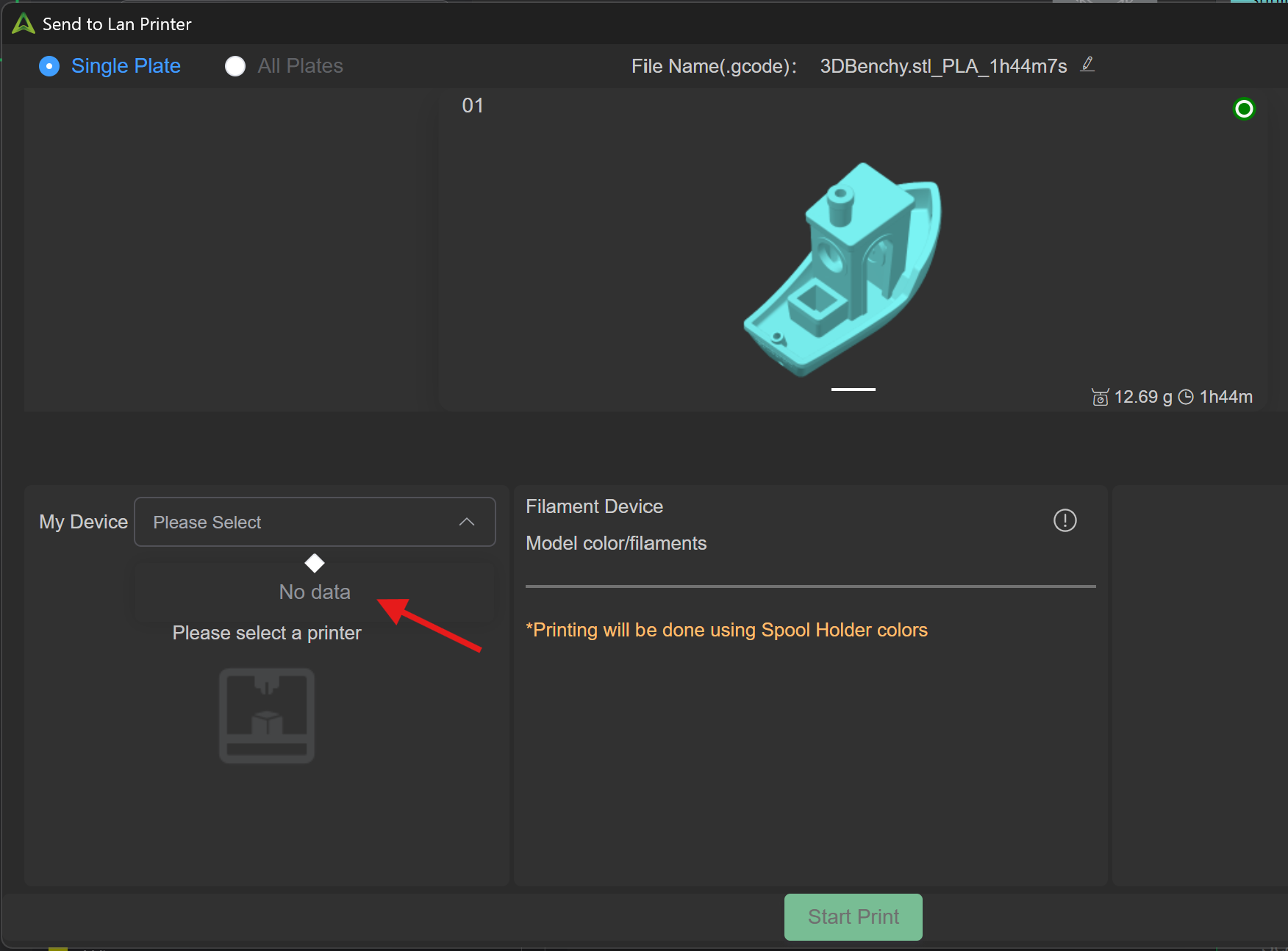

The trouble is when I slice the plate, then choose “Send print” (screenshot #4). There are no devices available to choose from. I’ve deleted and re-added the printer a bunch of times, restarted Creality Print and my whole PC, but the printer never shows up here.
So can anyone help me send a print to the printer? Thanks!
hey, did you find fix for this? I have exact problem as yours.
Sadly, no. I’m starting to wonder if it isn’t even possible, and it can only be done via cloud.
For comparison I should try sending something from Cura/Prusa/some other slicer and see if that works, just to confirm my Octoprint server isn’t the source of the problem. I just haven’t had the free time to try that yet.
Yeah, i switched to orca and copied all settings, after that everything works fine
