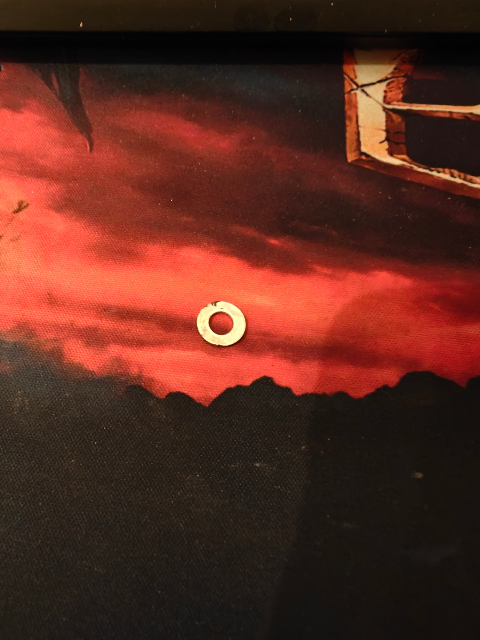

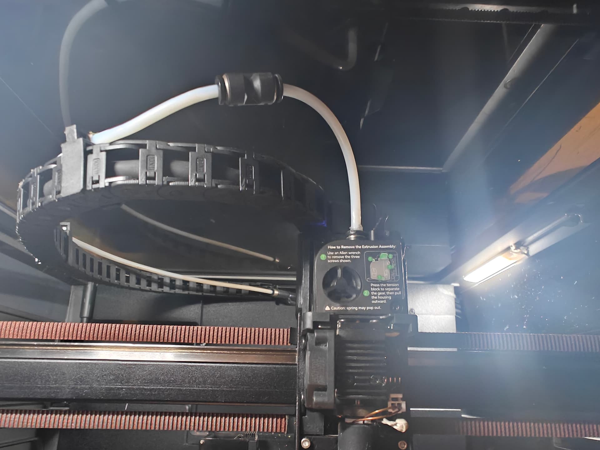

Have used the connector from the reserve parts so i can disconnect the ptfe tube near the extruder (that also is my fix for the connector with the little theet have broken on top of my extruder that hold the ptfe tube in, used some super glue to to hold it in the extruder). And placed 2 washers by the spring in the 4 way hub, needed 2 washer because i have had shorten the spring and that did not work.
