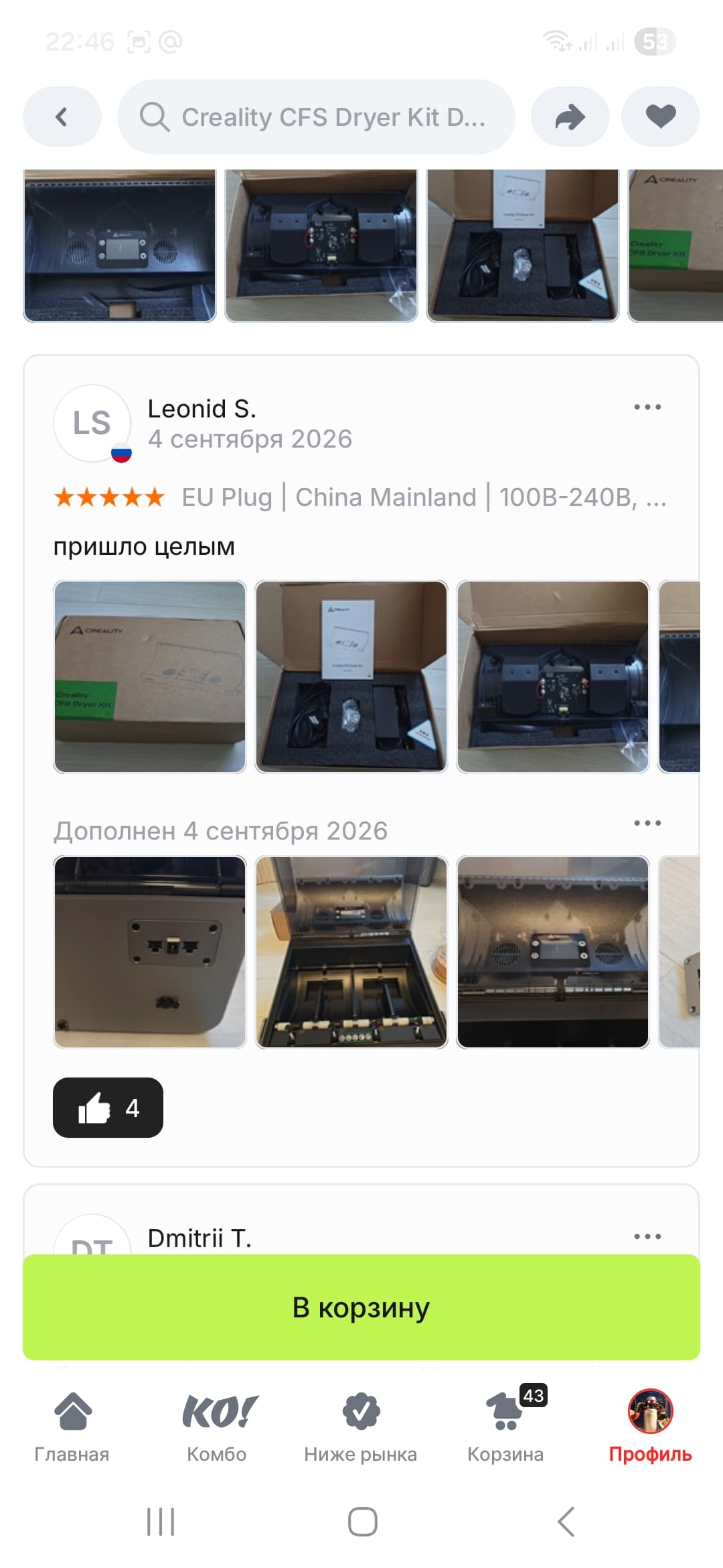

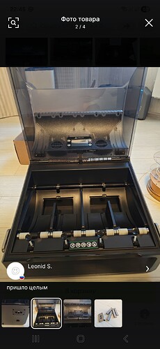

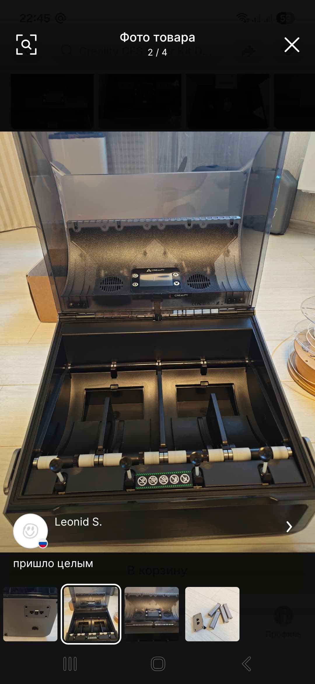

Hello, I ordered this dryer on AliExpress, and it should arrive within a month. Once it gets here, I’ll test it out, write a review, and share it with you here on the forum. Judging by the reviews on the marketplace, it works and people are using it, but there isn’t a detailed review available. One of the reviews mentions that the fans are noisy, but I think this can be fixed.

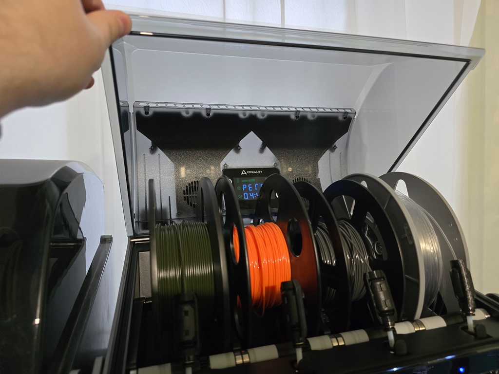

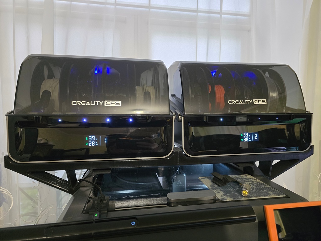

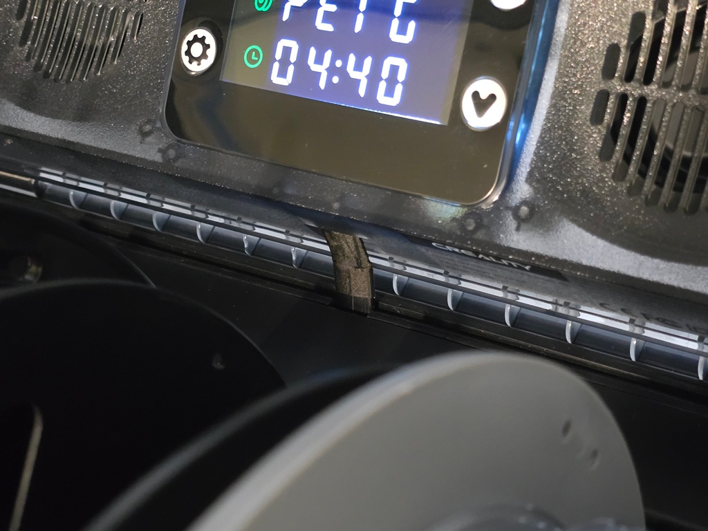

Using this kit (two actually) for almost 2 weeks, and pretty happy with them. Yes the fans are pretty noisy, especially when the printer is not running, but nothing awful - on par with other drying solutions.
The installation is easy, the screen/buttons behind the spools are not very convenient, but definitely usable, but my CFS are located pretty high (about 1.8m above the floor all in all).
They warm up pretty fast, but you have to manually open-close the lid to let out the moisture saturated air (wish they have added some automatic valve or shutter) from time to time, if the filament was “wet”, when it dries up and in storage/maintenance “mode” there is no need to.
Another drawback are the power supplies which are pretty bulcky and with thick wires. There is no place for them, and you will have to hide those yourself somehow.
All in all I definitely recommend those for anyone who stores the filament inside the CFS for prolonged periods of time and when the humidity is high outside printer. Of course if Creality has implemented the same logic/mechanics as the Sunlu i10 - it would`ve been the ultimate and perfect device, but may be some one from the community will come up with such mods later :slight_smile:
