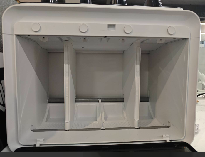

Filament Slots

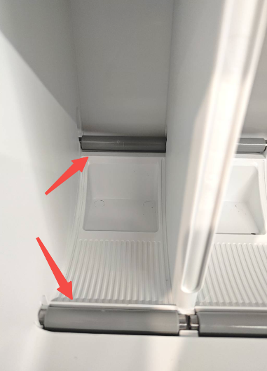

The CFS Lite features four independent filament slots. Each slot is equipped with rollers at both the front and rear, and supports standard 1 kg filament spools. For detailed spool-related precautions, please refer to CFS Lite 耗材兼容性指南
After a filament spool is placed in the slot, it is supported by the front and rear rollers. During filament loading, the rollers assist the spool in rotating, helping to reduce feeding resistance.

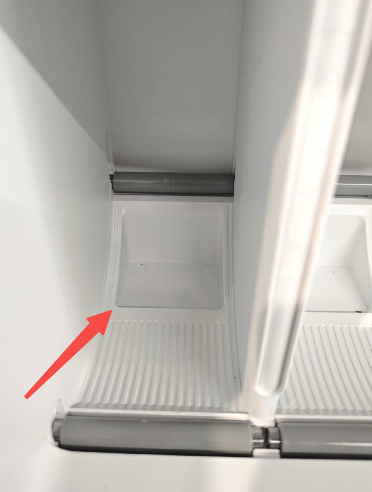

There is a recess at the bottom of each filament slot for placing a desiccant. Four packs of desiccant are included with the machine for your use.
Each filament slot has an independent filament inlet at the top. After the filament is inserted into the inlet, it enters the feeder section, after which the filament is fully managed automatically by the i7 + CFS lite system.

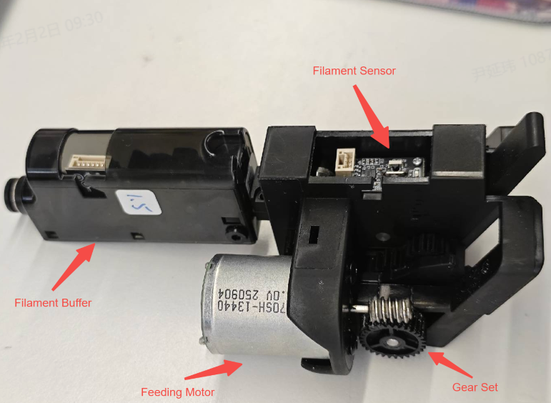

Feeder
Each filament slot is equipped with an independent feeder, which is responsible for feeding filament into or retracting it from the Toolhead.
Filament Detection Sensor
A filament detection sensor is installed in each feeder near the filament inlet. When filament is inserted through the inlet, the sensor is triggered, the motor starts, and the feeding gears grip the filament and automatically feed it forward.
When the filament runs out, the filament tail leaves the detection sensor. The sensor then sends a filament-out signal to the printer, which will automatically trigger a pop-up notification or start an automatic refill process.
Odometer
Each feeder is equipped with an odometer at the pinch roller position. The odometer wheel is a passive roller. When it grips the filament together with the feeding gears and the filament is being fed, the wheel rotates accordingly. This allows the system to determine whether filament is being successfully fed out of the CFS Lite.
Filament Buffer
A filament buffer is installed near the filament outlet to better assist filament feeding. Inside the buffer, there is a photoelectric sensor and a spring. The spring is connected to a black structural block, and together they form a filament entanglement detection module.
During loading or printing, if the external feeding resistance becomes too high and the filament cannot be fed forward properly, the spring inside the buffer will be compressed. When the photoelectric sensor is triggered by the black structural block, a filament entanglement alarm is activated, helping to prevent further printing issues.
For more information, please refer to Wiki: Introduction to the CFS lite Filament Entanglement Detection Function.
