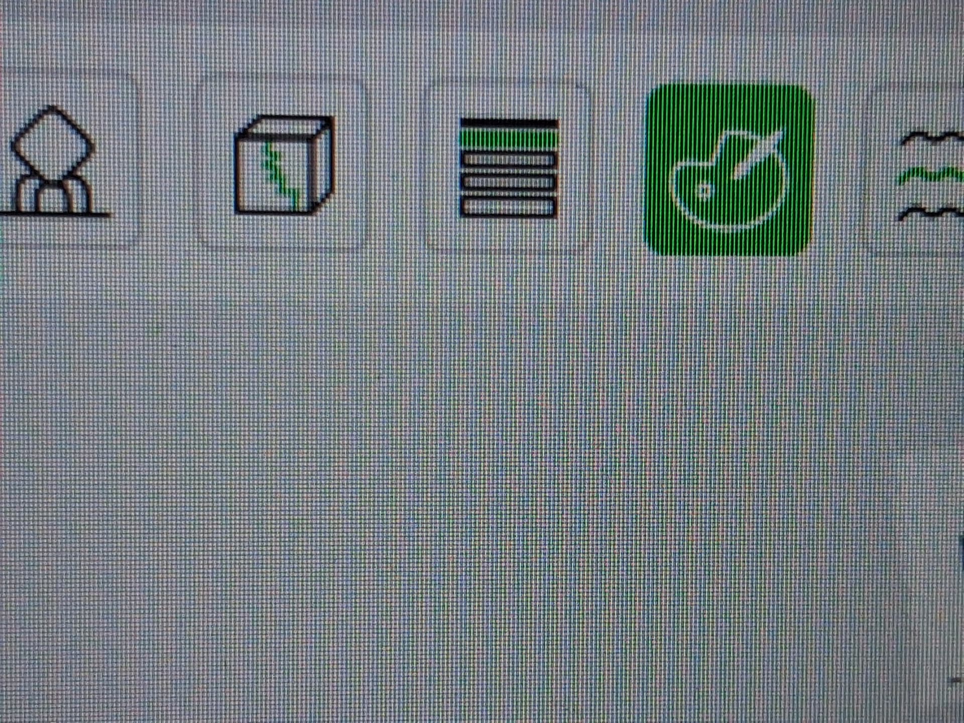

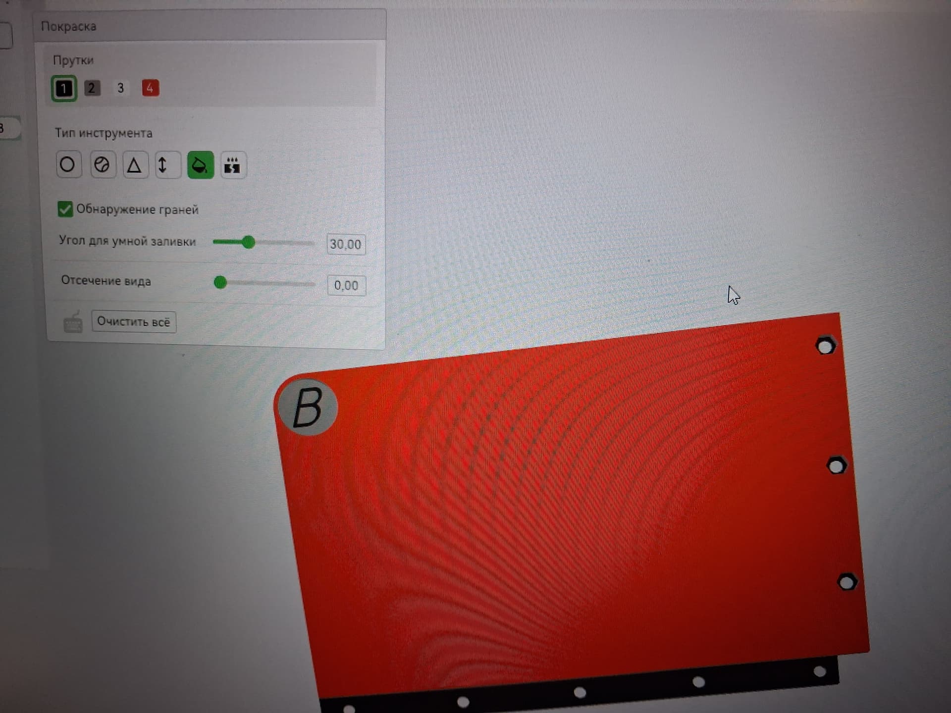

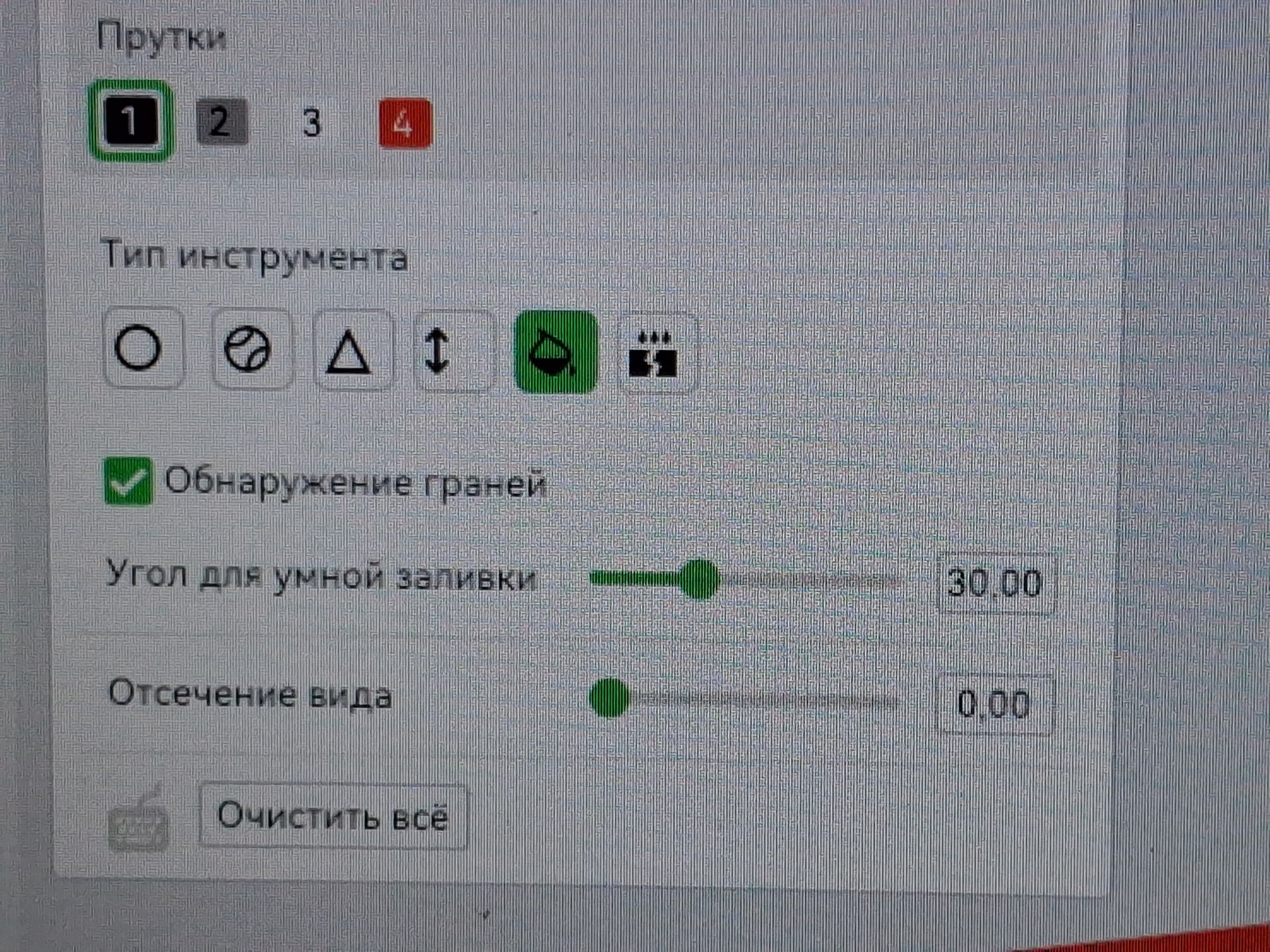

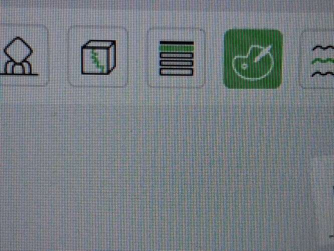

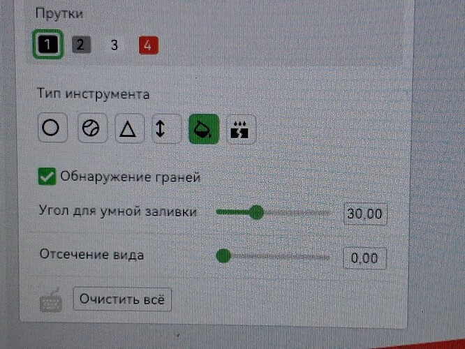

Hello, you should manually color the model in the slicer using the “Palette” tool and then start printing. If you color the model and the color doesn’t change, there’s a problem with the CFS drive. Try loading and unloading each color manually to check the CFS drives. If the drives are OK, then the problem is software or the 3D model itself. Try printing a different, smaller, color model to test. Try updating Creality Print.
