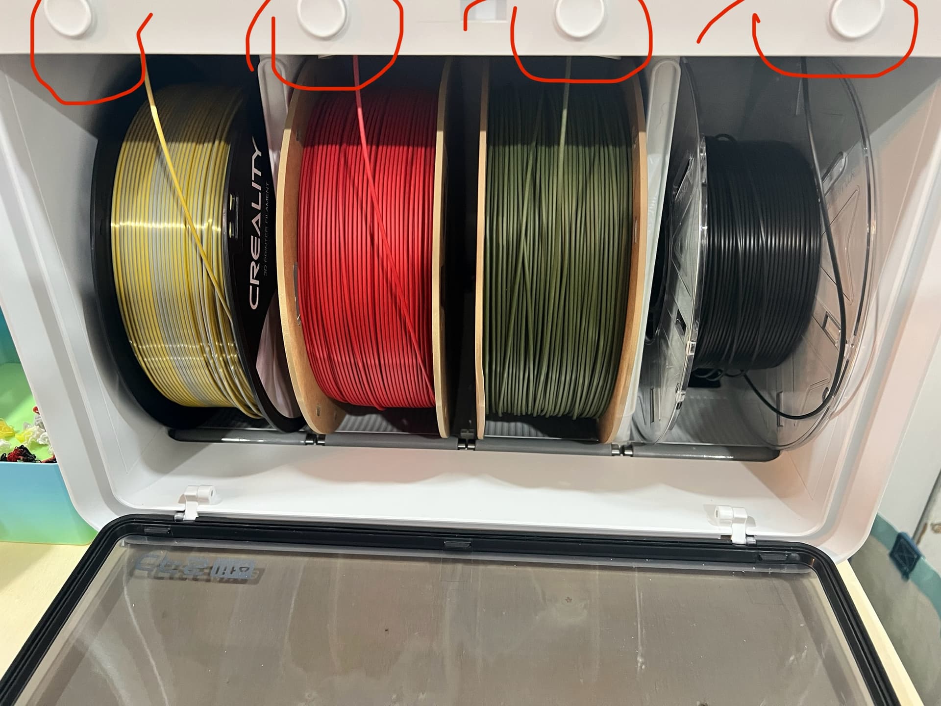

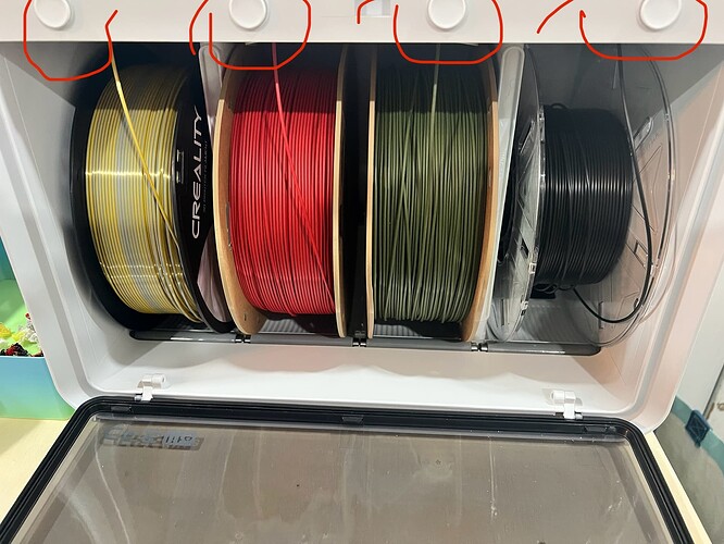

I had to look this up too. After feeding and retracting a bunch of times without it fully unloading the filament from the tubes, I was wicked confused. There is a small circular “button” above the filament inside the cfs lite (open the door and you will see the small circle button above each slot) that when held down will loosen the grip on the filament so that you can pull it out manually. I’m pretty sure this is the only way to get it out without yanking the filament from the grip of the cfs. I usually roll the filament back onto the spool as i pull it out. Makes it easier to grab the end so it doesn’t unravel.

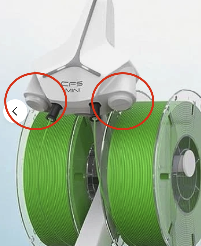

this is for the CFS Mini that comes with the Autofill package that support two filament spools of the same color. When you feed it into the mini, it seems to have a gear that will start to feed it through the PTFE tube so I am hesitant to simply pull it backwards through that gear and haven’t seen a button on the unit like you describe, but will need to look again when I get home, maybe I am just missing it.

just gave it a better look, it has two things that appeared they might have been buttons but they aren’t, they are just part of the molded plastic. I opened a chat with Creality and everything they told me was already tried or disproved so they said they would need to have an engineer email me with the correct procedure.
