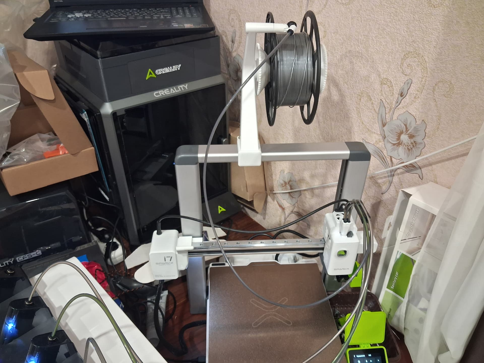

Hello, I used four dark-colored tubes from the kit and installed them in the splitter and the CFS. If you need to print from the spool holder, remove the CFS tube from any of the four outputs and insert it into the holder. I’ll post a photo for clarity. The spools are numbered from left to right, 1234. The order in which you insert the tubes doesn’t matter; the filament enters the splitter one at a time.
Thanks, this is very clear !
