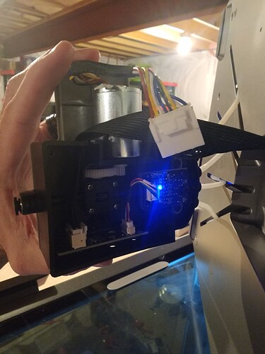

So i removed the module the holds the 4 motors that run the spools and pull in the filament ( the inital motor set that runs the shaft)
I found 1 small piece of filament causing a stall in slot # 2 but caused all 4 filaments not to load.
Check each individual roller set and see if it rolls smoothly. If one is stiff it will set the code. (At least thats what happened to me) then if you do find one stiff continue troubleshooting.

After talking with chat they said to check the 5 way combiner for an LED, which would signal the presence of filament, even though there obvi isnt any.
They said thats the issue and are sending a replacement due tomorrow.

I am having the same issue and went so far as to disassemble the hub and remove the spring loaded metal sensor plate so it could not see anything and still detected it.
I have submitted a ticket to support for the problem requesting a replacement board.

I emailed cs@creality.com and they are finally sending me part number 4004010265 to replace on the CFS. My CFS worked fine initially, but one of the sensors in the hub output board started false sensing.
