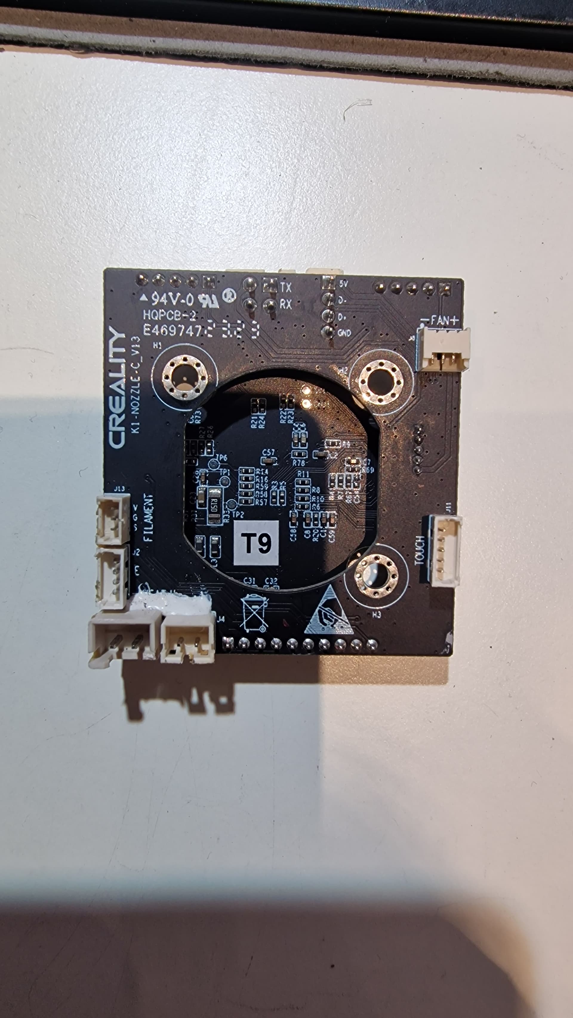

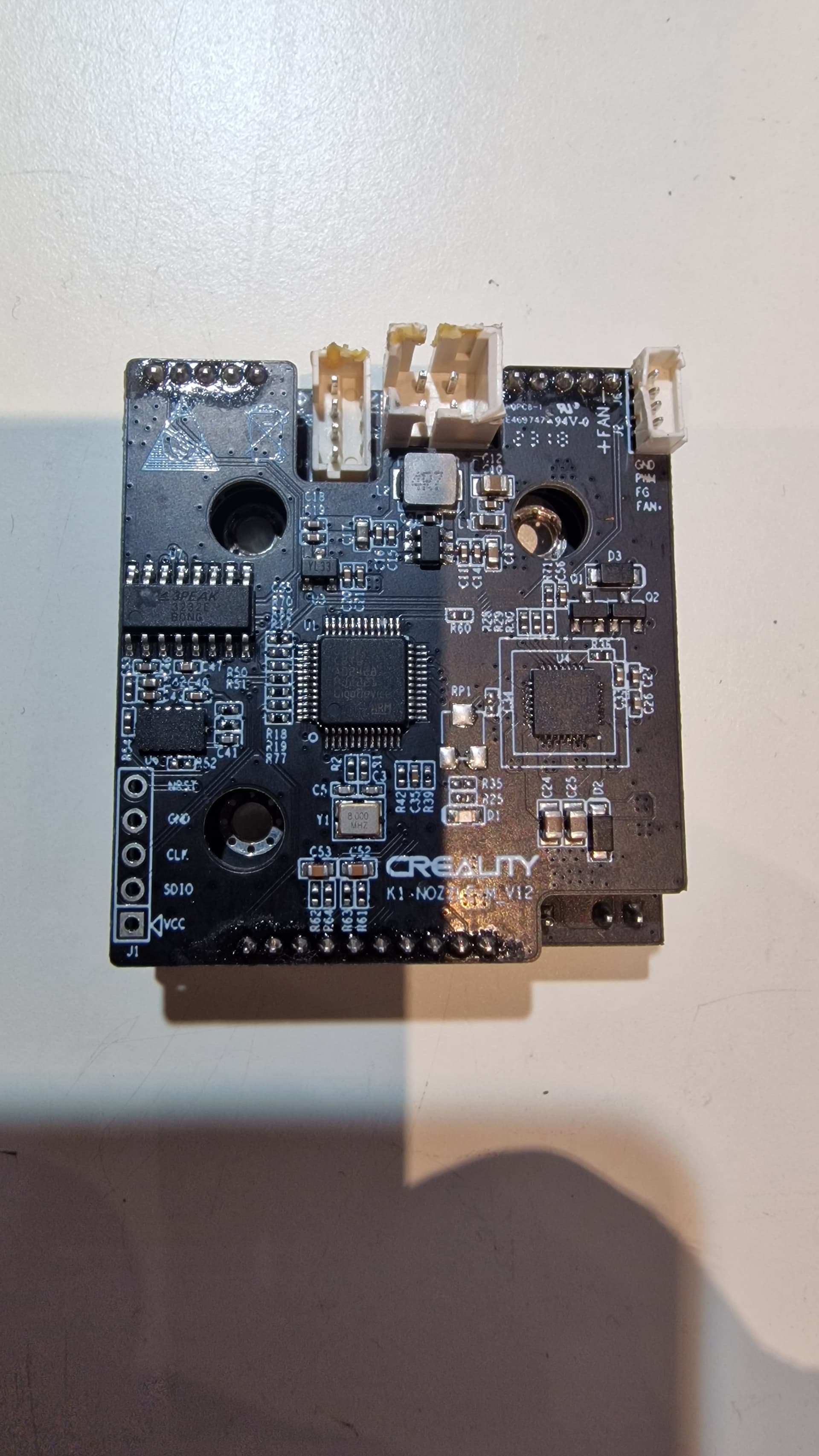

hi my friend, my printer was the same, Creality sent me a new updated PCBA board, I replaced the board and the printer has been working quite well since, I have a Creality K1, you should try to get the PCBA board, that will solve the issues, where are you located?, here is the UK you can get this board from Amazon and also from Aliexpress, it took like 3 weeks for Creality to solve my printer, thanks
Hi there. Thanks for the prompt reply. I am in the UK. I have suspected the board you mention but Creality Support have not taken any notice of me. I read somewhere that there was an updated board. I have ordered a board from Amazon that will be with me on Monday. Looking at the photographs of it, it looks identical to the one I have. I was wondering if my board had a redundant fault that only manifested itself when using the spare port. I have not had a reply from the new email address they sent me. Looking at the spare parts list contained in the WIki this board is not even shown as an available part. I will post an update when I have fitted the new board.
OK, here is an update. I took the advice of RHGM and purchased a new board from Amazon. I fitted the board and the problem was solved. I am now able to carry on with the CFS install and setup.
I positioned the CFS about 1 metre from the printer but the CFS is struggling to load the filament. I am now going to set the CFS closer to shorten the filament run and see how that goes.
I can confirm that the replacement board has an issue with the thermocouple plug fitting. The pin spacings are the same but the socket shroud fixed to the board is different. I was able to remove the shroud from the original board and swap it over.
