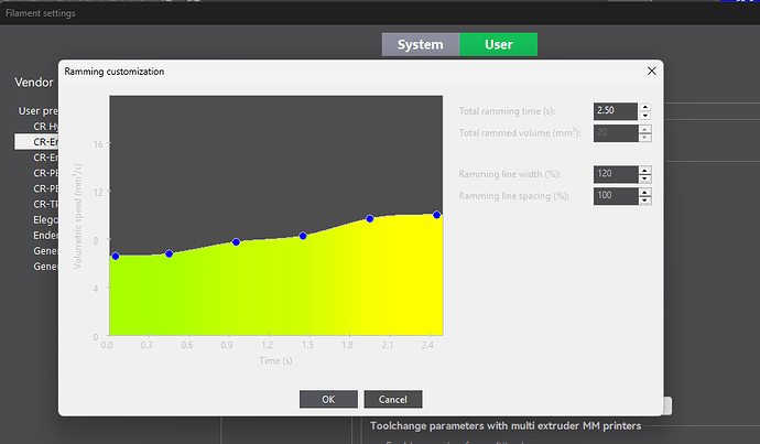

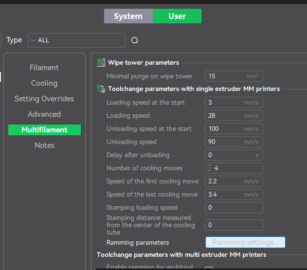

have you looked at the filament ramming advanced settings ?
I’ve not played with that, but I understand its what you are looking for.
Im gonna try this out :saluting_face:
Sadly this did not solve the issue. I think that it has to just be the max volumetric speed that the CFS has hardcoded into it.

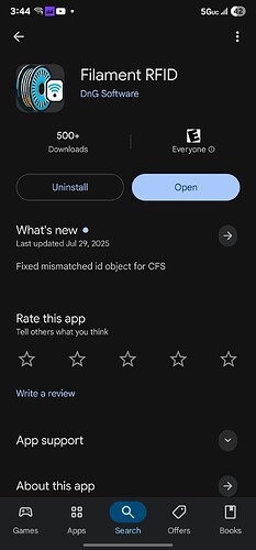

My solution was to download the filament RFID app and through that i was able to update the printers filament database settings. Once i did that, the issue has stopped and its at a regular volumetric flow speed of 8
I don’t see that option in the RFID for CFS (beta) android version, is that a different app than this ?
Tjis is yhe app
That app is far more “polished” than the one I was using :grinning:
