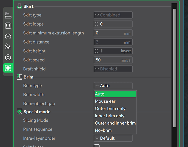

I had a hard time finding Brim size too. you can find it under “other” in the slicer settings:
Note there are several options. I’m guessing Auto (default) isn’t cutting it for you. You can add some width if you need it to reach your supports. I do that for tall skinny things with tree supports, to hold the tree’s up.
Thanks for your reply, the brim width that you’re pointing out only changes the brim width of the part. I specifically wanted to alter the brim width of the support. I can’t seem to find that.

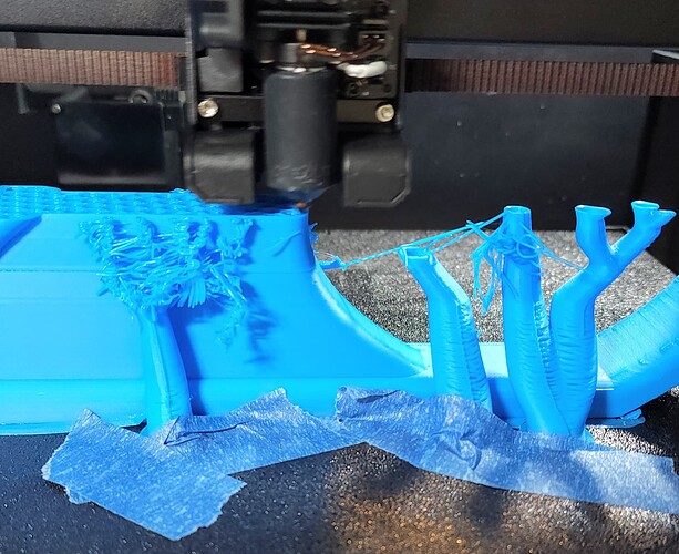

Here is a feeble attempt to add “tape brim” to supports with blue tape. So sad… Where did that setting go!

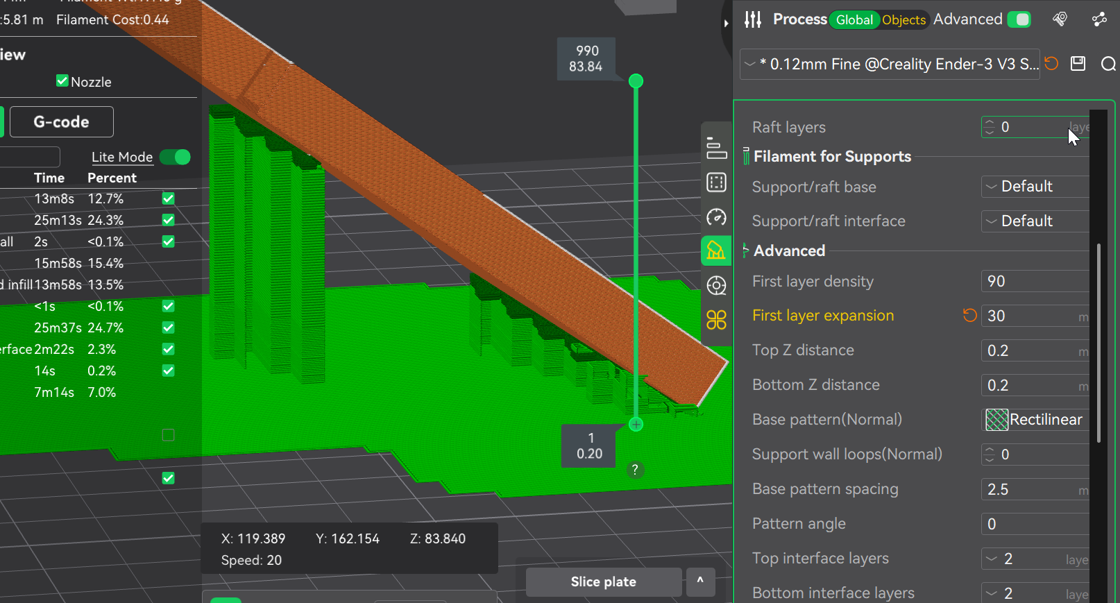

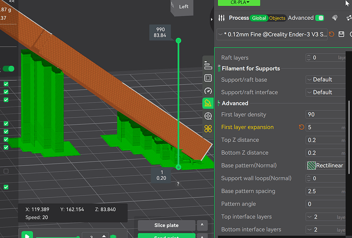

Hi everyone !

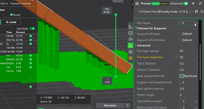

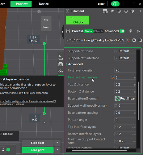

I’m a bit late but i think this is how to change the size on the raft here, you need to check the little box to have the advanced settings.
I was searching how to expand the base of my support and i found this unsolved post. So I hope it will help someone in the future !
@linky_wolfka Exactly what I needed. Thanks a bunch!
Wow, thanks, I had same issues, supports keep failling a lot over and over mid print, I use first layer expansion to 10mm and inical branch diamater 6mm, is beefey
Holy cow Linky, thank you, you have saved me from going insane
thankyou!
