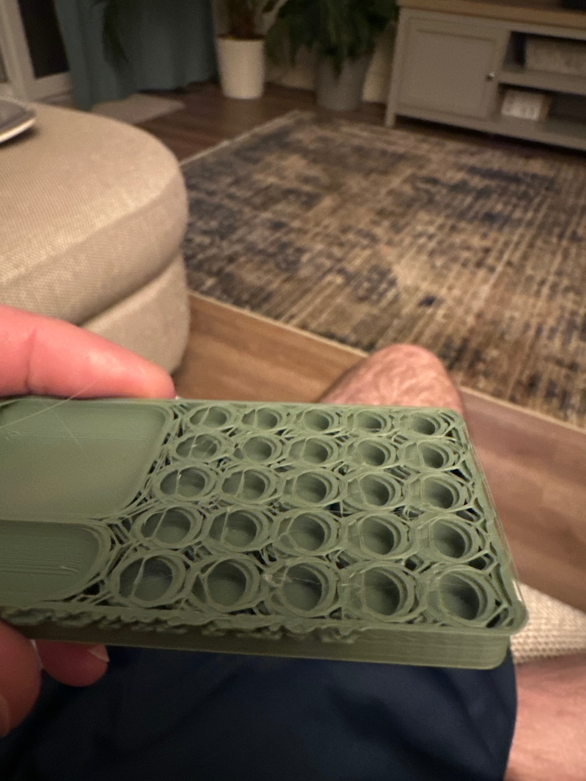

Ok will try that in the meantime any ideas on this
@SASSpud looks like you’re having some layer shift issues here. In the case of the V3 SE, you’d want to look at belt tension if the issue is isolated. But let’s not go there yet. I think instead, let’s get this baby calibrated from scratch (Considering that CP recognised it incorrectly in the first place).

Morning @Alawhie I removed and re-added back to CP and recalibrated the machine (have a Nebula pad on this) and had the same issue but then re printed at 50% speed and both prints came out fine so tried another print and started to get that shift again at at standard speed (100%) do you think it’s a tension issue ??

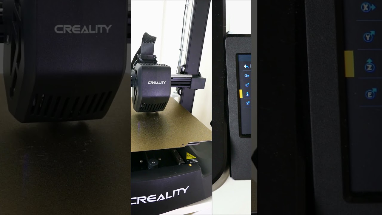

@SASSpud , you’re absolutely correct. Belt tension could be the issue here. But before we do belt tension, check that the firmware is up to date as well.
Here’s a video for that:
And then after we will check belt tension and adjust if necessary:
Run a test print and let me know if we’re good or if we’ll have to look into this a little more :slightly_smiling_face:
