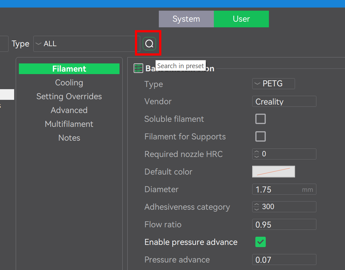

The second tool is the OrcaSlicer search feature built into Creality Print.
Click the magnifying glass to open the search window. This search feature is included throughout the settings profiles. As you type, a list of matching keywords and settings will begin to populate.
Once you locate the field you are looking for, hover over it. A popup will provide a brief description, which you can then use to search the OrcaSlicer Wiki if you want a more detailed explanation.
