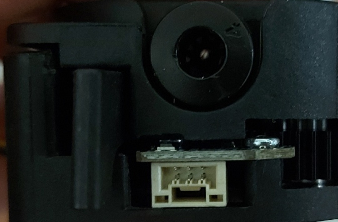

Connector name
Hello dear community members! Please tell me what the name of this connector is? Perhaps someone knows its exact name, thank you!

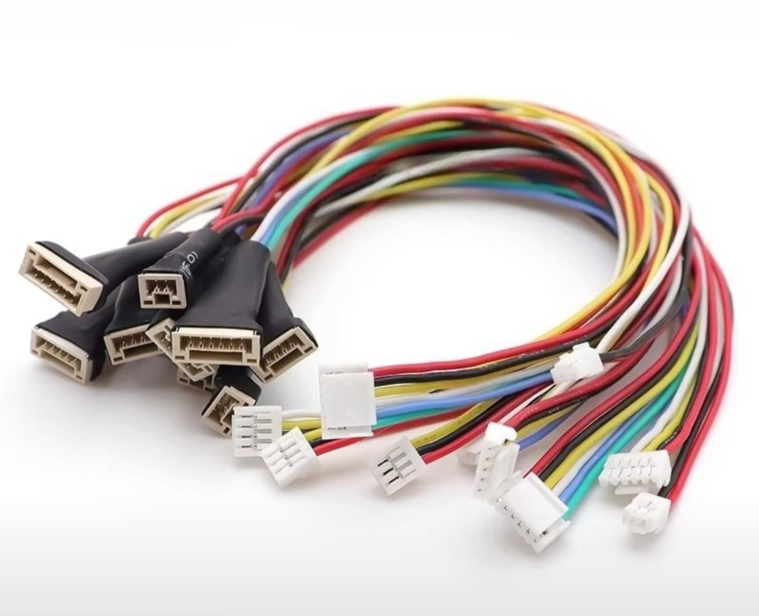

What @JoeFriday said if you are talking about that white PTFE tube thingy.
If you mean the electrical connector like in the second picture than it could be a JST-style wire-to-board connector like a JST-XH, 2.5 mm 3 pin.
It’s settled!!! Thank you, I found a connector on the trading floor for a hint. Jst- gh 1.25 Thank you all for your help!!!
