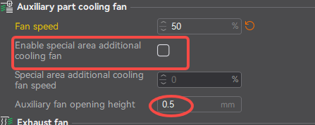

After the print test, the setting of the auxiliary fan was effective. It turned on the fan after specifying the Z height,you can first confirm the firmware version of your machine or check if there are any issues with the auxiliary fan’s wiring

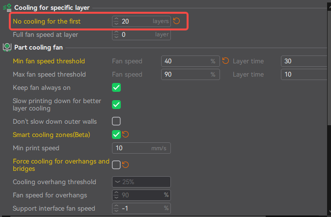

Still trouble with the fans, it’s the model fan and the side fan. Both don’t turn on reliable when no cooling for 24 layers is set. Don’t know what I can do? You mentioned check the wireing. Can you tell me which wires should be checked?
According to the 3MF documents you provided,you have configured the first 20 layers to have fans remain turned off. Consequently, all fans on these layers will remain inactive.
When you turn on the auxiliary fan, please check here. at what height should the fan be set
I think it has something to do with the calculation of the layer height when ‘variable layer height’ is used to prepare the model in CP6. Also ‘independent support layer height’ might influence the calculation.
As an example I used ‘no cooling for 24 Layers’ and in the preview the 24th Layer has a Z-value of 2.8mm. In the G-Code
M106 P2 S76
;LAYER_CHANGE
;Z:5.14141
;HEIGHT 0.202918
So when you calculate 5.1414 / 0,2 = 25 Layer. The calculation is based on a layer height of 0,2mm. But it doesn’t match the values of the preview.
Please fix this so that for the last layer a user wants to have for no cooling the number can be taken from the preview and then can be set in the filament settings for no cooling. Or maybe you can make a calculation in the filament settings when a user entered a number of layers, and say this means layer x layerheight. Then the z-Value can be compared with the preview.
