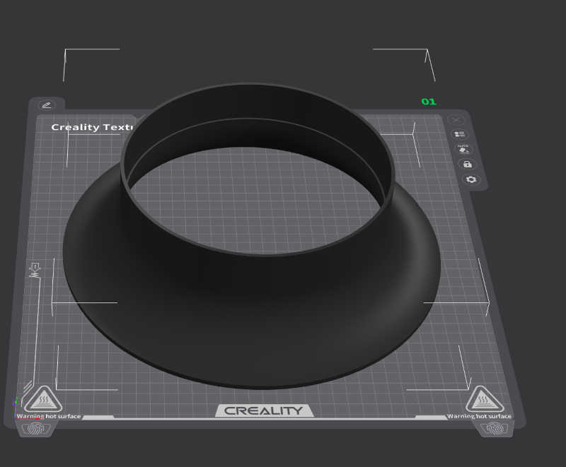

Hi. Finished building this V3+ a few days ago and tried a benchy. It wasn’t perfect but it wasn’t slow either. I mean, I’ve not seen a printer move so fast. Due to personal reasons I am not back on it til today.
Made my own model from scratch so thought I would see how it slices. It has a curved up footprint all round so the slicer wasn’t happy and wanted supports. Enabled them and it gets stuck slicing at 65%
== maybe irrelevantly, I noted my slicer was set to hyper pla - i dont remember seeing that on the benchy which I did slice before i printed. the text on the foot of benchy was unreadable. anyway ==
A quick search showed others had the problem so followed a suggestion to try orca. Sliced fine but takes 2.5 hours longer to print. So I went back to CP6 and changed auto tree to auto normal and it sliced.

After using version 5.1.7xx for some time, I found that it froze at 15% on a complex slice. Tried same file/same settings on another computer with the same result.
After testing it with Orca and it worked well, I tried it with Creality Print 5.1.6xxx and it sliced ok.
So now I am back to 5.1.6xx and I have no troubles.
I will NOT use version 6 as it has too many flaws.
Cheers.

Old thread I know but it felt like CP 5.1.7 was hanging while slicing this print. It would sit on 65% for ages till I gave up.
I tried a few things and eventually I just let it sit on 65% and after bout an hour it finished. Computer in no slouch (MacBook M4 Max with 64GB of RAM) so I’m wondering why.
FWIW this is a 200mm air scoop (Bell mouth hood) which I am setting up in front of a charcoal filter fan unit to keep VOCs down in my print room.
