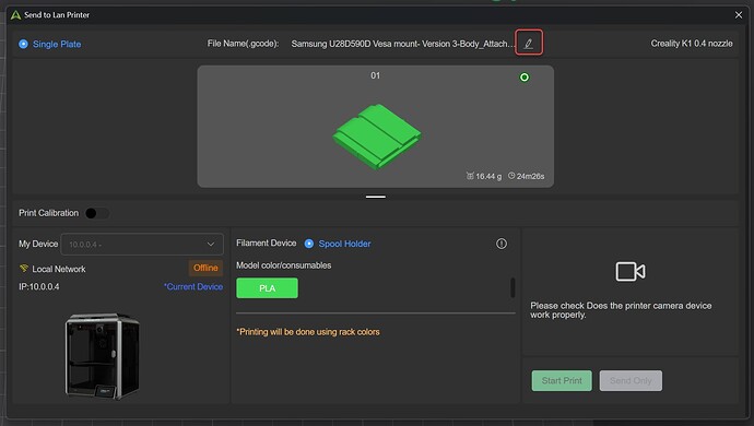

CP 60.0.1078- Cannot send model to printer- Error
This is the first time this has happened since updating to CP6, I am trying to send the model to the K1 printer and I keep getting this asian error message and I don’t know what it means and why the model is not printing. The printer is online and ready.
Running on Windows 11.
Using WiFi connectivity.
Printer responds via its IP- I can see the printer GUI via the browser.
I had to save the project to USB and copy it to the printer this way in order to get it to print.
I took a screenshot, zoomed in to the Chinese message and let Google Lens loose on it. I get the following translation:
● The file name is too long [cannot exceed 80 characters]
Can someone explain why you get Chinese error messages if you have the English language selected?

That’s worrying. I was hoping the application would format the out-going filename to suit.
The error is now fixed in 6.0.1.1375. It shows in English!
But how did u manage it so fix the error “The file name is too long [cannot exceed 80 characters]”?
I just can’t fix it in any way n the name of my file ofc does’t exceed that. What I could do?
When the “Send To Printer” dialog opens and the error displays, there is a pen next to the name of the file. Click this and reduce the number of characters in the file.
