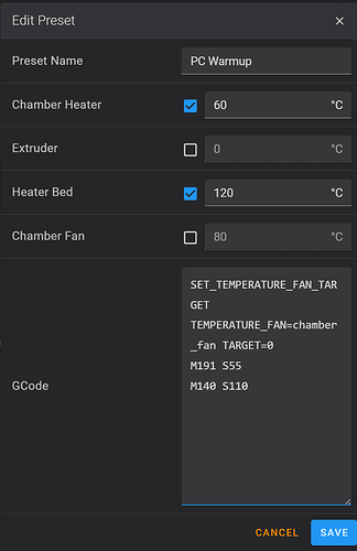

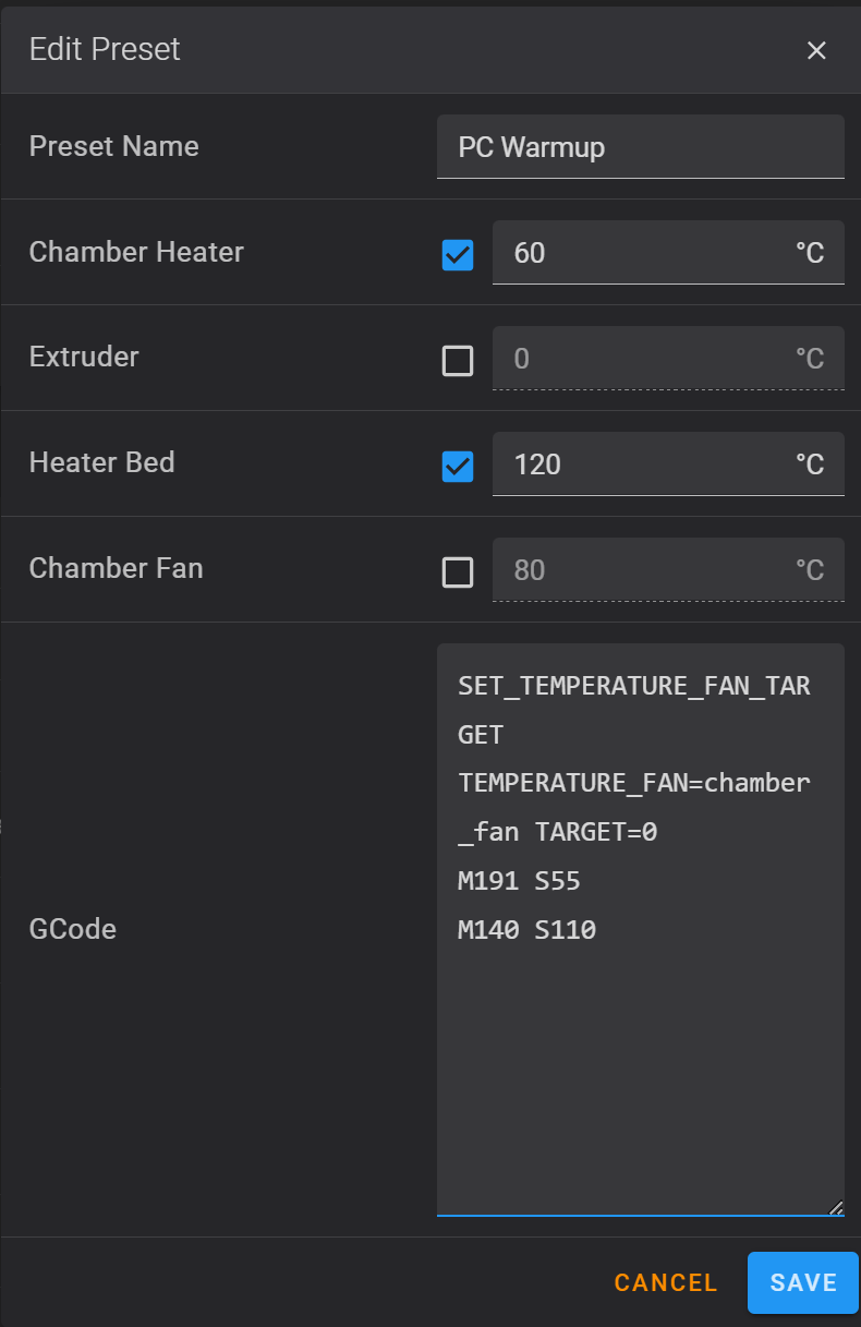

fluidd has Thermal Presets that allow some G-Code. For my PC Warmup routine, I set the chamber temp to 60 and bed to 120.
SET_TEMPERATURE_FAN_TARGET TEMPERATURE_FAN=chamber_fan TARGET=0
M191 S55
M190 R110
The Chamber temp probably doesn’t need to be set, since the G-Code takes care of that. I took the first one from the console. The preset won’t accept 0 as a preset and it won’t do anything if it’s not selected.
M191 S55 sets the chamber heater to 55, and waits for it to reach it. The bed is cranked to the max while it waits. Once the chamber hits 55 (or whatever you set yours to) M190 R110 makes it wait for the bed to cool down to 110.
On these set and wait commands, S before the temp means it waits for it to heat up to temperature but it doesn’t wait if it’s already above the temperature. R before the temp makes it wait to cool or heat.

The image and code I used are Fluidd “Thermal Presets.” I use them for preheating/heat-soaking. I just recently started using the custom code part, using PC filament that needs a high chamber temp. That’s how I got here on this forum.

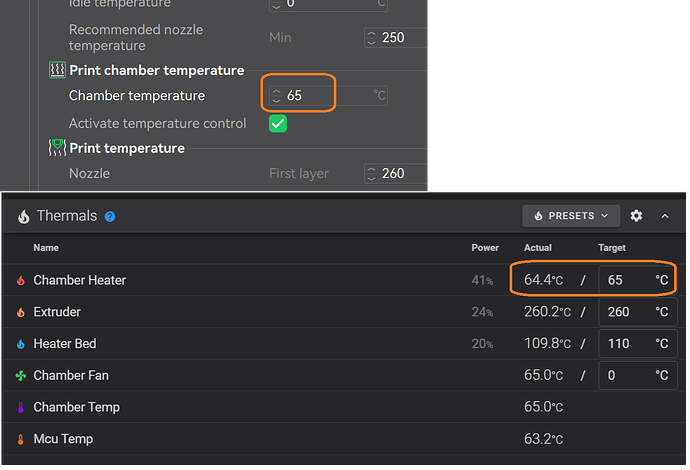

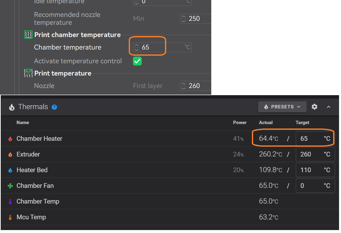

I put 65 in the filament profile and it ran with it. I’m pretty sure I also entered it in Fluidd, before I found out 60 was the max spec.

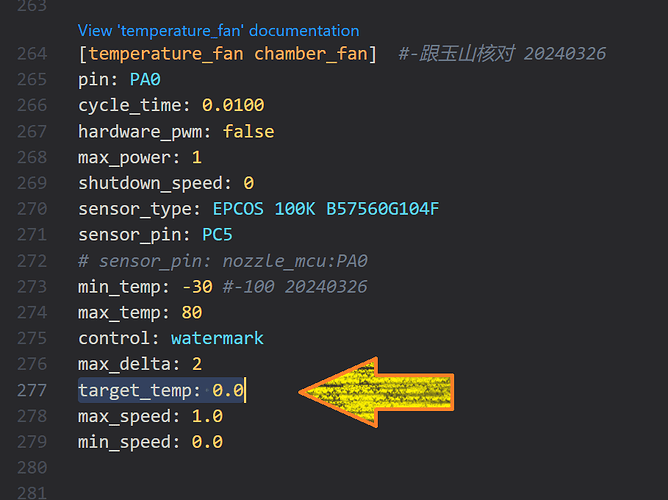

If you edit the config file using fluidd, it won’t default to cooling it to 35 when it’s first started. Unfortunately, CP6 G-Code will set it to 35 when it’s finished no matter what.

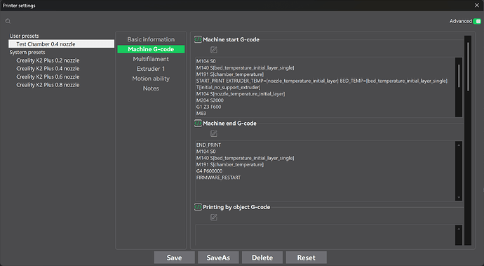

The filament custom G-Code does not add the custom code at the beginning, but it does add it at the end. If you go that route, be sure to start it with “END_PRINT” or set the hot end to 0 and park it or it will sit there and melt your print the whole time you let it cook.
The Printer Settings do run the beginning code, but it still runs after the auto leveling. I am going to stick with the Thermal Presets or manual code entry for preheating and heat soaking.
If you set the config file parameter above, and just nuke the whole thing with “FIRMWARE_RESET” it will restart without chamber cooling, but it will retain emergency cooling. If you nuke it with “M112” it will emergency stop with protections. Both will prevent time lapse from saving. Maybe there’s a code for that.
