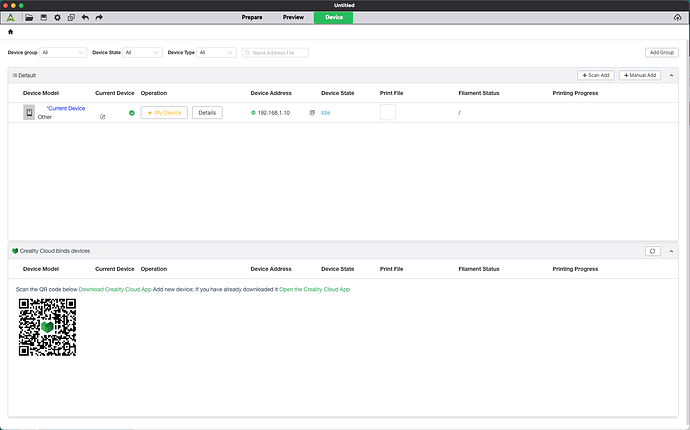

Scan Add doesn’t see my printer either. Manual Add does not see it by typing IP address in the Creality tab.
I add it by typing my IP address in the Other tab.

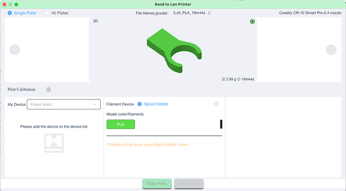

But when I send print, I can’t select the printer in the My Devices drop-down menu. Therefore, I can’t send pressure.
What am I missing or doing wrong?
