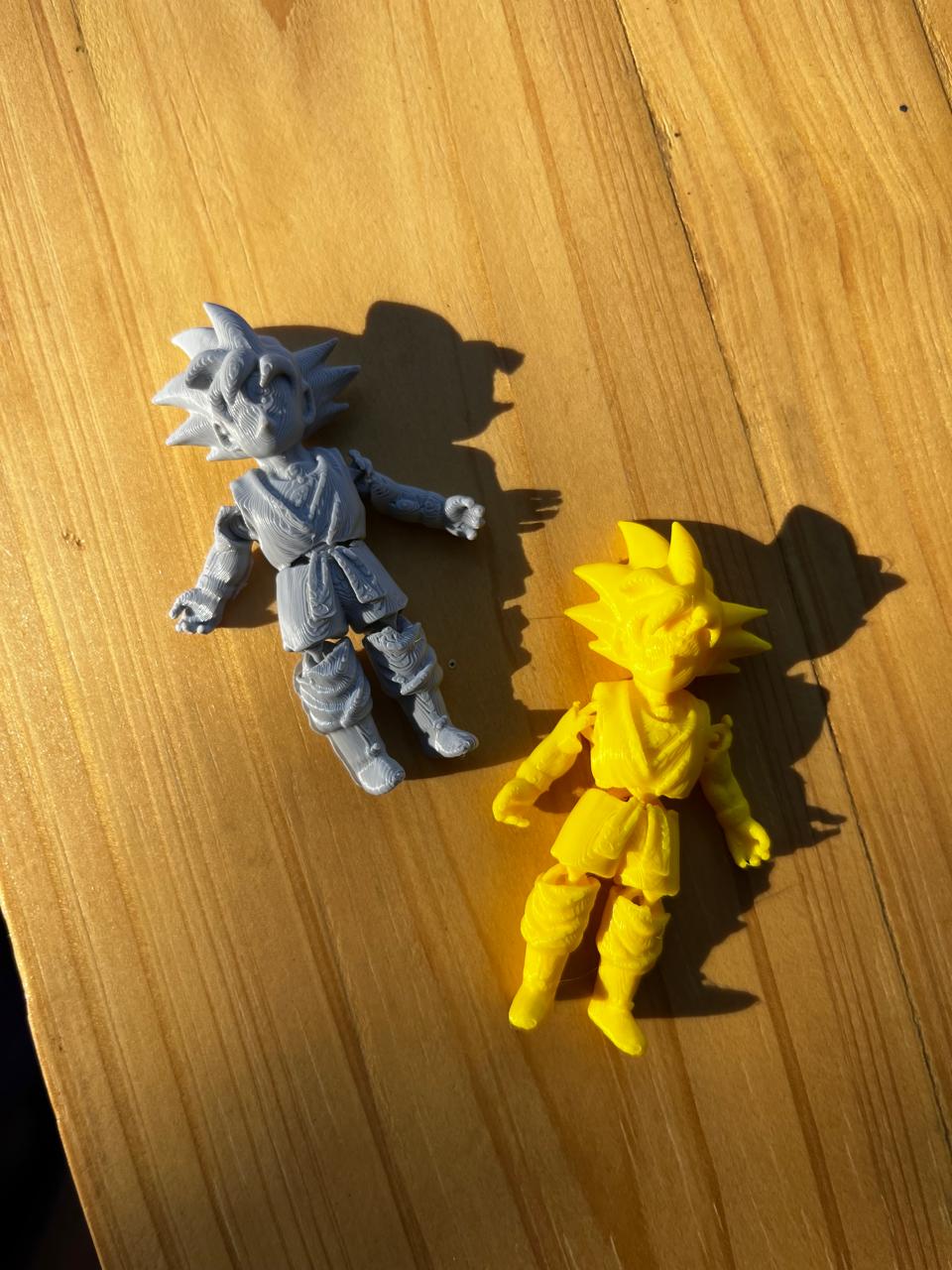

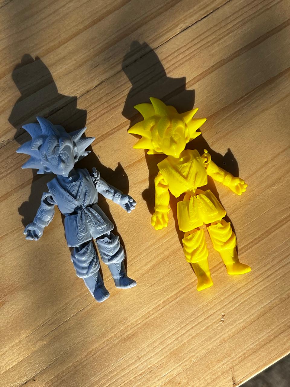

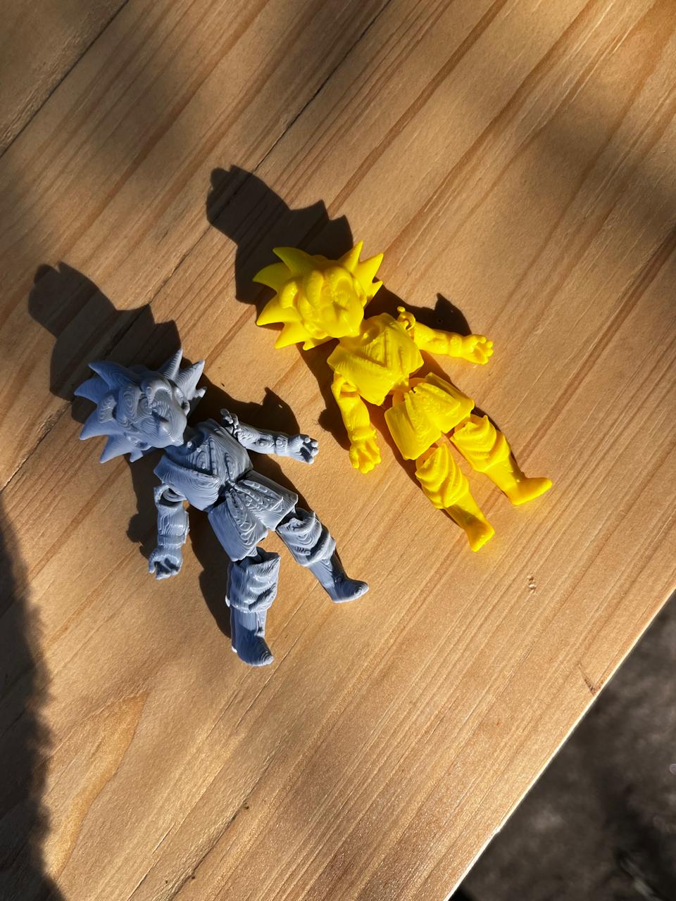

This is my first attempt at an articulated/flexi action figure design..(for the love of DBZ)
Design Concept
The Goku Flexi Toy v1 is designed to capture the iconic Goku character in a playful and flexible format, allowing for posing and movement. The use of vibrant colors adds visual appeal to the model.
Uses This figure is perfect for fans of anime and toy collectors. It can be used as a decorative piece or for interactive play, making it versatile in its appeal.
Printing Suggestions To achieve the best quality, use fine layers and a filament with strong tensile strength to ensure flexibility in the joints.
Assembly Instructions No assembly required; the model is printed as a single piece with moving parts. However, care should be taken during removal from the print bed to avoid any damage, particularly to the joint sections.
LAYER HEIGHT ; 0,16MM
2 WALLS
10% INFILL
GRID OR GYROID INFILL PATTERN
HILBERT CURVE BOTTOM LAYER (for aesthetics)
5 Top layers (shells)
4 bottom layers
ironing turned off but support ironing can be done for better suface finish.
ran printer at standard speed.
supports baked into one model and one model was edited more to have better adhesion and print with no supports.
