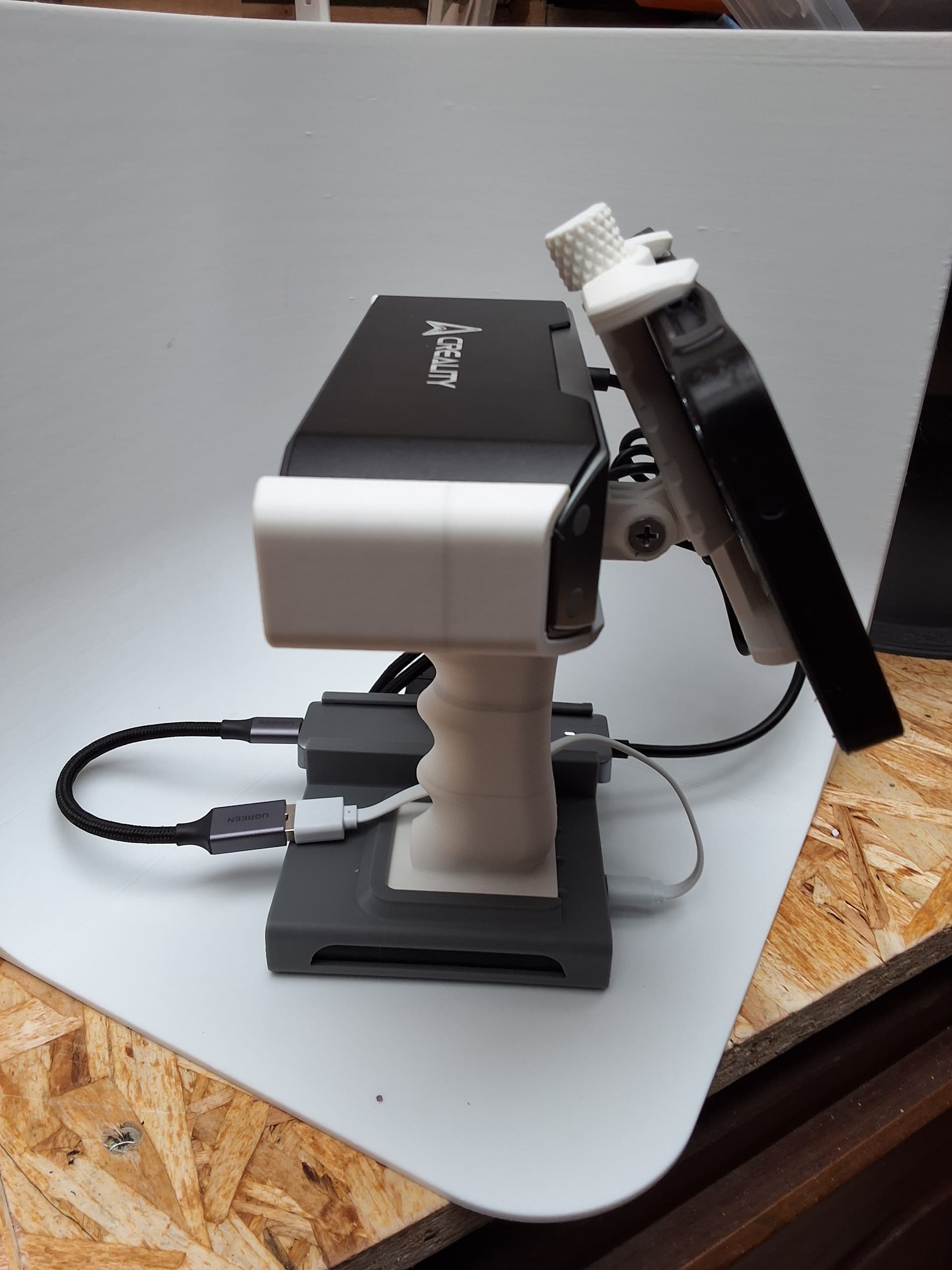

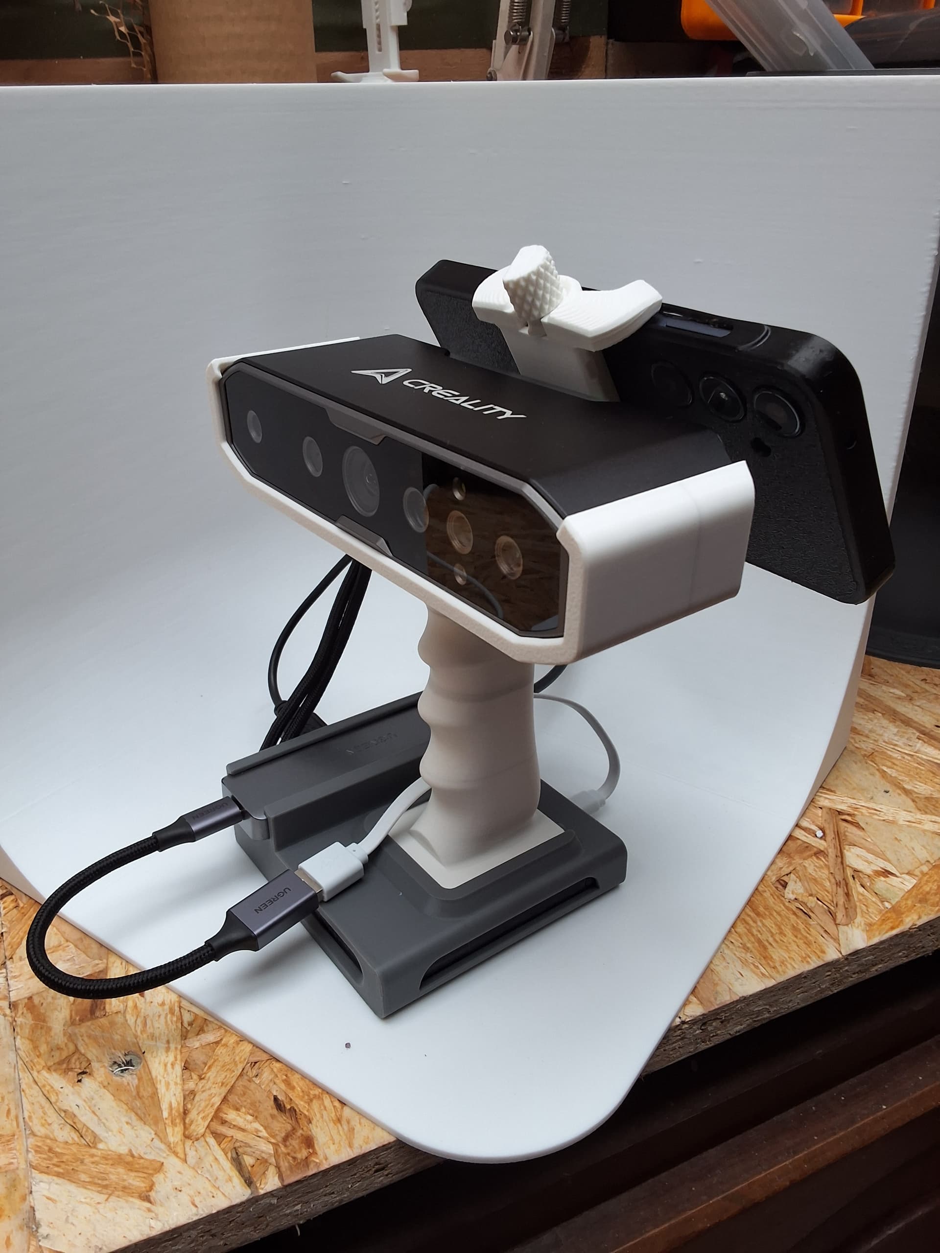

I present my latest addition to mobile 3d Scanning mount systems. This design is for the Creality CR Scan Otter. The Cr Scan Otter is securely mounted in the customs design cradle, that, is in turn secured in place with snap pins into the main handle of the design. Below I have listed the additional hardware I used (I already had them at hand from other projects).
ITEMS NEEDED
Juice ECO 2 battery: https://www.juice.co.uk/products/juice-eco-2-charge-power-bank-5000mah
1 No. 6mm Nut and Bolt.

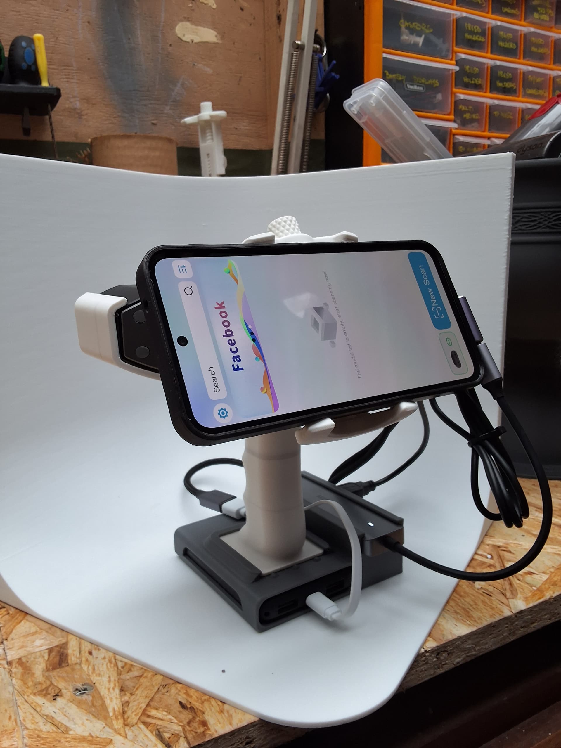

ANDROID APP REQUIREMENTS
This system will only work with 2.2.6 of the Creality Scan app for android. I have not tested with apple devices - as I think they are the spawn of Satan himself.

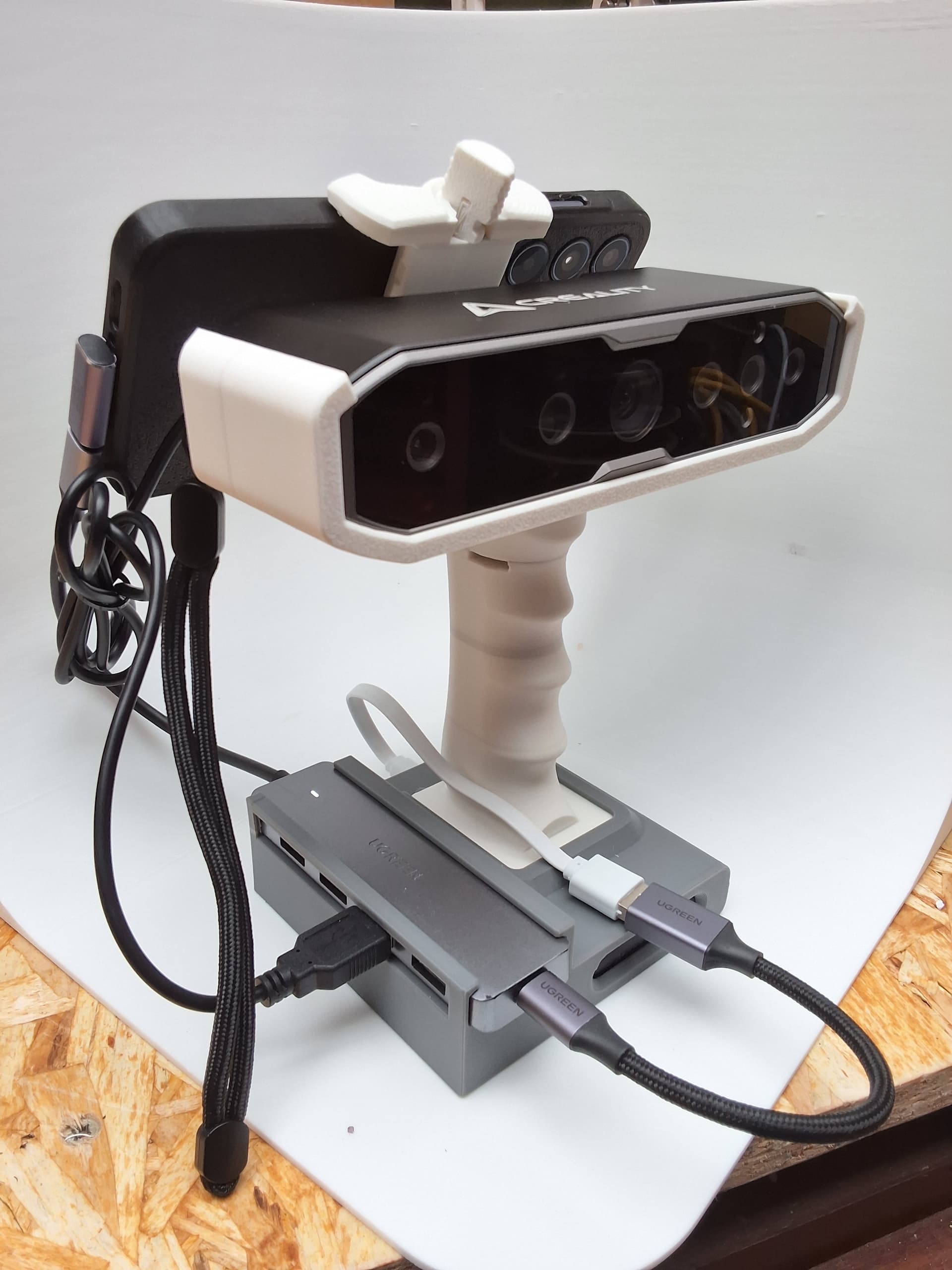

You can see from the attached photos that I have also used some random USB C cables to connect everything together, the cable management could be a lot neater, but I was willing to use what cables I had at hand without buying more.
In the print profile I have included PETG as support interface material, this ensures clean overhangs and minimises fitment issues. This is printed in SUNLU PLA, but feel free to use what ever material you see fit.
