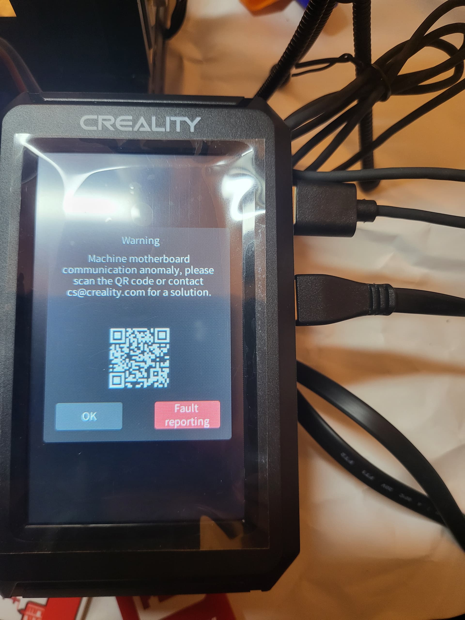

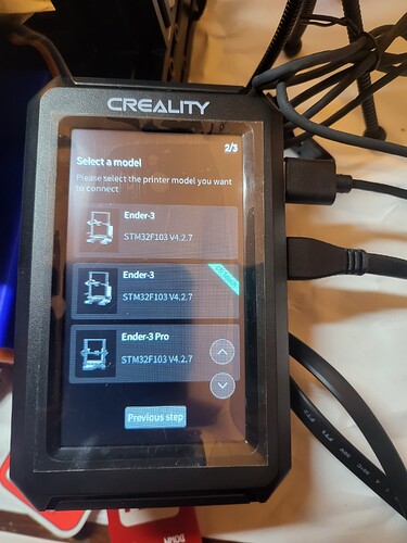

Hello, this is off the topic but i wanted to know which option you chose as the model to set up the Nebula Pad? I dont see a Neo option. I chose Ender 3 with CR Touch but got the error in the picture. I did update to the same firmware as you did.
Thanks you your assistance.
