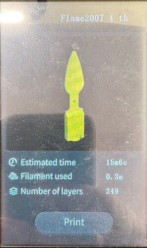

The initial Print screen for selecting a file from the SD card now shows a graphic of a small figure together with lines for print details such as print time etc. Unfortunately, neither the figure changes or print details are provided, when or after selecting a file to print.

My guess is that you are using Creality Pront 5 or possibly 6 if you can actually get it to function. I have an Ender S1 that everything was working and all the model previews and thumbnails were on the screen every time. Mid way through the Creality print 5.0 versions one evening poof nothing was showing up. Just the little Creality guy and blank readouts for all the model usage specs. No firmware or software updates were installed. Tried anything and everything I could think of but no changes. So I tried Cura ultimaker that I was using before 5.0 was released and magically everything showed up. Still after all the software updates I still have the empty preview screen. I have not used Creality 6.0 yet because the Mac program won’t let users login to Creality Cloud to access previous machine information and settings. The printer still prints models and functions like usual but no preview information available.
Many thanks for your response. I have been using Cura 5.4 for slicing and loading the gcode on to an SD card and loading / printing from that. Have read about the problems with Creality Print, and dont want to complicate matters further by using it. Am I right in understanding that the model preview and print details screen works for you when using Cura? In which case what rev. are you using, and are you controlling your printer direct from your computer or with an SD card? Many thanks again.

Many thanks for your response Bill. Unfortunately the Cura generated thumbnails don’t show on the printer screen.

I have the same printer and had the same problem and solved it with a plugin for Cura… works very well! (see link below)
https://www.3dprintforum.eu/viewtopic.php?p=4619#p4619
Many thanks for your reply.
I had seen that link and have been waiting 1 week now for my ultimaker account to be approved so that I can download it.
Many thanks Vink for providing plugin link as a text file. Took a bit of head scratching before i realised that the filename had to be the same as specified within the file. Now the thumbnail is working.
