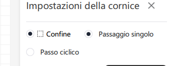

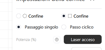

Hi.
I see that in Falcon Design Space the only option of outline preview for Falcon 10w is the square, not the exact perimeter.
and not this:
Is it a bug? or is it limited per model?
Again, even if I connect an external camera, the software does not let me calibrate.
Again, a bug or a limitation?
I think this is a limitation of the software, with Lightburn you could do both on the Falcon 10W (the open frame, not A1 10W). Maybe they add it if you send feedback that you would like to have these features for the other machines as well.
