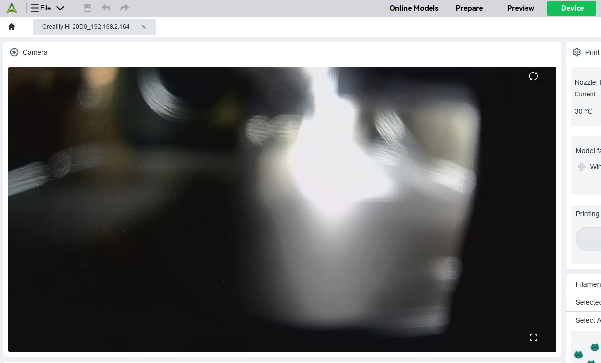

I just bought a brand new Creality HI - the integrated camera is awful. I initially thought it had a piece of protective film on it, but that is not the case. Are there any adjustments to get the camera focused?
Please see attached photo:
Thank you for any tips!

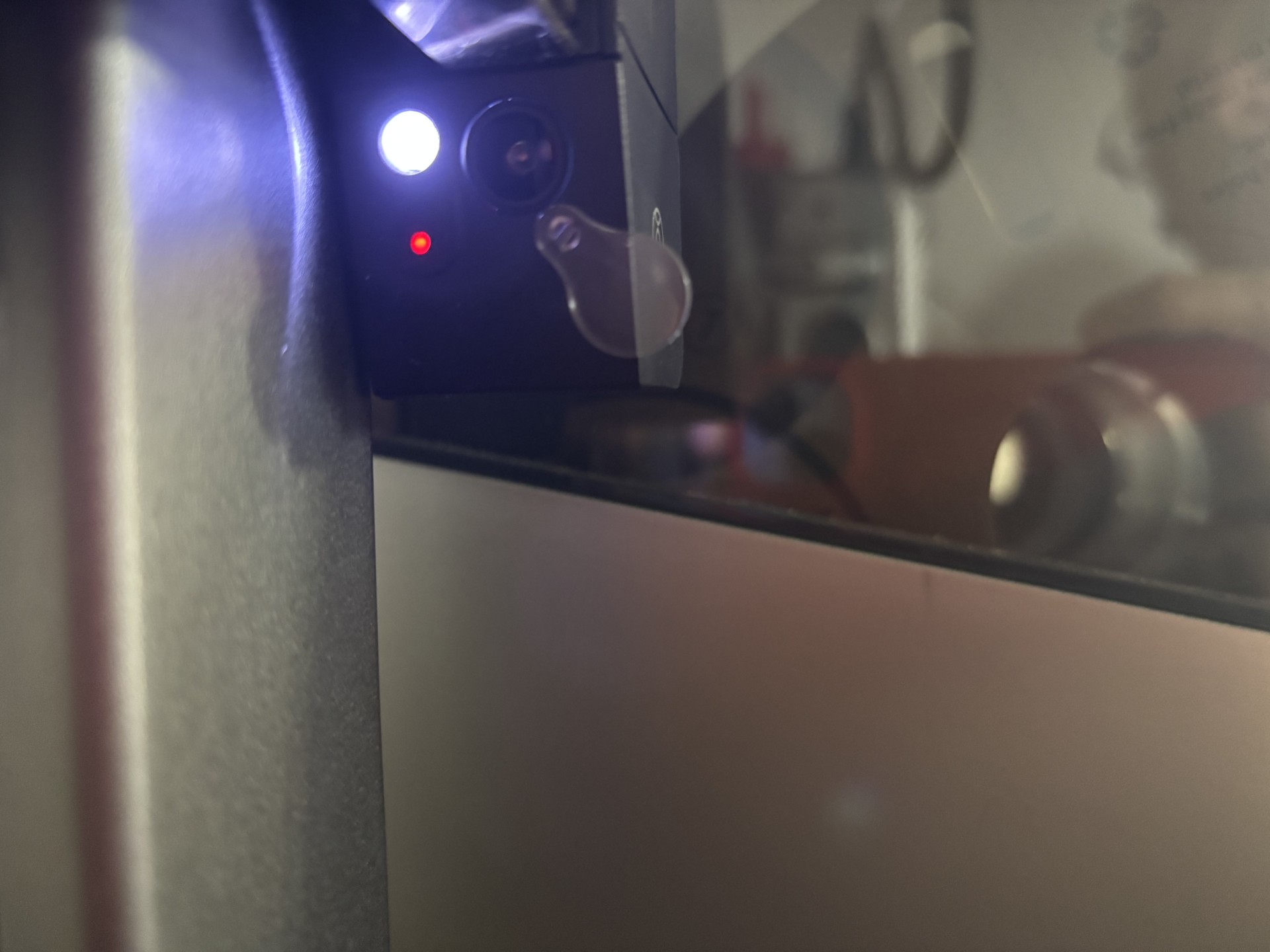

I had exactly the same problem with mine.
It is not protective film. There is a frosted lens cover (privacy cover) that has to be moved out of the way.
Thanks, it wasnt that - I moved it out of the way.
thats not the way the lens cover must be, it can damage your printer, the cover must NOT be outside the camera casing, you must put all the way down

Yeah the issue is not solved . I did completely disassemble the camera and removed the lense and cover. That actually allowed a somewhat viewable image. I probably should have reached out to creality for a replacement but in my efforts clearly voided the warranty. I ordered a new one from AliExpress .
This is in fact resolved I suppose. I was shipped a garbage camera, broke it on my own, and ordered a replacement. It was 16$
