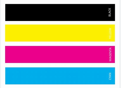

It really depends on how the colors on each layer are oriented.
For example if you have a cube with horizontal stripes going along the x/y axis:
You will have 4 color changes.

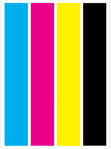

If you have a cube with stripes going vertical like this:
You will have 4 color changes on each layer X the number of layers on the model which can add up quickly.
yeah I learned that the hard way, after 12 hours of print a model and only the first 4 cms of if printed, ended printing the model on one color and then paint it with markers.
