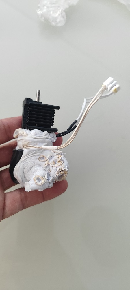

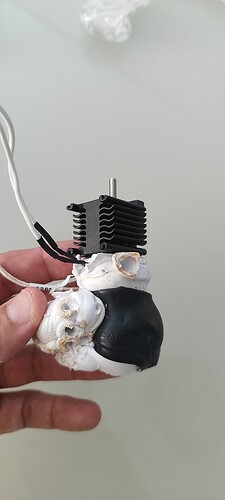

I woke up about 40 minutes later, and the printer was making a noise, which is what woke me up, a fright.
Well, I’ll leave the photo for you to see, and now I’ve dismantled it and I’m looking for parts to replace it, because the extruder chip cable has also been damaged.

The cable from the circuit board in the right-hand cable has broken, I need a new board and the cable.
It appears you have suffered from heat creep. If you google “hot end heat creep” you will get an explanation of the causes. Possible reasons : temperature too high, hot end fan not working.
You will need to contact the store where you purchased the printer and ask for there assistance as you should be covered by warranty.
Sorry you had such a traumatic introduction to 3D printing hopefully things will get better for you.
You might also google “How to check if hot end fan is running on Creality Hi Combo”
Unfortunately your main concern at the moment is replacing the damaged components :frowning_face:
This “blob of death” can also be caused by a nozzle that is not fully tightened. Perhaps the nozzle was not properly installed at the factory or it came loose in shipping. It’s always a good idea to check and make sure the nozzle, all the screws, and the belts are properly tightened on a new printer after setting it up and recheck every once and a while.

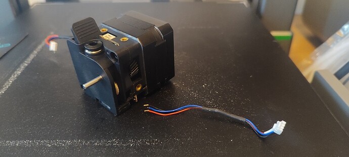

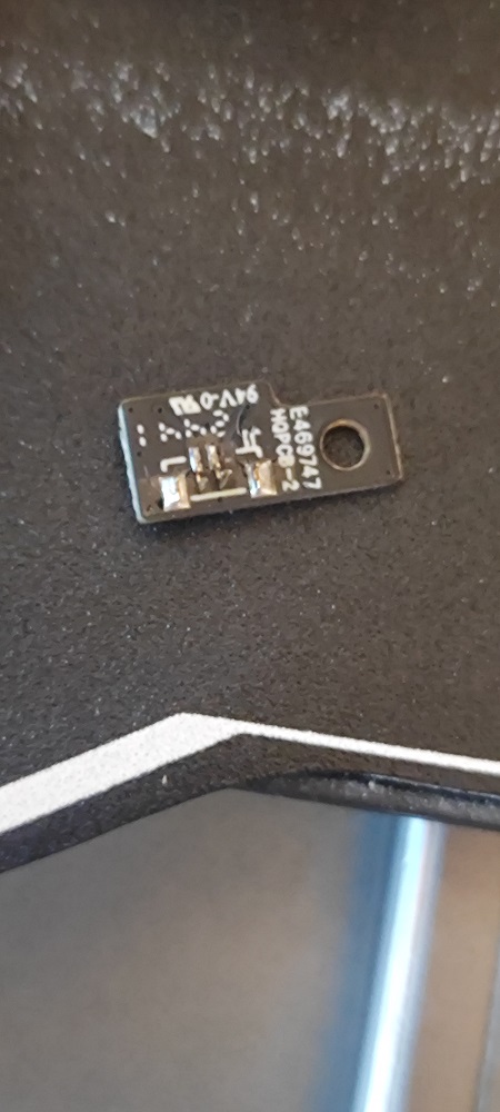

Hello friends, can anyone tell me the type of connector for this cable and board? I haven’t received a satisfactory response from Creality yet. They sent me a new extruder and a new board, but without the cable.
did you ever get a source for this cable? I have had two of these small connection fail.
