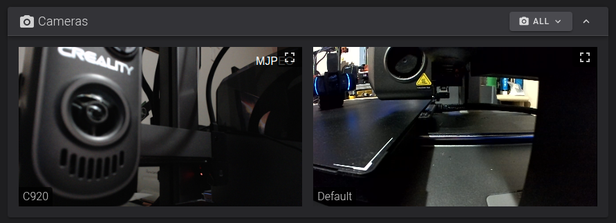

I am facing the exact same issue with my Creality Hi. It detects the external USB camera, but I cannot use it for timelapses or get a reliable stream in Fluidd, as the system defaults to the internal one. Additionally, the original built-in camera has a very poor angle and low image quality, which makes it nearly useless for monitoring prints. It is very frustrating to have to choose between a better camera angle and the built-in LED functionality. We really need an option in the printer’s menu to select the preferred camera source. Please add this feature

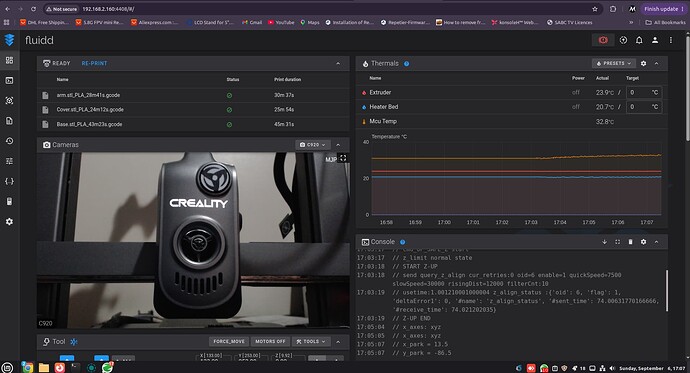

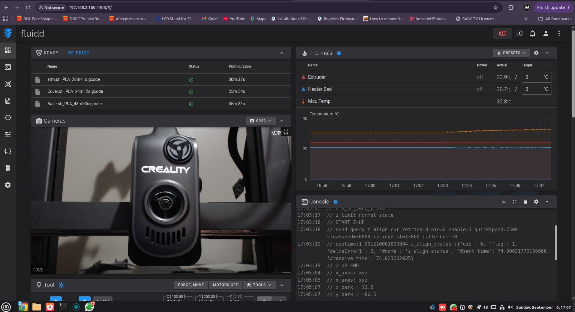

Part success!! Logitech C920 USB camera works in Fluidd on the Creality Hi.
Now to test the timelapse functionality. We’re getting there!!
