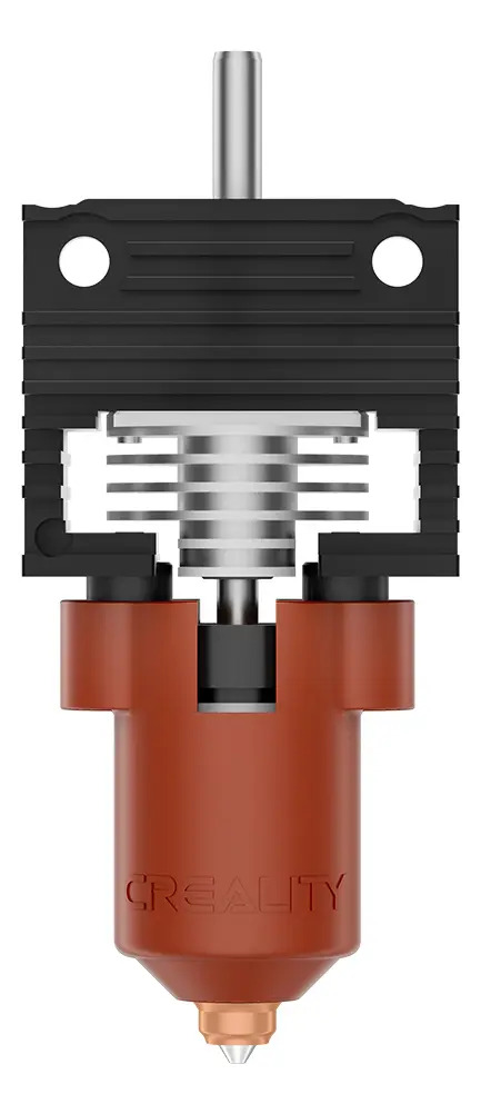

Hi. I have the same problem here. Can’t finish a print. PLA, PETG, ABS, with and without top cover open.
K1 Max. Replaced the extruder with motor, printing head boards, two nozzles, then the unicorn and cutter upgrade for CFS, then another nozzle.
When it stops printing i can hear the step motor skipping steps and when I remove the filament, i can notice a wider diameter of it on the tip, like it melted.
It seems to happen after a series of short extrusions and movements.
Printer is useless now. Never finishes a print.

Finally solved the problem by replacing again the hot end kit by one of this.
