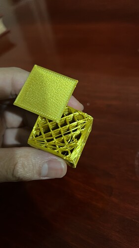

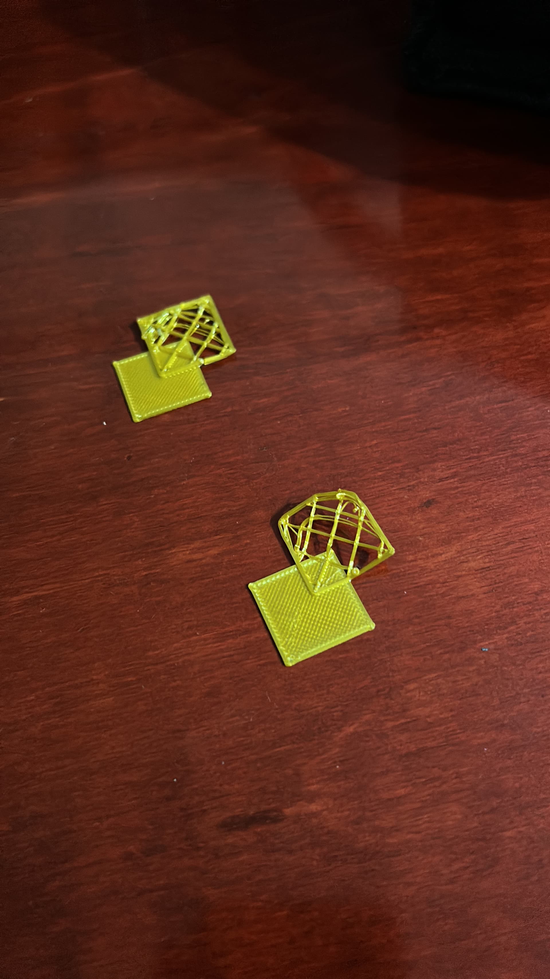

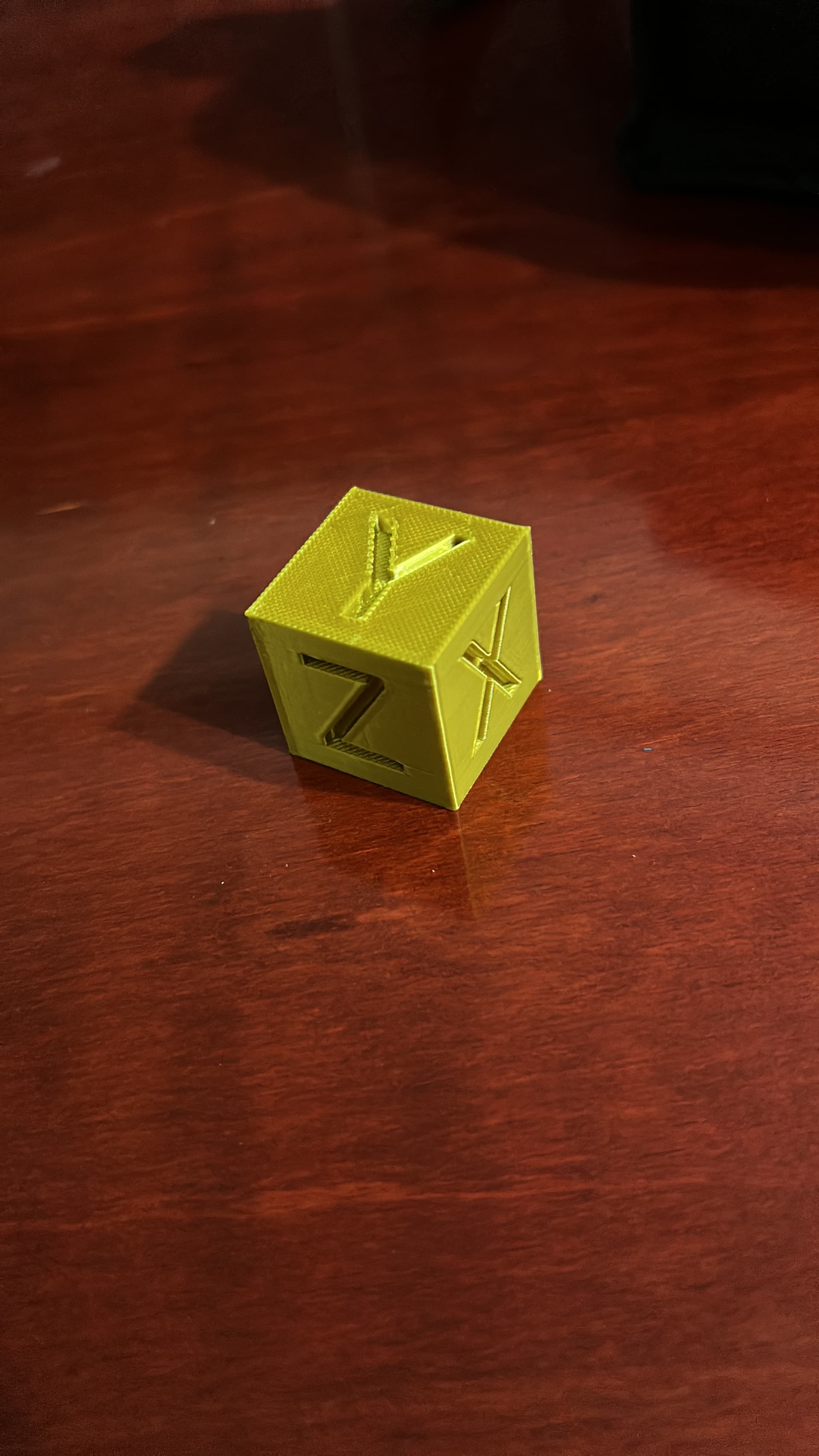

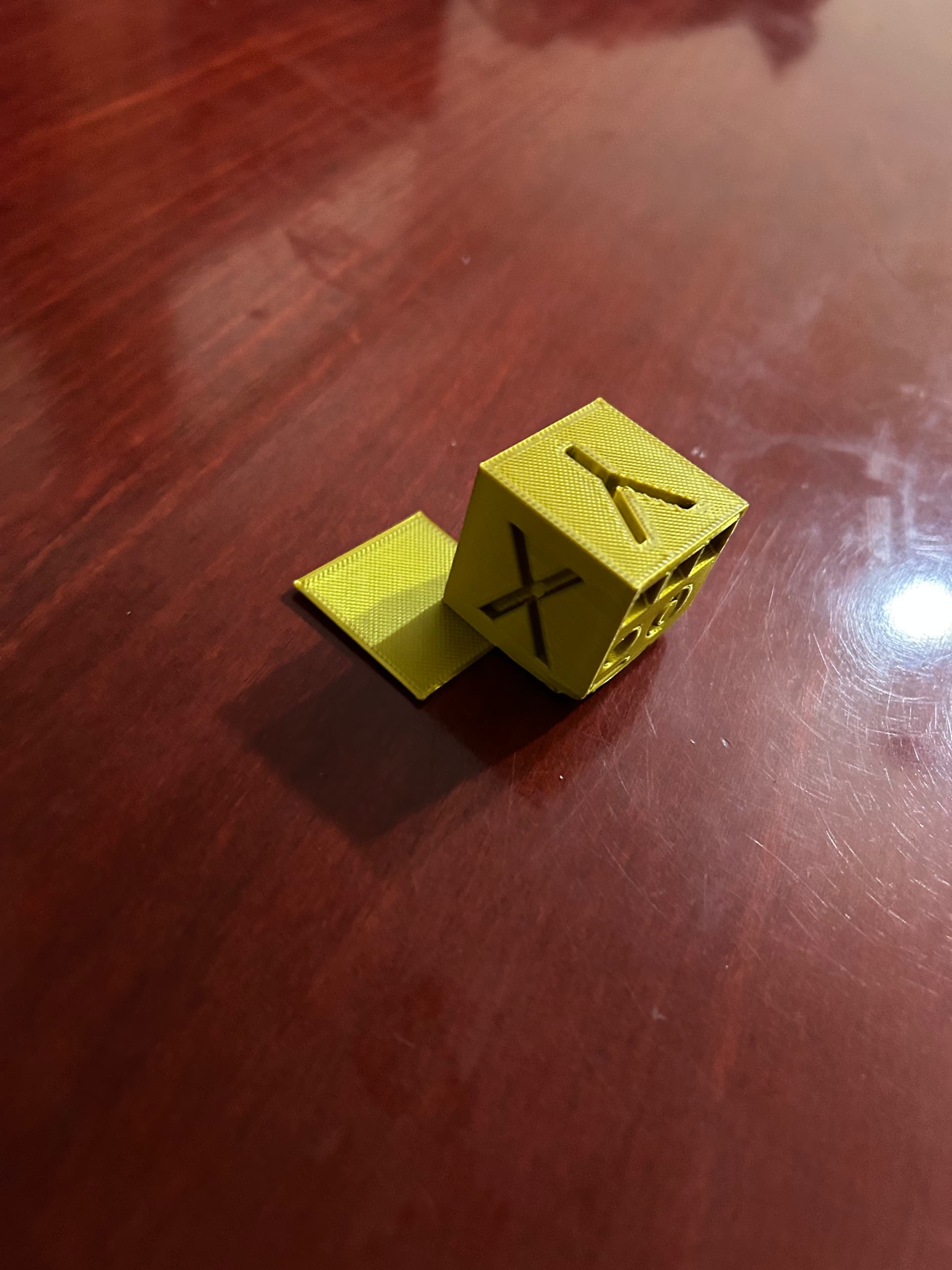

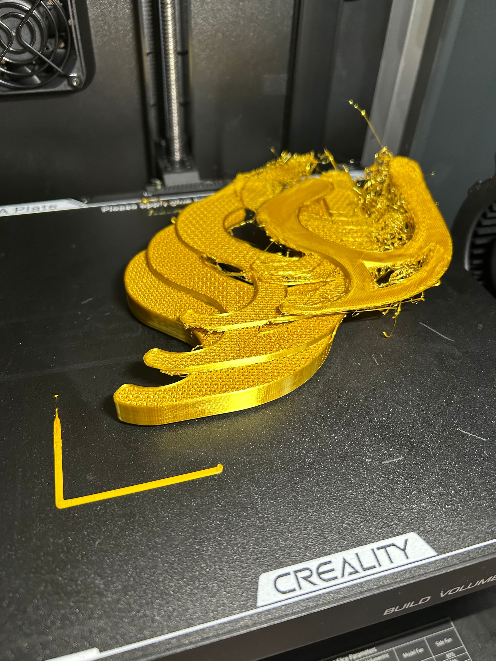

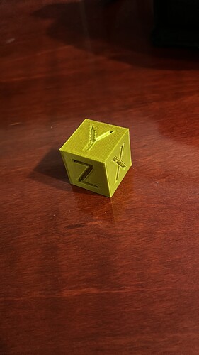

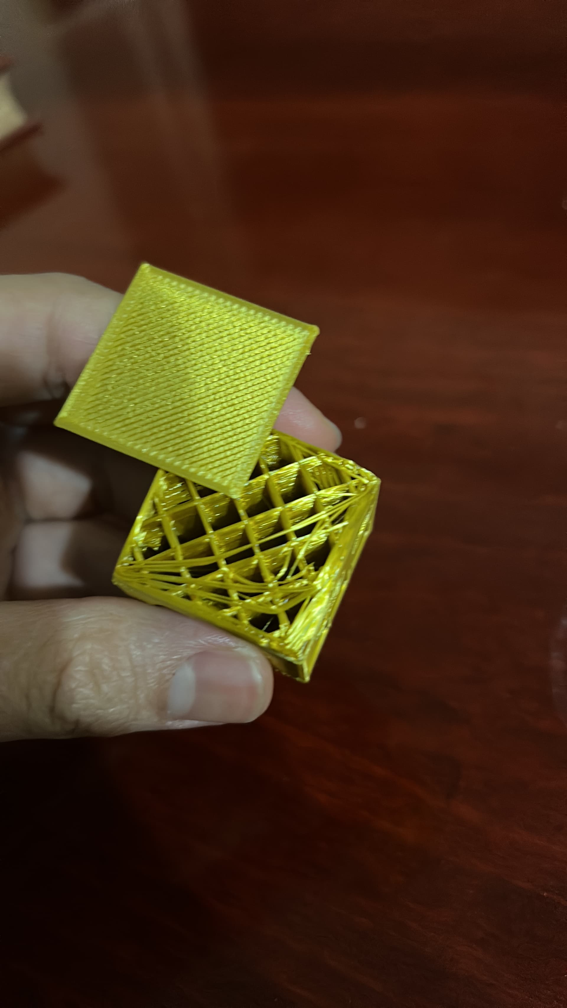

I’m having a strange issue with my K1C. During the print, the printer suddenly loses the correct XY position and continues printing from a completely different XY coordinate, while Z continues normally.
The print doesn’t stop or show any error. It simply shifts the XY position and keeps printing in the wrong location, ruining the part.
This happens with models sliced by me (Creality Print/App), while the factory preloaded models print perfectly every time.
Has anyone experienced this kind of random XY shift? Any idea if this is firmware, slicer, motherboard or stepper related?

In my case, the strange part is that the printer suddenly shifts the X/Y coordinates during the print and then continues printing normally from the new position, without any error or stopping.
Interestingly, the factory preloaded prints never have this problem and print perfectly. The issue happens with other models that I slice myself.

I have the exact same problem but only when I print from where the printer initially places the print.
If I move it even slightly then it prints correctly, I believe this is a software issue with the creality slicer
