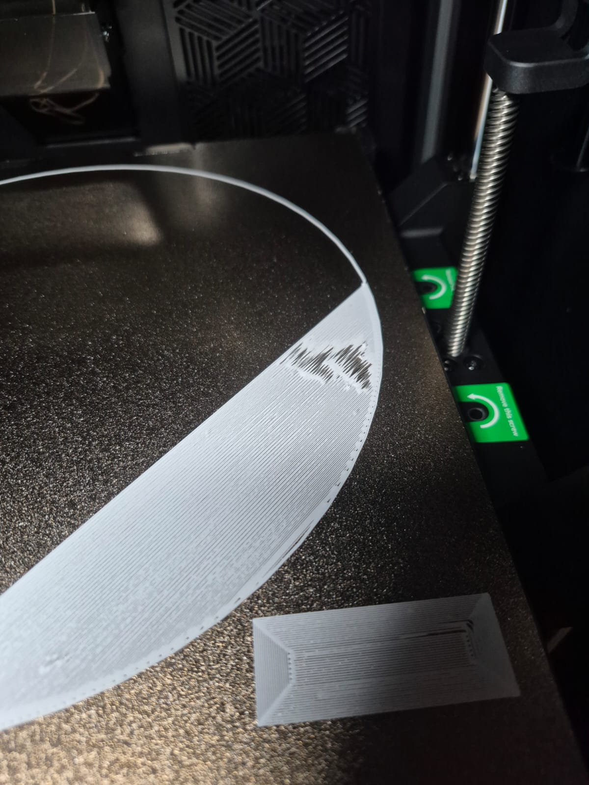

I’m looking for some help with my new Creality K2 Combo.
The printer was purchased on July 1st, 2026, delivered on July 6th, and has had first-layer problems almost from the beginning.
Symptoms
  • During the first layer, the nozzle sometimes over-compresses the filament.
  • In other areas, the filament does not stick properly and starts curling around the nozzle.
  • The nozzle then drags the filament, damaging the first layer.
  • The problem occurs across different areas of the build plate.
What I have already tried
  • Multiple Automatic Bed Leveling calibrations.
  • No manual Z-offset adjustments.
  • Cleaned the PEI build plate thoroughly with warm water and dish soap.
  • Bed fully heated during printing.
  • Standard Creality print profile.
  • Filament extrudes straight and consistently when tested in the air.
  • Repeated the calibration several times.
Interestingly, after running another automatic calibration, the behavior changed:
  • Before, the nozzle seemed too close to the bed and over-compressed the filament.
  • After recalibration, the filament started curling around the nozzle, even though I never changed the Z-offset manually.
This makes me suspect that the issue may be related to:
I’ve attached photos and videos showing the first-layer defects.
Has anyone experienced something similar with the K2 Combo?
Any suggestions would be greatly appreciated.
Thank you!

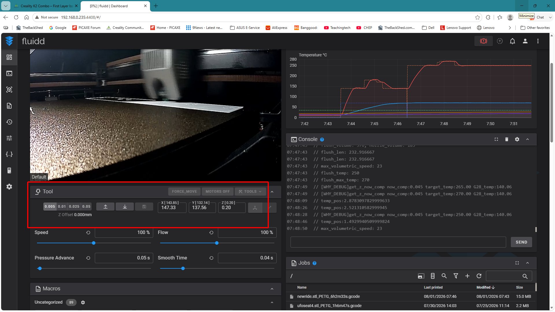

To adjust Z offset load fluidd by entering IP address :4408 in you browser.
