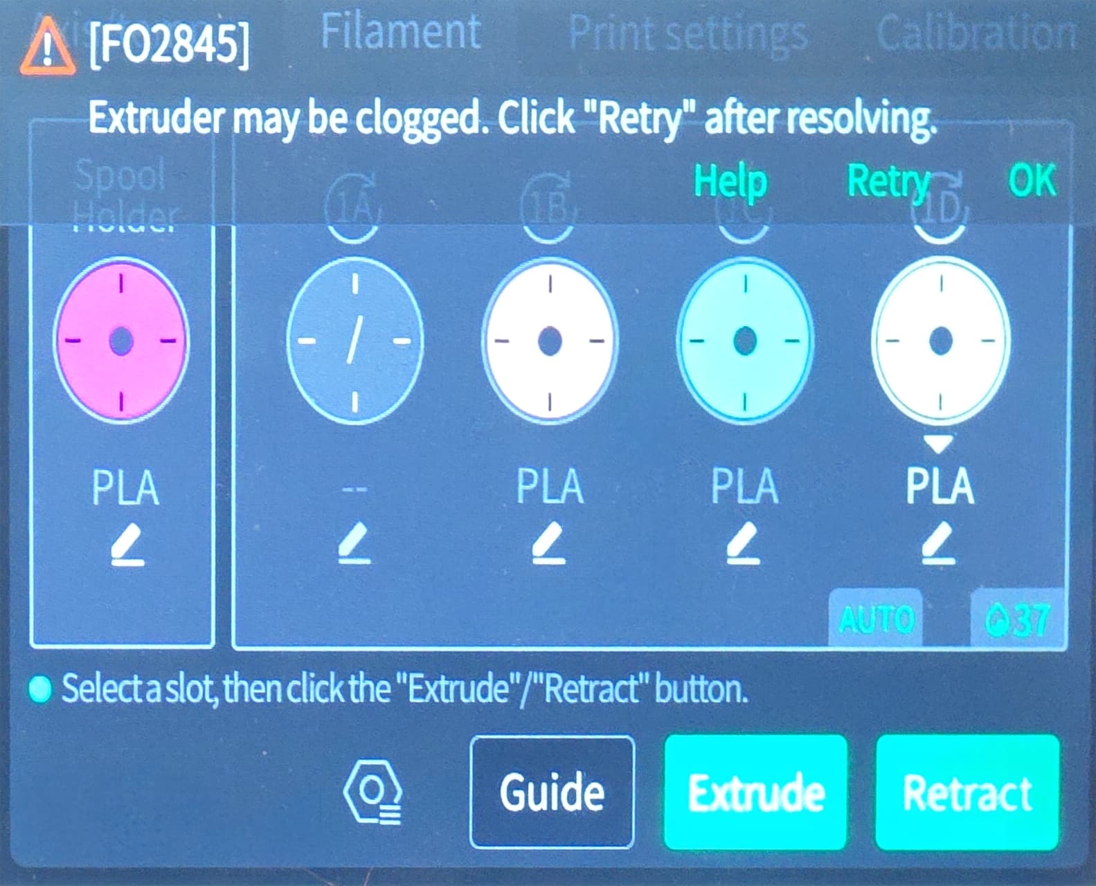

Hello, I have recently had a sudden scare with my K2 printer. All of a sudden when I loaded the Hyper PLA “Veri Peri” into my cfs a piece broke off in the nozzle and caused an error, I followed the steps to remove the piece and the printer persisted with detecting a clog in said nozzle. It got to the point where I decided to try swapping the nozzle and reconnecting the sensor, using standard white PLA that I know works I had the same clog error AFTER watching it extrude a fair amount of filament. Though this test also brought something to my attention, the bowden tube that connects to the nozzle flexed like it was gaining tension
then snapped back into place after a brief moment and I have never seen it do that till the recent Issue. I’m not sure where to go with this problem and I am afraid of the worst right now.

the gear’s are clear and functioning fine, as I mentioned its feeding filament and extruding completely fine, it goes through the pre print feeding where it cycles the filament through to clear out the last bit used but once it finishes that is when it throws the clog error

If I am remembering correctly, I believe it was the connector from the buffer on the back to the CFS that got disconnected somehow. Once i reconnected that and made sure all the tubes were connected properly the issue went away like it never happened.
When mine was brand-new, the solder joints on the pcb in the buffer had gotten loose. It would show that same error and I got lucky, when I jiggled the wire going into the buffer, and could see the LED lights on the buffer flicker. I had ordered a new buffer, but while waiting for it to arrive, I disassembled the old one and re-flowed the solder joints. It has worked ever since.
