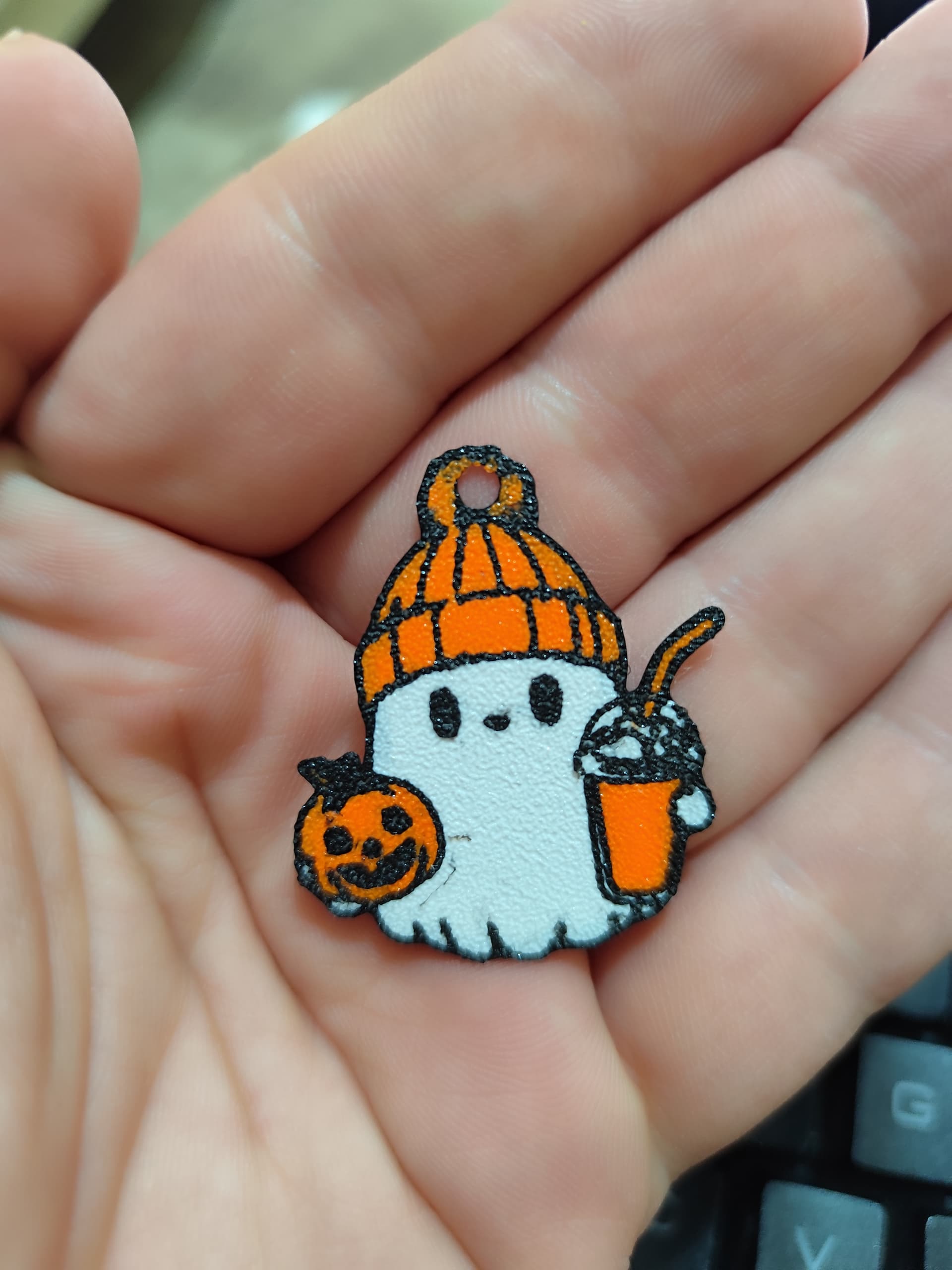

Hello, I bought a 0.2 mm nozzle, installed it on my k2 plus device and marked the 0.2 mm nozzle from the program for pla printing, I have filament jamming in every print and it is very difficult to clean, I have to disassemble the head and it gets stuck very quickly every time. what exactly do I need to do?

I wanted to try more precise printing. . I was curious . I saw the option of k2 0.2 nozzle, I bought it, but it may not be the original nozzle. I tried it, after every 4 or 5 minutes, the filament jam occurred, it locked very tightly between the gears, it was very difficult to remove it.
I also wanted to try some models that are not only layer thinning but also road thinning. we can reduce the layer but the road width is also important.
Especially in color prints, detail is very important, I wanted to try 0.2 for fine road lines and details, those details were not smooth in 0.4. Although I set the retraction and push settings to half setting, there were always lock-ups, I tried for 2 days, but my efforts were wasted.
0.4 mm nozzle . Details are not good
Then try this

Have you found a fix for your jamming issue yet? I’m having the same problem when trying to change colors. For me, every time the head goes to purge filament, it extrudes very fast and ends up jamming the extruder.
I never succeeded with cfs. I used it a little bit with 1 filament from the outside, then there was no problem, but then an update came to the application and it created jamming problems in the head again. so I disassembled it. I use 0.4
Ah i assume thats probably the problem that ive come across. I only started printing with it a few weeks ago and the thing that keeps stopping it is the flush sequence from one filament to the other.
I’ve the same problem, constant jamming with 0.2 nozzle and with 0.4 no problem now. I’ve tried to modify several parameters like speed and flow rate but nothing has worked. Creality should have good parameters for 0.2 nozzle but it’s not the case.
