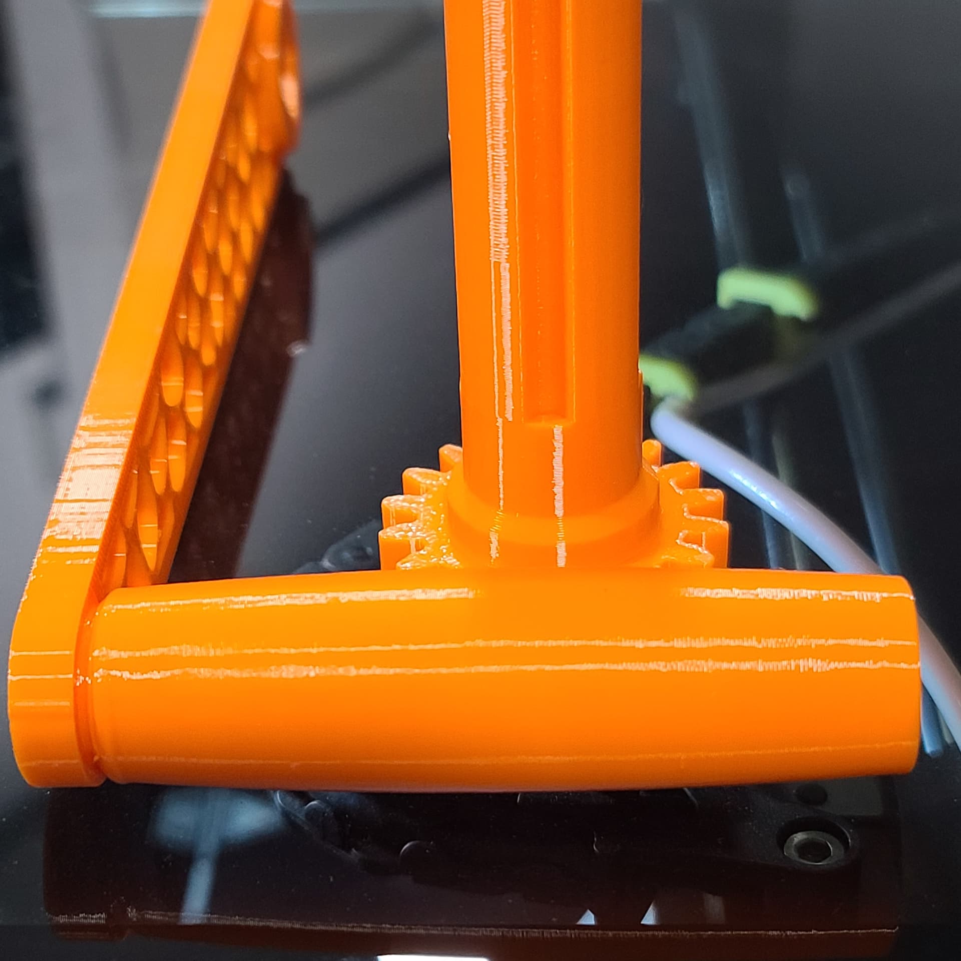

It could be a setting in the Creality Print slicer. I get great prints on all curves with PETG. Used several different brands..
Not a great picture. Sorry but the quality is good on this K1 Max..
Nozzle-250C / Bed-70C
