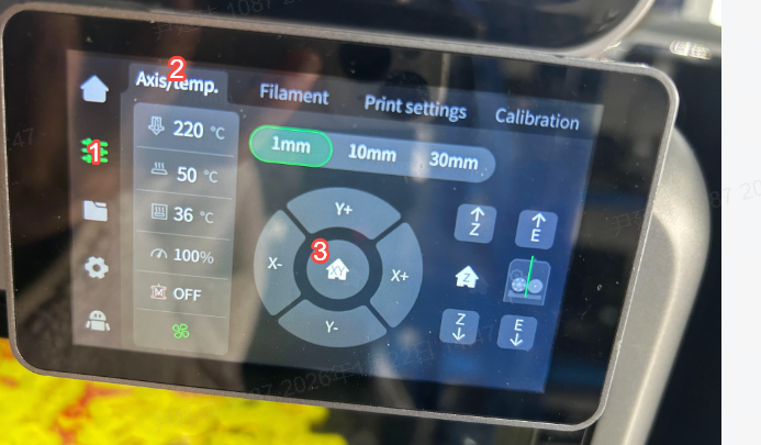

Why does this prompt appear?
XY axis homing failed, cannot perform precise nozzle wiping
How to solve?
Perform homing operation again from the main interface.
  1. Check if there is high resistance in the X/Y optical axis/rails causing homing failure; if movement resistance is high, lubricate the optical axis and rails before attempting to home again.
