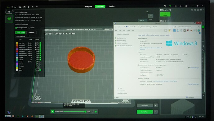

Just for my own interests sake, I tried installing the latest Creality Print on a windows 8 machine I have in my workroom (amongst 2 others) and it installed and sliced a round cap just fine.
Below are photo’s showing it, also note the graphics card is only 2 GB.
Cheers.
