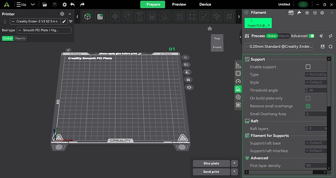

How do I add support density, support z distance, enable support roof, support interface density and minimum support interface area to the support settings in Creality Print 6? I don’t see them anywhere in mine, even with it set to advanced.
This is all I see under support settings.

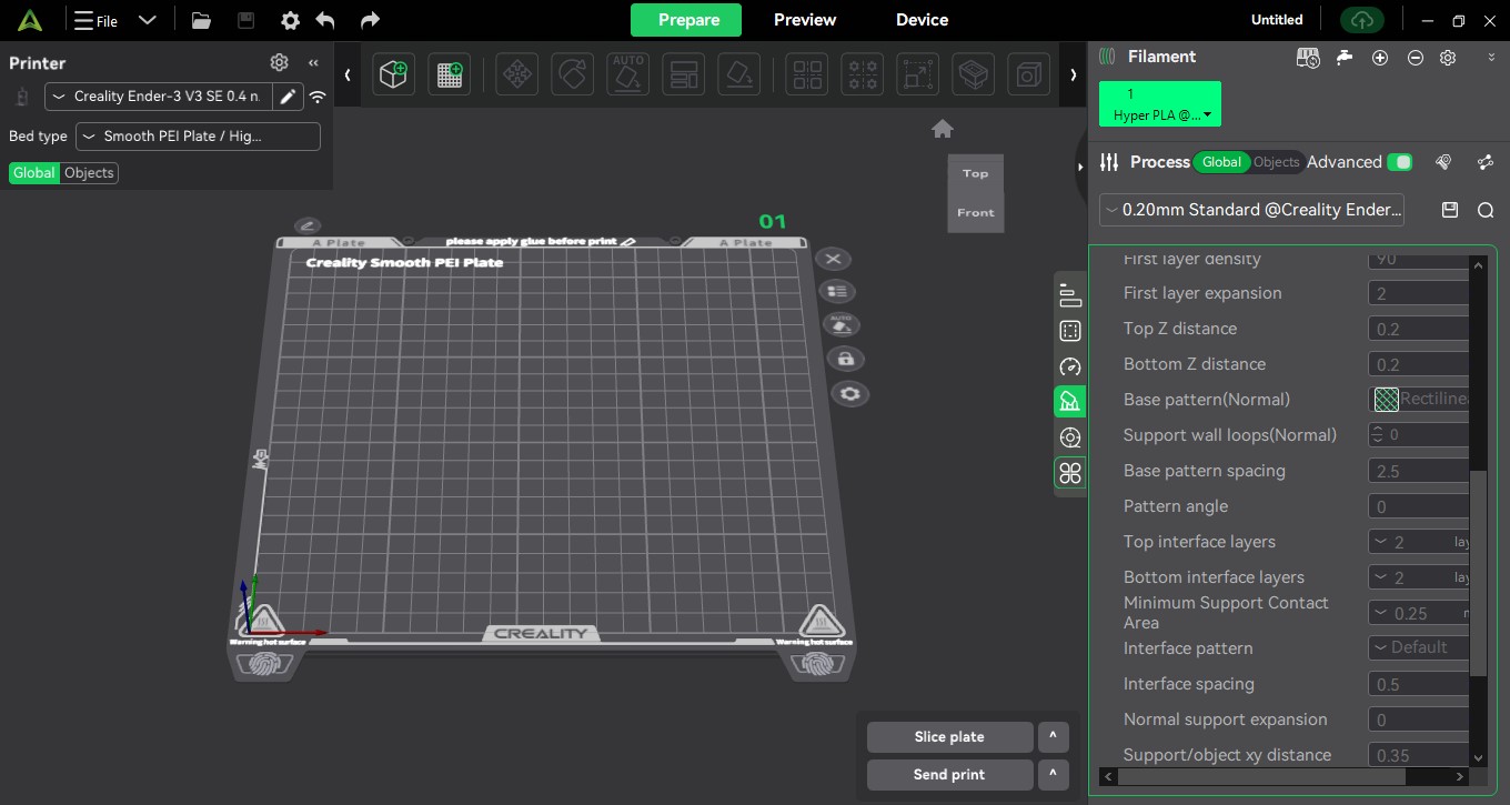

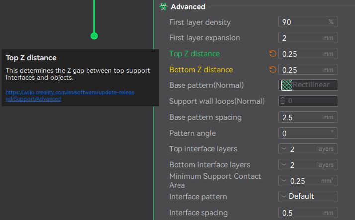

That’s the right place to look. In order to change the settings you need to check “Enable Support” at the very top of that list. I don’t usually change those. If you hover over each setting it will tell you what it does. Not always the best explanation but something.

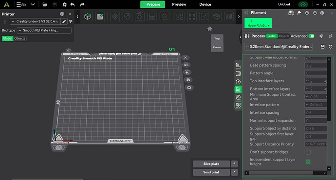

I do change these two settings as it sometimes makes the supports easier to remove.
I have used the support settings a few times, however, one of the things I’m trying to print, it specifically says in the instructions how to fill in the ones I asked about, except, I can’t find those settings.
