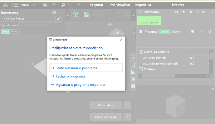

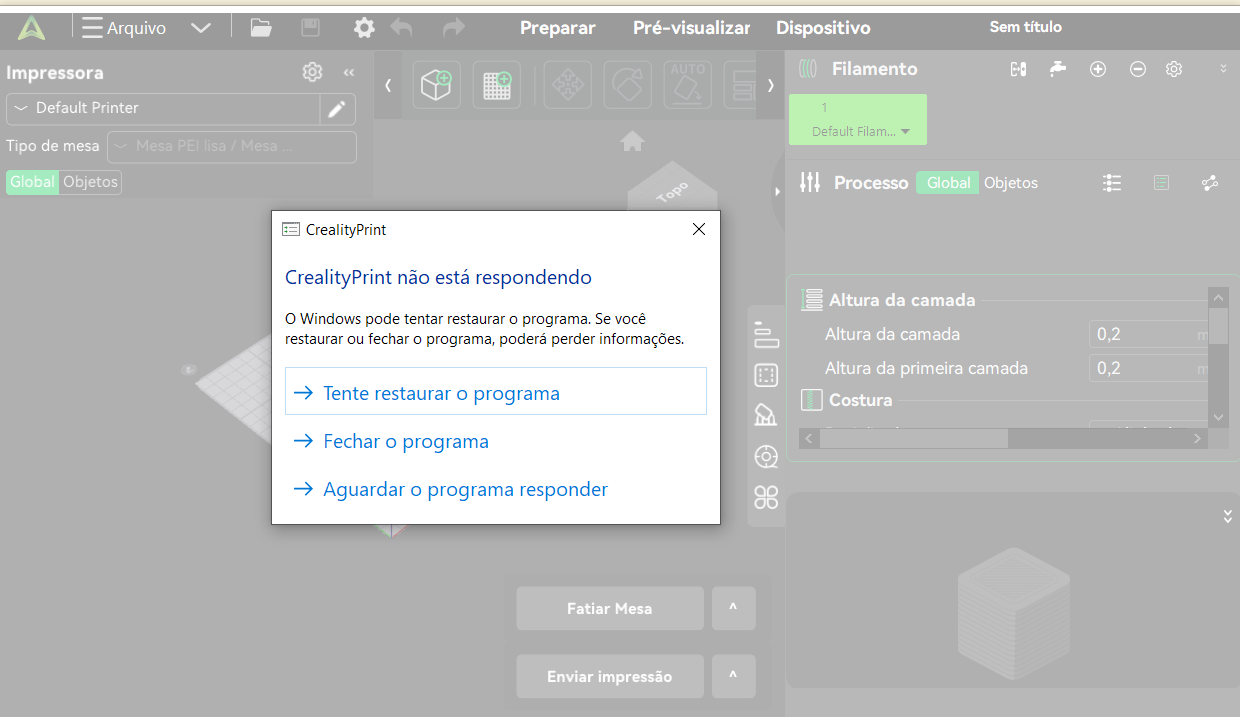

Creality Print 6 won't launch anymore (newest version as of 05/jun/2025)
The application suddenly stopped working mid a slice, then it won’t open anymore.
Already uninstalled normally, uninstalled using Revo ( completely wiping all registry and windows folders related to it ), reinstalled system drivers and redistributables related to the software, already tested the latest 5 versions, all are giving the same problem.
All other slicers are opening fine and slicing fine (Orca, Prusa, Cura, even Halot)

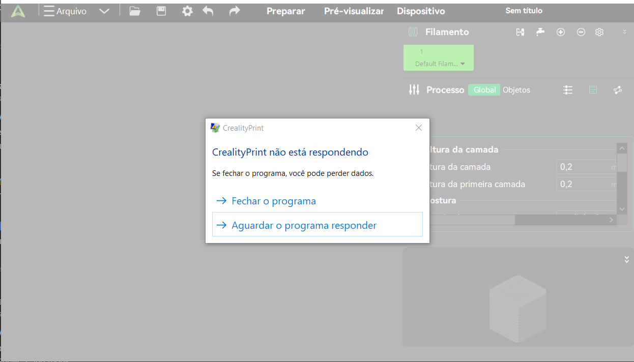

After the splash screen, the software shows only the top tabs, one time it managed to show more, then it just freezes. Already let it stay alone for 3 minutes, then nothing (I’m on m.2 NVME, every app opens in less than 3 seconds)

J’ai exactement le même problème depuis ce jour 6 juin 2025… certainement lié au Cloud… j’ai aussi essayé de réinstaller et cela ne change rien… en attendant plusieurs minutes… cela fini par fonctionner… c’est le cloud qui est malade…
On your PC turn off wifi/unplug ethernet, THEN start Creality Print, Cloud is down, but with no computer internet connection the software will stop polling every second!

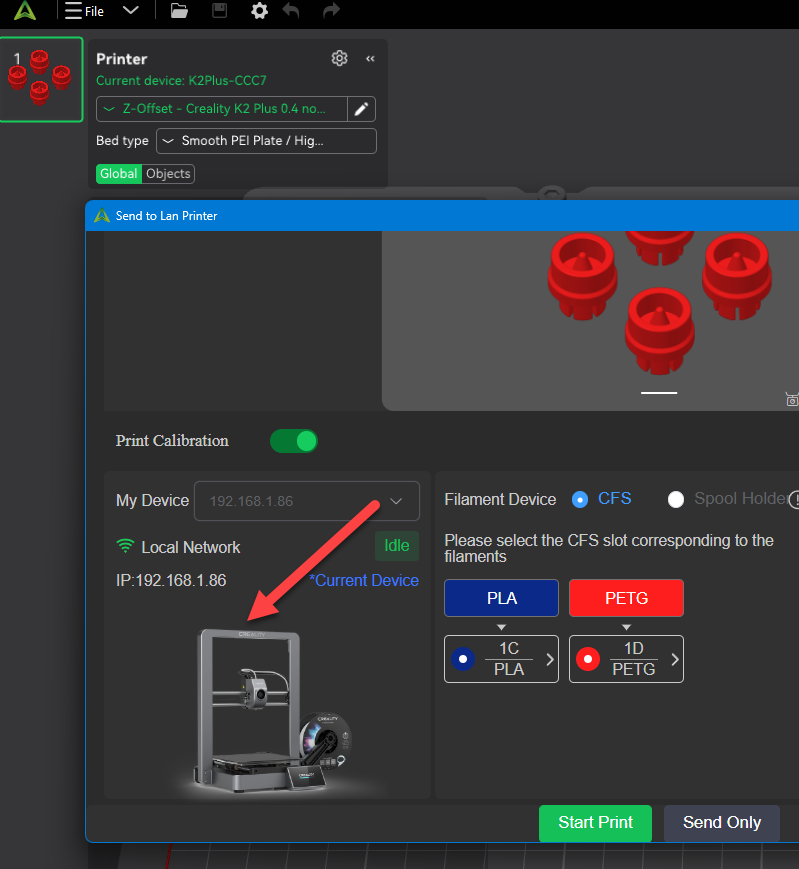

I have a K2 Plus…

To clarify the problem a bit more: Creality print did manage to connect to crealitycloud.com, which is a cloudflare cdn/proxy, but the origin server didn’t react. I think that combination caused the software to hang. Turning off the wifi or blocking connections to the internet, will stop it from connecting altogether, which is apparently handled more gracefully.
