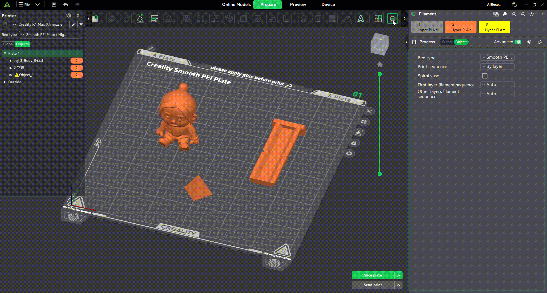

AI Smart Analysis: Automatic Support Detection
A new AI Analysis feature has been added to the toolbar. When AI Cloud Service is enabled, the system automatically analyzes all models in the workspace to determine whether support is required and recommends the appropriate support type (Normal/Tree).
AI Support (AI Support (clicking “Apply” will modify the support parameters at the object level.)

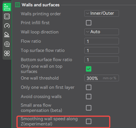

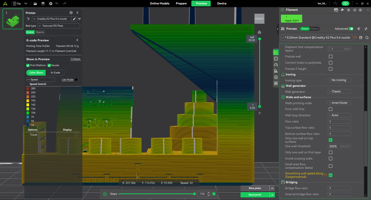

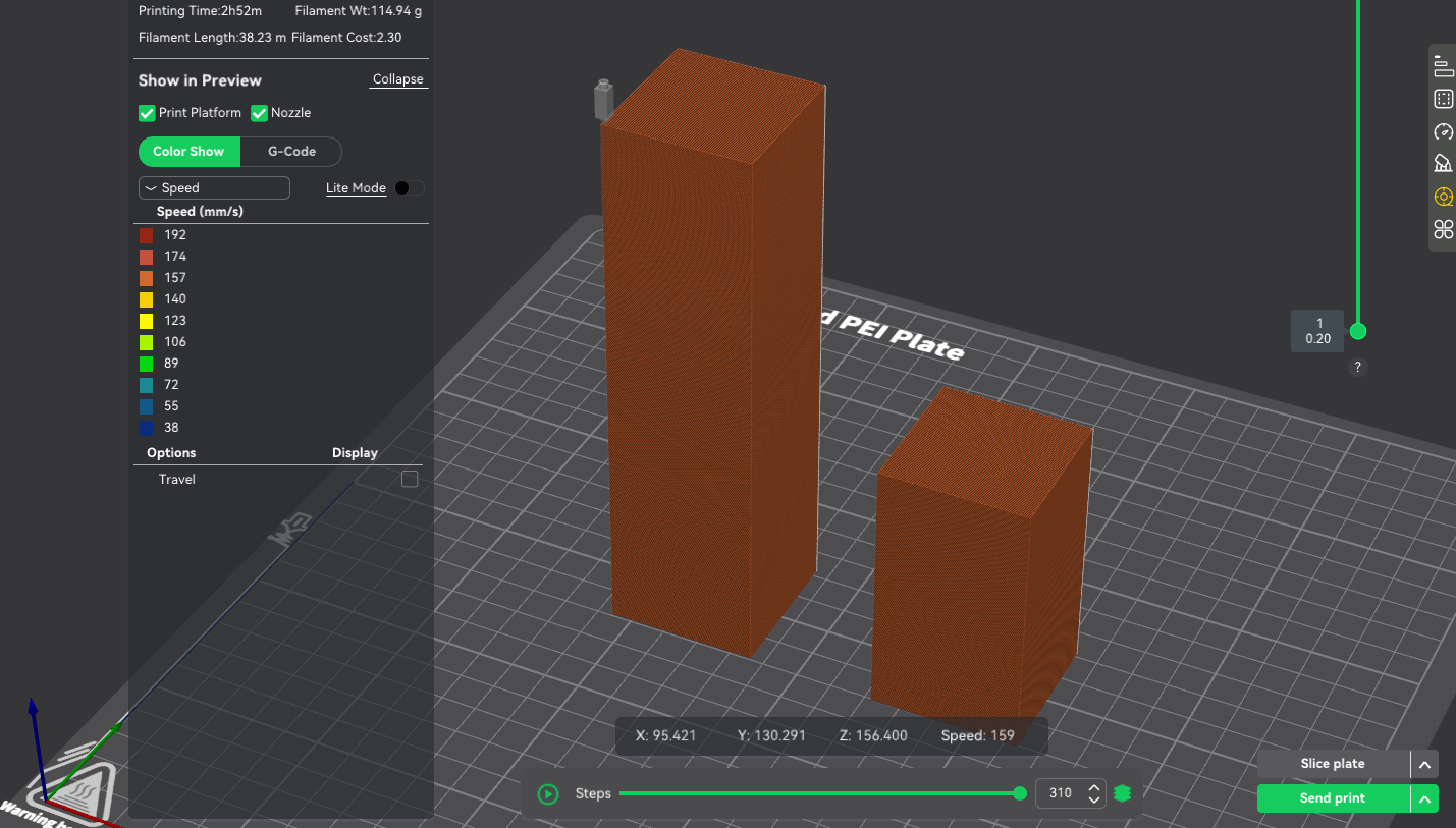

Layer Lines Optimization
New Process Parameter: Quality → Walls & Surface → Smoothing wall speed along Z(Experimental)
Parameter Description: Reduce visible Z-banding artifacts by smoothing speed transitions along the Z direction.
It mitigates surface irregularities caused by abrupt regional speed changes, improving the uniformity of vertical wall finishes.
Before optimization
After optimization
Left: Before optimization Right: After optimization

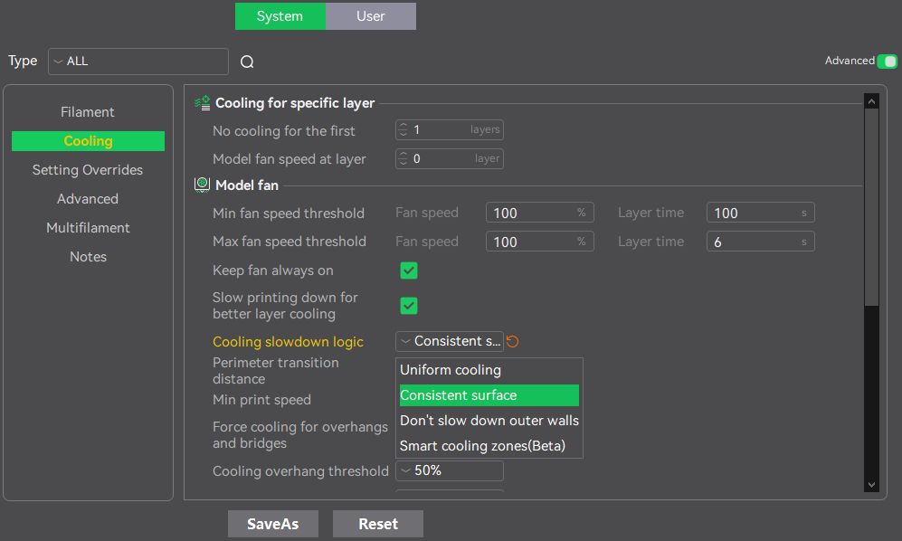

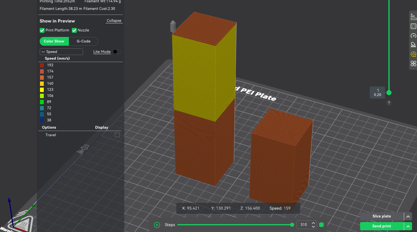

Ringing Artifact Optimization
New Filament Parameter: Cooling → Cooling Slowdown Logic → Consistent Surface / Uniform Cooling
Consistent Surface:
Ensures the outermost two walls are always printed at the configured maximum speed while reducing the speed of inner paths. This maintains the original layer time without sacrificing outer-wall quality. An adjustable Outer Wall Transition Distance allows the nozzle to gradually return to normal print speed, minimizing quality loss caused by sudden speed changes.
Uniform Cooling:
Maintains the traditional minimum-layer-time logic: if the actual layer time is below the minimum threshold, all paths are slowed proportionally to ensure adequate cooling.
Uniform Cooling(default)
Consistent Surface
Consistent Surface

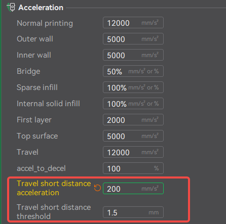

New Process Parameter: Speed → Travel short distance acceleration; Travel short distance threshold
Parameter Description: Further refines motion behavior to reduce ringing artifacts.
Travel short distanceacceleration=0mm/s²
Travel short distanceacceleration=200mm/s²

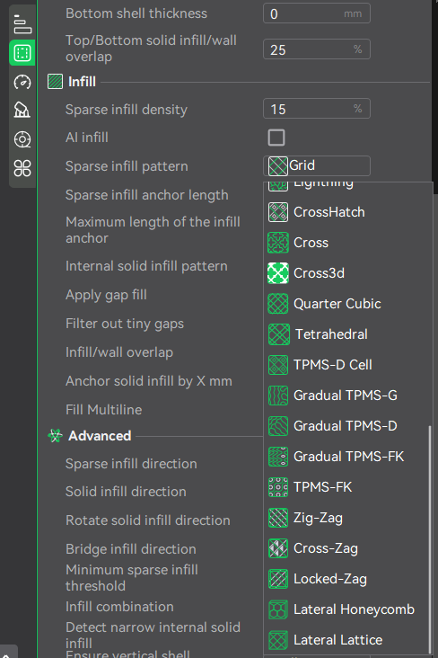

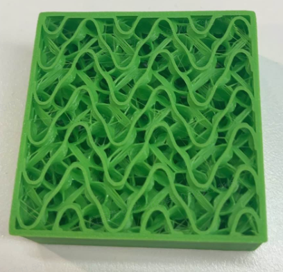

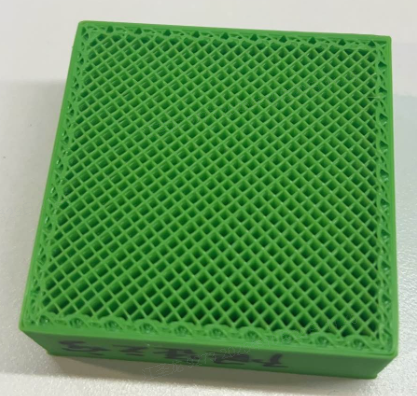

Infill
New Sparse Infill Pattern Types
We’ve added a series of high-performance sparse infill patterns optimized for strength, weight, print speed, and functional behavior.
Newly supported patterns include: TPMS-FK Lattice, Zig Zag, Cross Zag, Locked Zag, Lateral Honeycomb, and Lateral Lattice.
**A. TPMS-FK Lattice:**A lightweight, high-stiffness, high-stability infill designed for load-bearing and energy-absorbing structures.
**B. Zig Zag:**Similar to standard Line infill, its infill rotation step can be adjusted to offset the next layer’s infill by a certain line width through rotation.
**C. Cross Zag:**Similar to standard Line infill, its infill translation step can be adjusted to offset the next layer’s infill by a certain line width through translation.
**D. Locked Zag:**Supports adjusting skin and core infill types, densities, and more.
Improve surface quality:Continuous, surface-friendly infill (such as Zig Zag or Concentric) can be applied to shell contact areas to reduce the impact of internal infill on the surface, resulting in smoother and more stable top surfaces.
Enhance shell bonding and shear resistance:Grid/paths near the outer walls can use denser or stronger patterns to improve shell load-bearing capacity and interlayer strength.
Save filament / increase speed:The core region can use lightweight and efficient infill (Zig Zag, Gyroid) to reduce time and filament consumption.
Functional zoning: High-density, energy-absorbing / rigid structures can be used in contact areas while keeping the core lightweight (e.g., rigid edges and elastic cores in shoe soles).
E. Lateral Honeycomb: Standard honeycomb is a top-down vertical honeycomb pattern with multiple speed changes within the same layer, resulting in slower print speeds. Lateral Honeycomb has mostly continuous paths with speeds close to Zig Zag.
Lateral Honeycomb = “engineering-grade infill” balancing strength + print speed + stability.

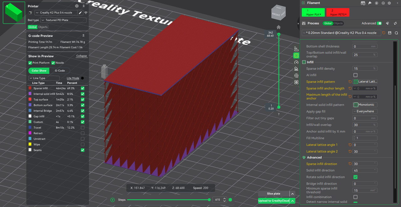

F. Lateral Lattice: Standard lattice infill is a top-down lattice pattern with multiple speed changes within the same layer, resulting in slower print speeds. Lateral Lattice has mostly continuous paths with speeds close to Zig Zag. Lateral Lattice = Zig Zag-like speed with lattice-like strength, an “engineering-grade infill” highly suitable for FDM.

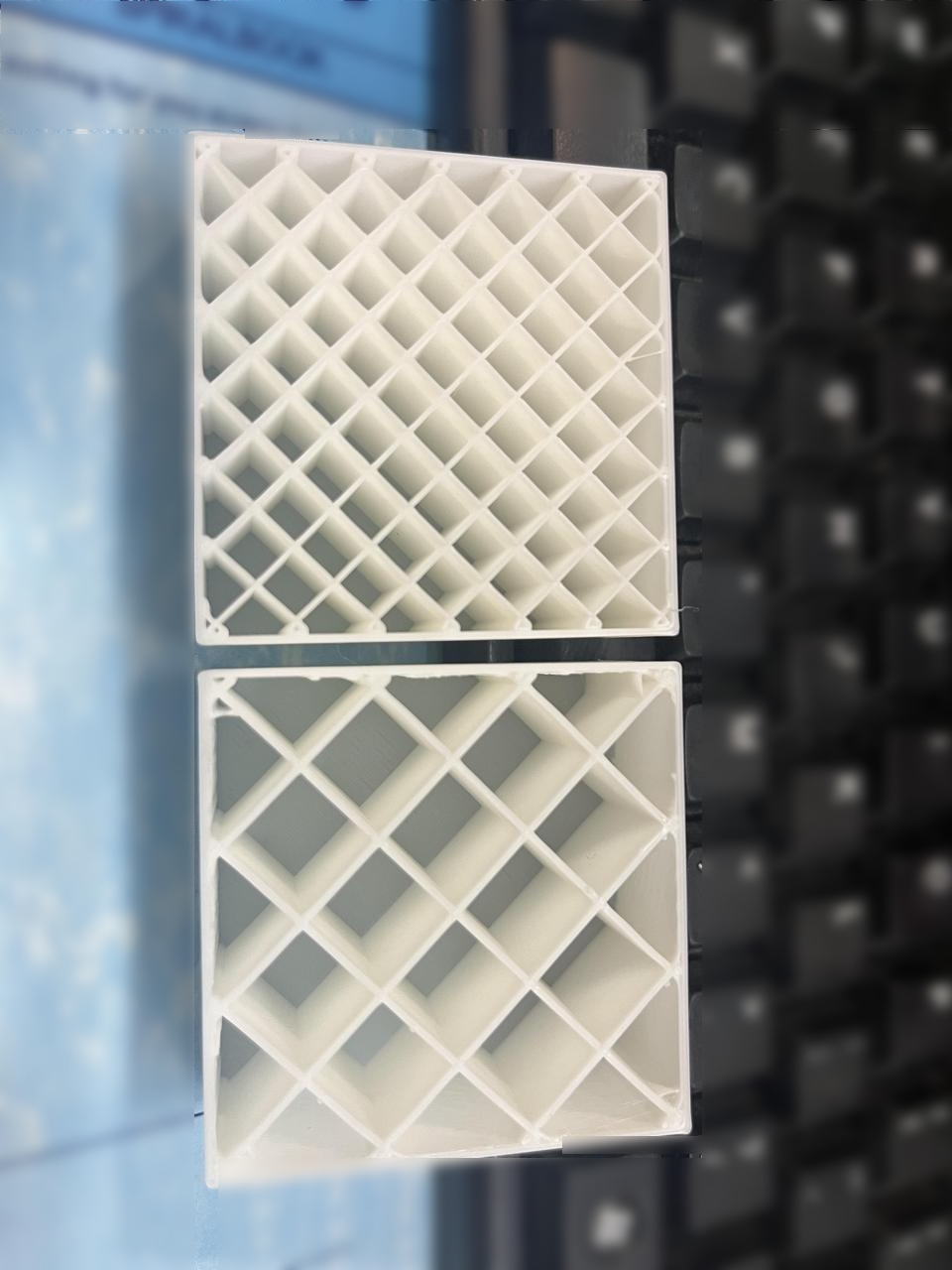

New Parameter: Fill Multiline
Fill Multiline improves part strength, stability, top surface quality, and reduces vibration by coordinating more paths working together. It is a more stable and reliable internal structure than traditional single-line infill.

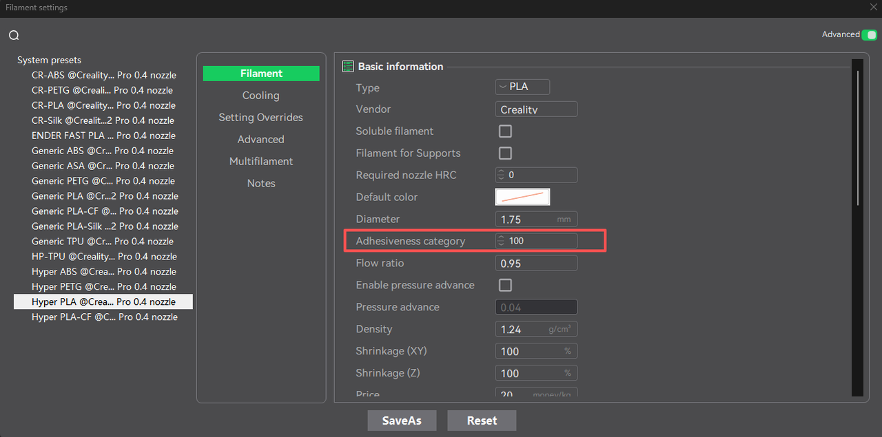

Split-Side Prime Tower Printing
New parameter: Adhesiveness category
This feature is designed to handle filaments with different interlayer adhesion levels.
When printing a Prime Tower with filaments of varying adhesion characteristics, the tower is printed with separated sides to avoid breakage issues that occurred in previous versions where layers were printed in an interleaved manner (for example, when printing non-bonding filaments such as PLA and PETG).

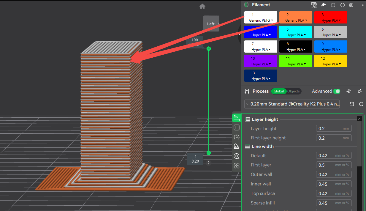

Added Prime Tower Outer Walls
When printing with multiple filaments, an outer wall printed with a unified filament is added to enclose the infill printed with different filaments, preventing Prime Tower collapse caused by potential collisions during printing.
Added outer wall openings and opening ironing: Openings are introduced in the Prime Tower outer wall, allowing the nozzle to enter through the opening to print the Prime Tower infill.
At the opening area, ironing is applied to smooth the extrusion start point and reduce warping caused by filament buildup.

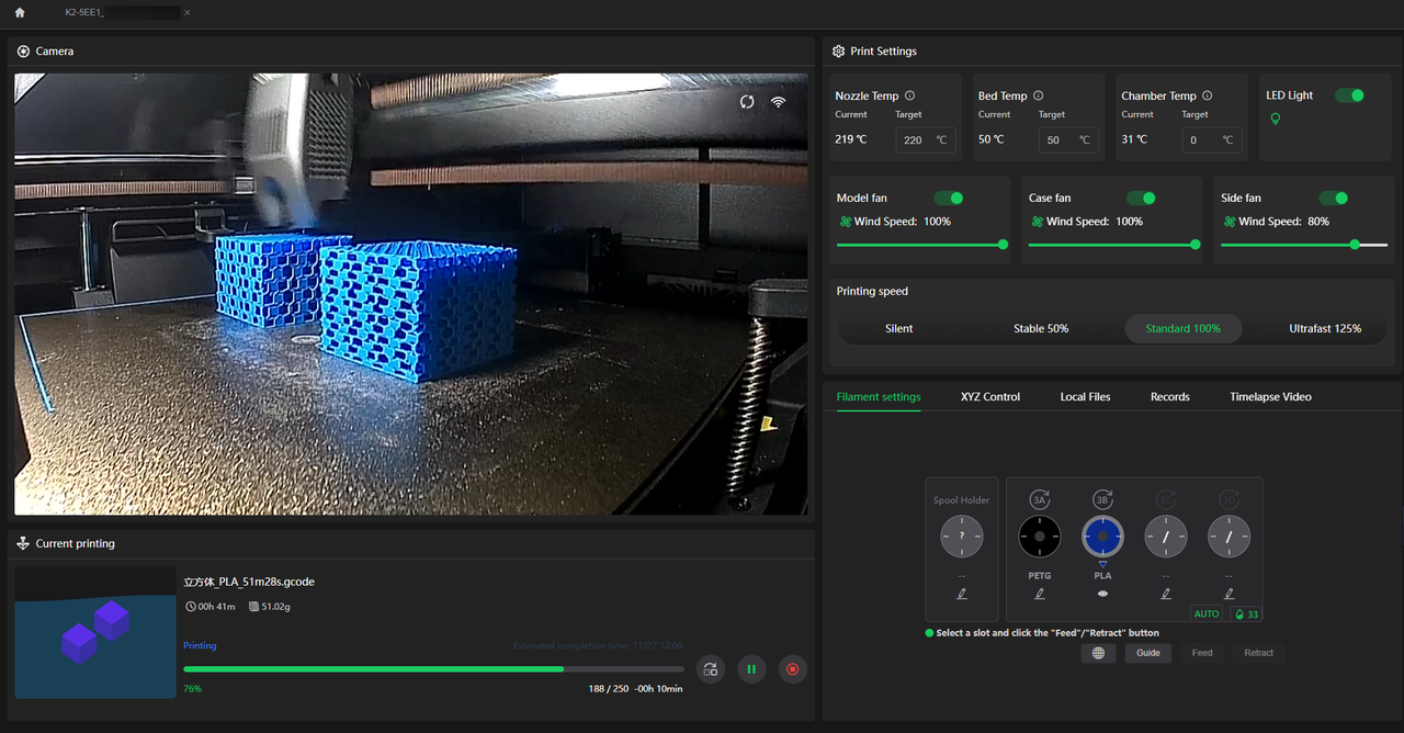

Device Management

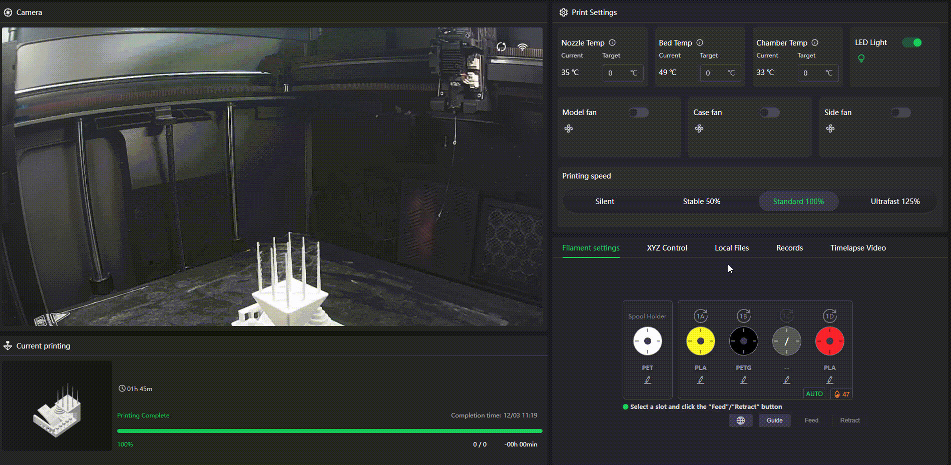

Device Details Page Upgrade
Aligned with the K2 series firmware update, the Device Details page in Creality Print has been optimized accordingly.
The functional areas are now further clarified: the left side focuses on the camera and the real-time printing display area, while the right side sequentially integrates printing settings, filament settings, XYZ control, local files management, print history, and timelapse video according to operational logic, effectively improving operational convenience and visual clarity.
  1. You can now simply hover over the icons beside the temperature indicators to view the temperature curves.
  1. Previous versions displayed the “Skip Model” operation entry directly on the details page. This has now been adjusted to be triggered and used only during the printing process.
WAN Connection Optimization
View camera video on the device details page
The camera preview feature for devices bound to Creality Cloud is now available. Once printing begins, you can view real-time previews. Currently, playback automatically pauses after 15 seconds, but you can resume manually with a click. Effortlessly manage the entire remote printing process.

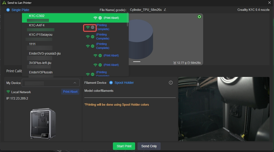

Print-Sending Page Upgrade
For wide-area network transmission scenarios, the print-sending interface in Creality Print has been upgraded with the following improvements:
Optimized device display logic: The previous “LAN / Creality Cloud” grouping has been removed, and devices are now presented based on the actual network connection type.
Upgraded icon-based status indicators: When both network modes are available, the WiFi icon and the globe icon :globe_with_meridians: are both shown in green. When only LAN is available, the WiFi icon remains green while the globe icon :globe_with_meridians: appears gray, clearly distinguishing the availability of network modes through visual differentiation.
New intelligent channel-switching mechanism: When sending a model, the system will prioritize the LAN transmission channel. If the LAN connection fails, it will automatically switch to the WAN channel, significantly improving the success rate of model transmission and overall transfer stability.

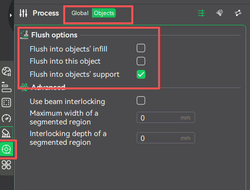

Existing features take effect

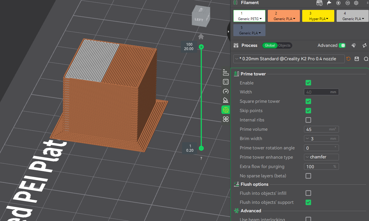

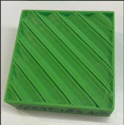

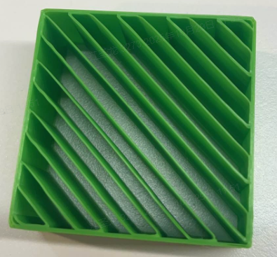

Flush into Objects’ Support
During filament change, waste flushing filament will be used for printing model supports.
Example: Changing from black to white requires flushing 100 mm of filament. If the next layer’s supports require 40 mm, enabling this feature will flush only 60 mm before proceeding to print the wipe tower and then the supports. This may cause slight color mixing in the supports but will not affect the main model’s print quality.
Applicable scenario: For models requiring supports, enabling this feature can save filament.
Flush into Objects’ Infill
Similar to “Flush into Object Supports,” this uses flushing waste for printing model infill.
Applicable scenario: For models printed with opaque filament, enabling this feature can reduce filament usage.
Flush into This Object
Similar to the above, but uses flushing waste to print the entire object.
Applicable scenario: For print jobs where only the model shape matters and color accuracy is not required, enabling this option can direct most flushing into the object itself, significantly saving filament.

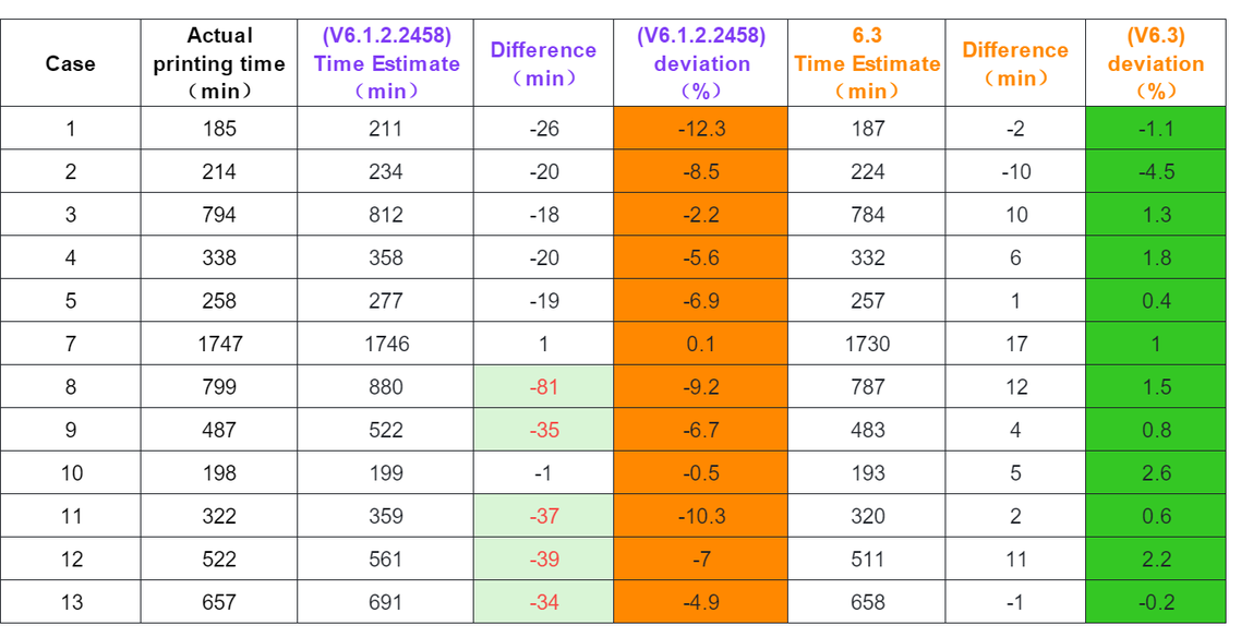

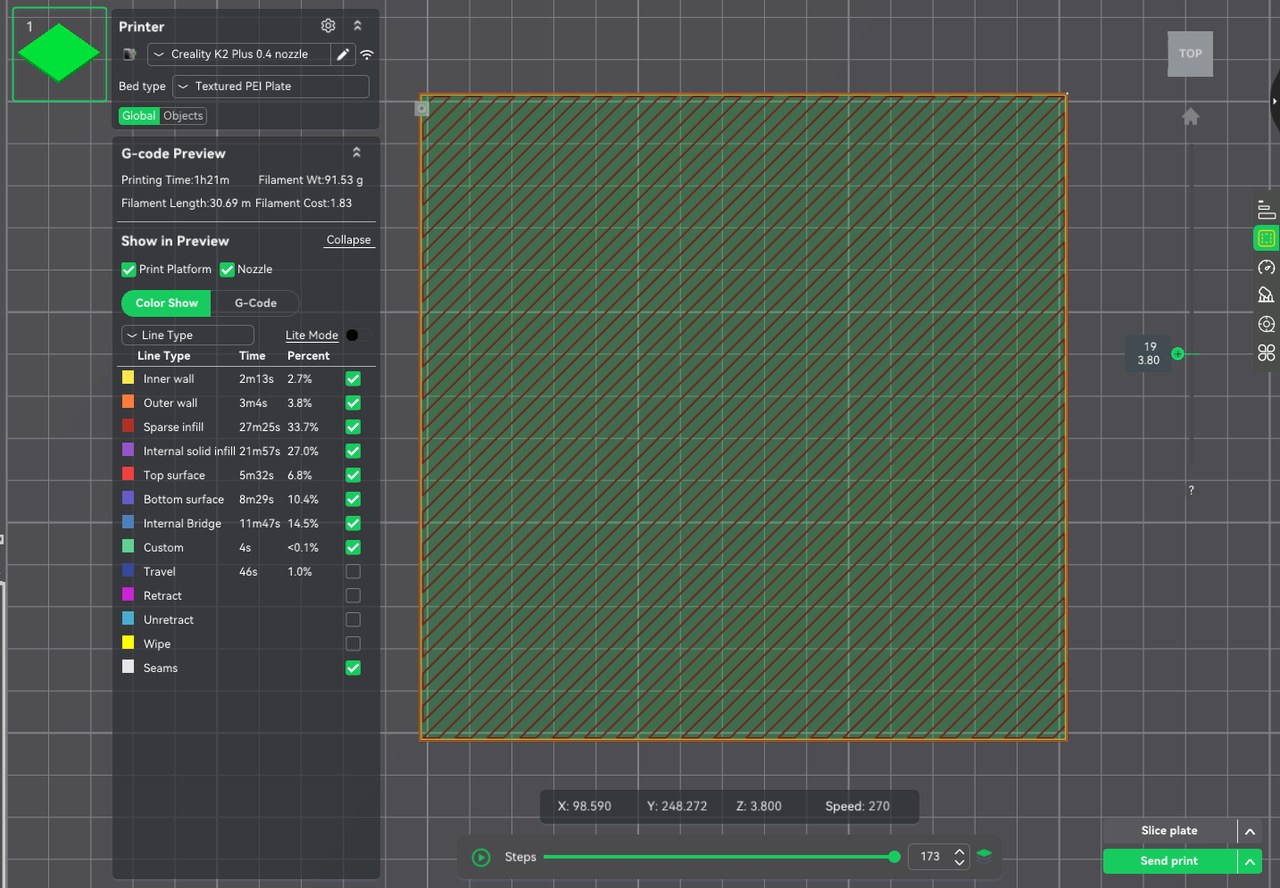

Improved Print Time Estimation Accuracy
This version introduces extensive testing and development to significantly improve print time estimation accuracy for both single-color and multi-color printing scenarios.
Single-color printing: Print time estimation error is reduced to less than 5%.
Multi-color printing: Print time estimation error is reduced to less than 5%. The new version decomposes the entire printing process, performs detailed estimation and error analysis, and delivers much more accurate print time predictions.

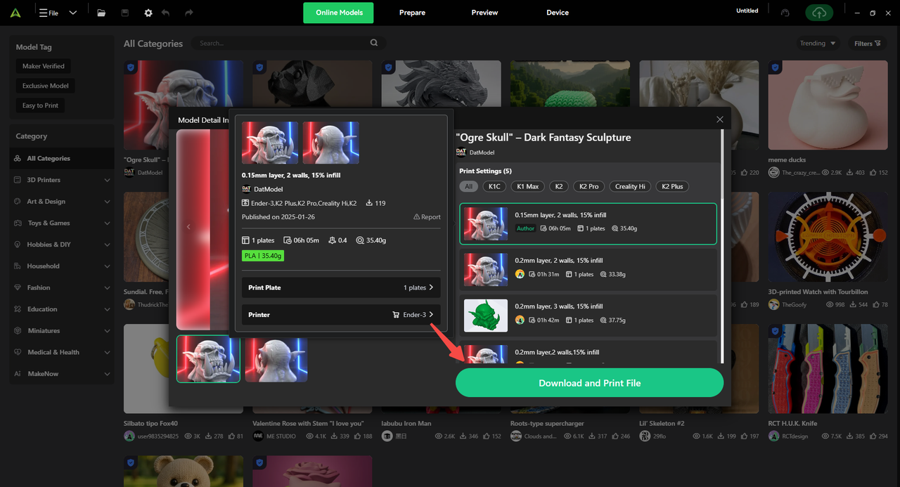

New Integrated Community
Online Models
A new Online Models entry is available in the top bar, enabling one-click access to the Creality Cloud model library.

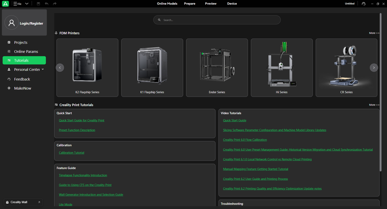

Tutorials
The Tutorials section has been fully rebuilt with a new UI and reorganized content structure.
Whether for hardware maintenance or advanced software techniques, users can now navigate through clear series-based and topic-based categories to quickly locate the knowledge they need.

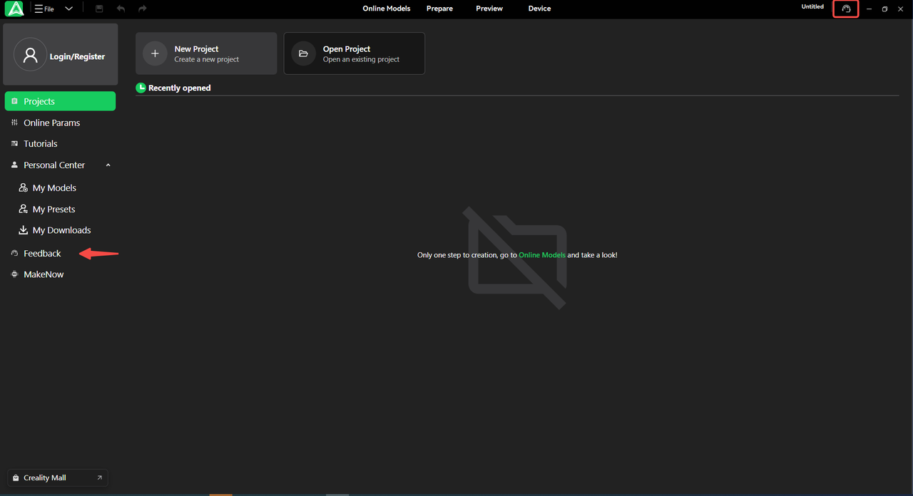

Feedback
A dedicated Feedback entry has been added to the sidebar, along with a new quick-access feedback button in the top toolbar.
Users can now submit issues or suggestions instantly during operation, enabling faster turnaround on user requests.

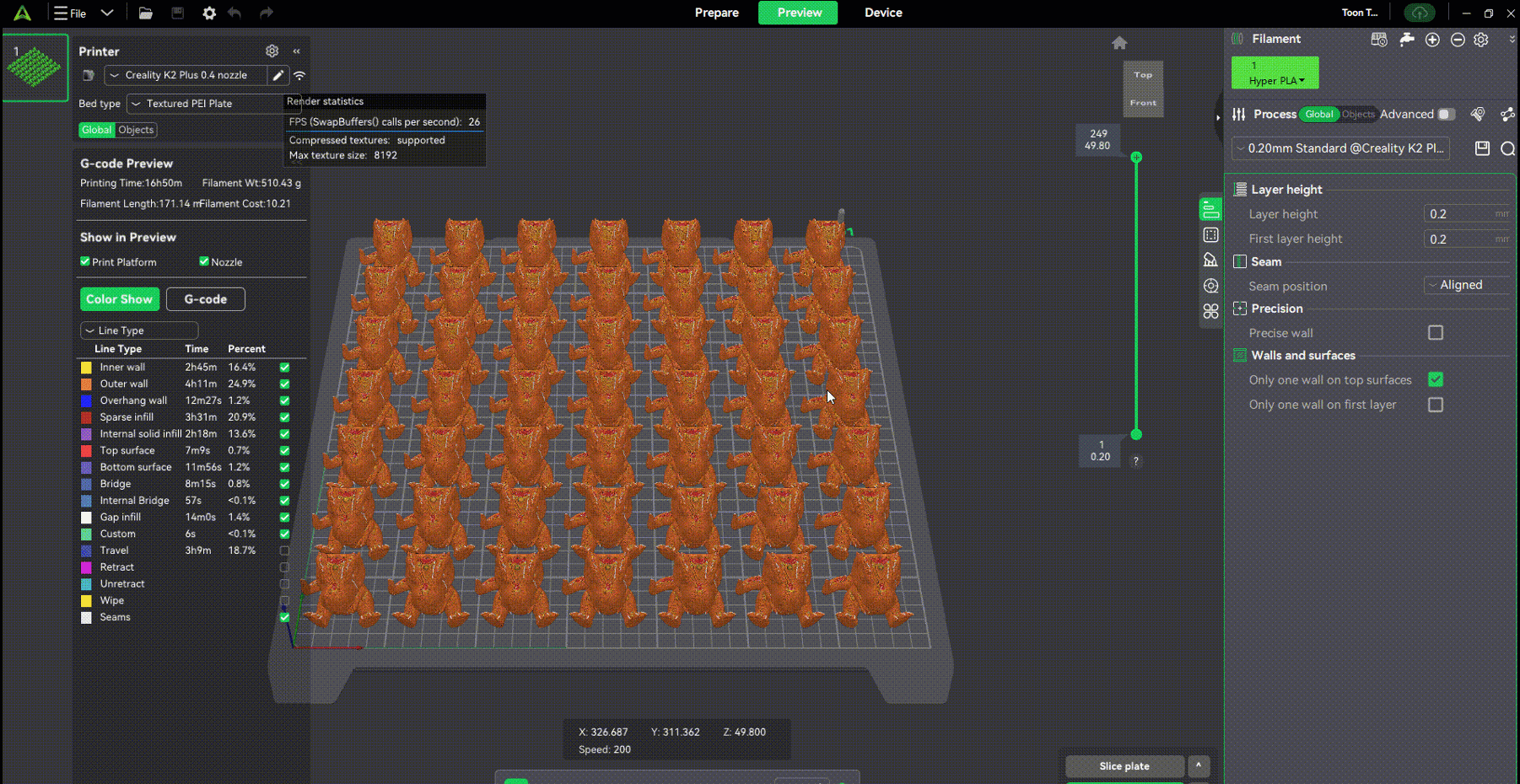

Performance & Efficiency

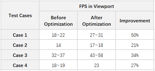

A new intelligent rendering pipeline has been introduced for the G-code Layer Preview:
  • When viewing the full model, unnecessary detail is dynamically simplified to ensure smooth rotation, panning, and zooming.
  • When zooming into specific layers, high-precision details are restored instantly.
This adaptive LOD-based rendering significantly reduces lag when previewing tall models or high-density layer data.
Across common preview scenarios, average framerate improved by 20% or more in internal testing. Using the small dinosaur case as an example, the frame rate improved by up to 24% after optimization.
before
after

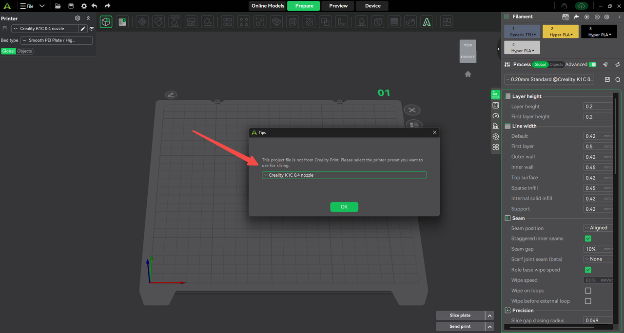

Third-Party 3MF Import Optimization
Optimized the import logic for third-party 3MF files. When importing 3MF files created for non-Creality printers, users are prompted to select a printer preset. Printer parameters from third-party 3MF files that are incompatible will not be imported. Modified process parameters and filament types/colors can be imported, while any unsupported filaments or process settings will be replaced with the default parameters matched to the selected printer preset.

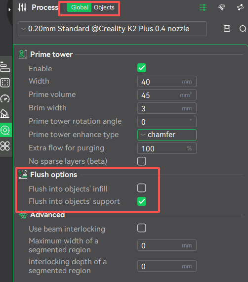

Hi,
I understand this is a known issue (and I’ve even seen community workarounds on GitHub involving macro/code modifications on the printer itself via its IP address).
However, I wanted to ask: Is there an official solution to the “Flush into object” problem yet?
It simply doesn’t work. In Creality Print, enabling this option doesn’t affect the calculated flush amount at all. To rule out a potential visual or preview bug in the slicer, I went ahead and actually printed a test. Unfortunately, the printer just performs a standard flush sequence down the chute, without saving a single gram of filament.
My Setup:
  • Printer: Creality HI Combo (with CFS)
  • Slicer: Creality Print
  • Current Version: 7.2.1.5476
