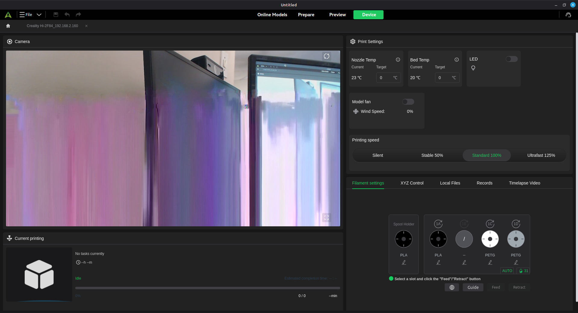

Creality Print 7.1.1.4472 Camera Images degraded on Linux vs Windows
I have a Logitech C920 webcam connected to my Creality Hi USB port.
I dual boot the same PC into Linux Mint 22.3 and Windows 11 so hardware is identical in both cases.
I am using the same version 7.1.1.4472 of Creality Print on both systems.

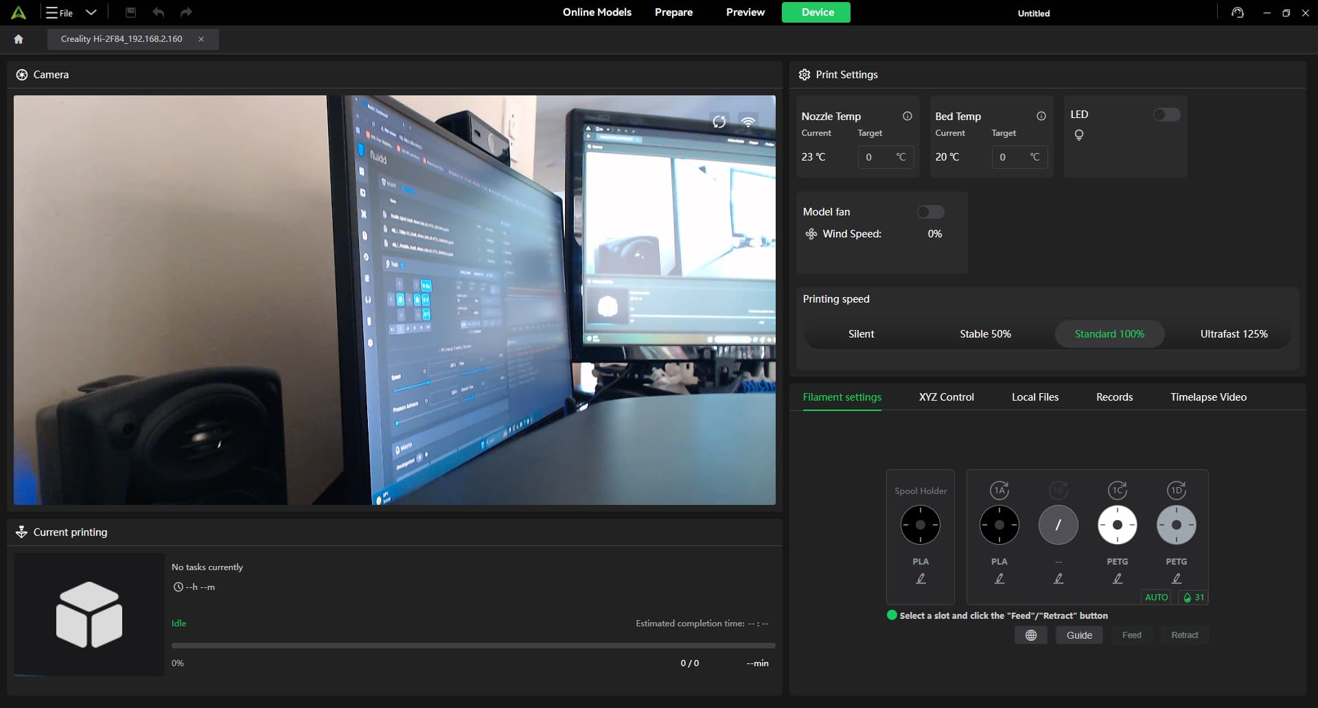

In Windows the camera shows up just fine using the Creality Print app.
In Linux Mint the image is distrorted as can be seen below.
Is there anything I can do to improve the image I get in Linux Mint?
Thanks.
Mike

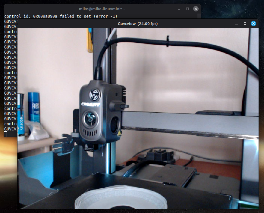

What I would do is to check if webcam works properly in linux using for example Cheese ,Guvcview…. not thru creality print, to see if there is maybe driver or whatever issue. Maybe missing some codecs , since it is streaming from printer.
Sorry i couldn’t help more

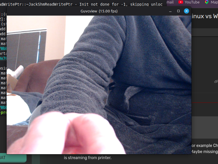

Just stuck the camera into the computer running Linux Mint 22.3 and ran guvcview and here’s the image, just a-ok.
Also plugged the camera into a completely seperate laptop also running Linux Mint 22.3 just incase and it works fine too.

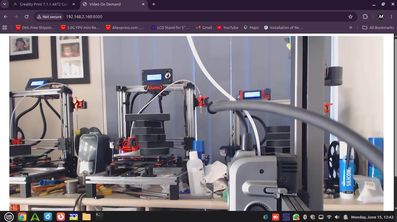

If I go onto the Hi’s web streaming page with the C920 connected the image is correctly displayed as below:
So it seems to be the way the image is being displayed in the Creality Print application on Linux where the issue is.

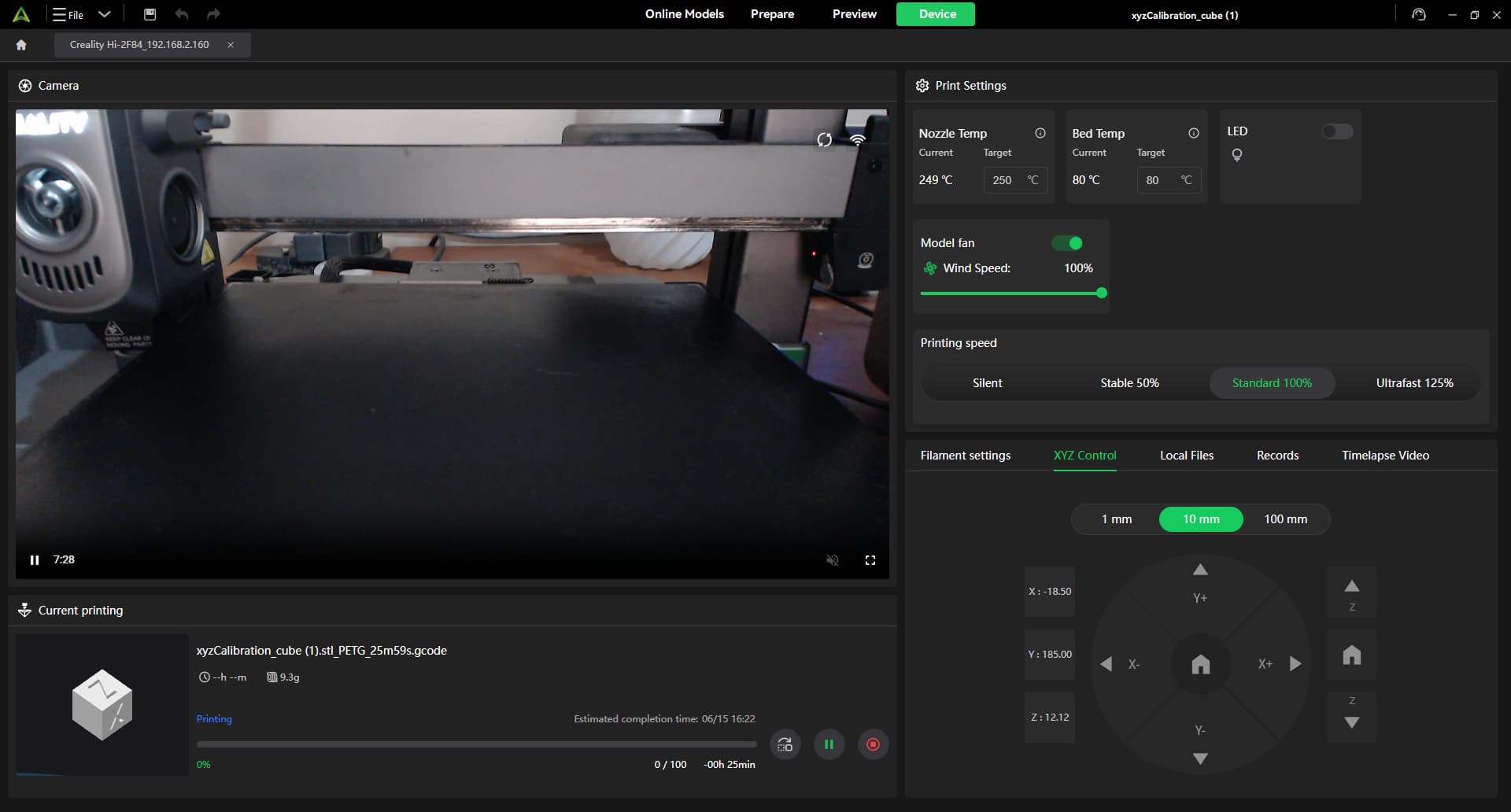

OK, so I downgraded all the way back to CR4NU200360C20_ota_img_V1.1.0.38.img and then tried a few Creality Print versions on one Linux Mint computer all the way up to 7.1.1.4472 and they were all the degraded same.
Then I upgraded the Hi to version V1.1.0.47.img and reran the various flatpaks. Still the same.
Now upgraded to the latest V1.1.0.65 firmware and reran on the different version flatpaks. I still get the same issue.
While I was doing this I was checking on the Windows version of Creality Print right the way through all the firmware versions, and it was working fine.
Soooo, this points to a definite issue with the Linux versions of Creality Print.

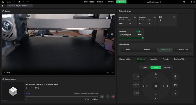

The main idea is to use an external camera for frontal timelapses instead of the underarm side camera on the Hi.
I am testing now on Windows to see if the timelapses will come out alright with the external camera connected to the Hi’s USB port.
I’ll let you know either way.
:rofl:
So even if you got an eternal USB camera connected it still uses the underarm camera….!!
Comeon Creality, you can do it, I just know you can do it!!
