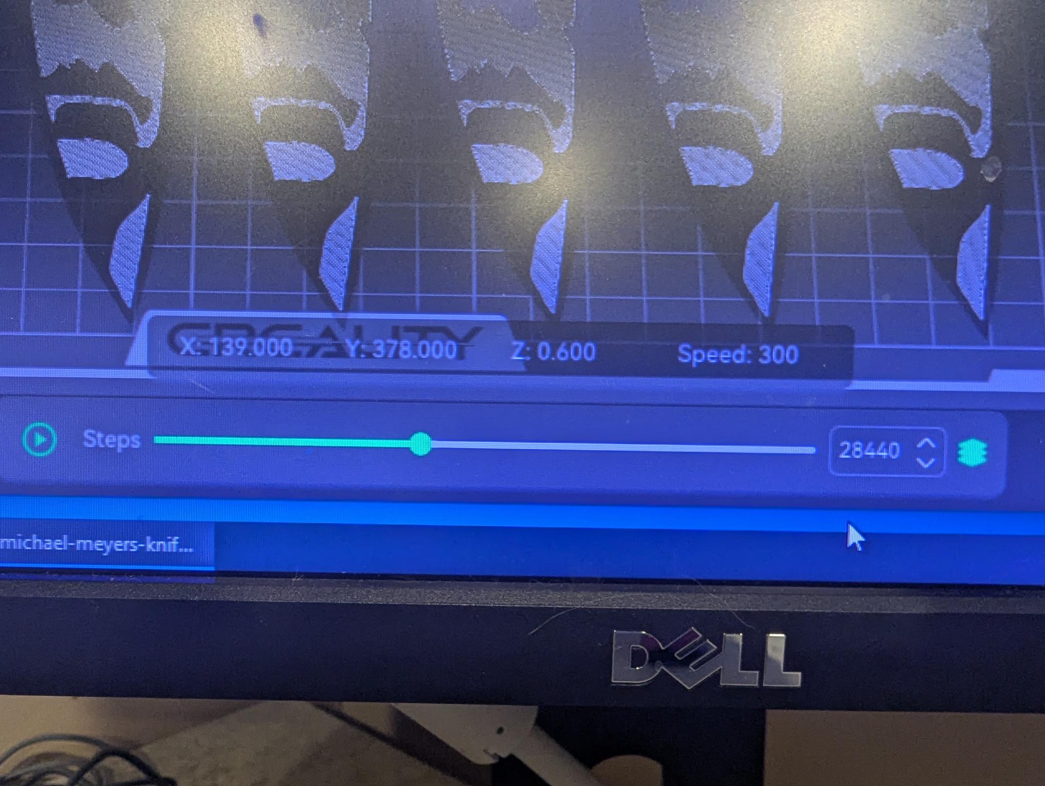

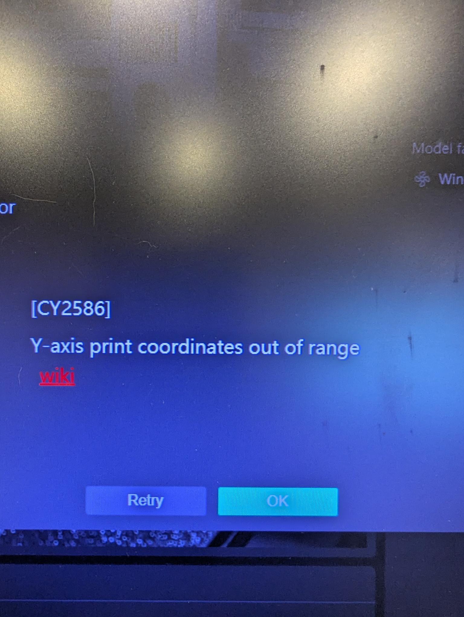

Creality Print > 7.1.1.4472 causes a CY2586 error when slicing with multiple colors on a K2 Plus with CFS. The gcode contains moves to Y 378 during color switching which is beyond the Y 350 range of print plate. Earlier versions don’t generate such movements.
