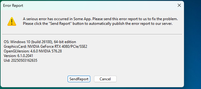

same keeps crashing , staring to hate creality print
every file i try to use and adjust to the k2 plus platform it still keeps crashing
feels like the software is poorly built!!!
only slices the most simple models…
Solution for high end computers,
Right click on the main slicer exe and go to properties
Then in the opened tab go to compatibility, the select in the dropdown of compatibility mode run as windows 8
