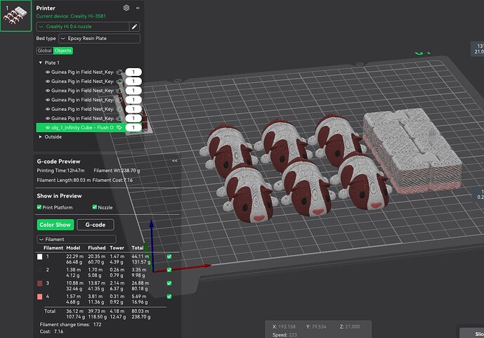

I was comparing Orca and Creality Print regarding Flush Into Object Setting… and I’m have my doubts that Creality Prints handles this correctly.
Orca Without a flush object… 77g flushed (multiplier 1.0)
Also Orca, but with a flush object with Flush Into Object and Flush Into Infill Set.
Down to 49g, and the object if mostly white (and that makes sense, since is the color that we need to flush more).

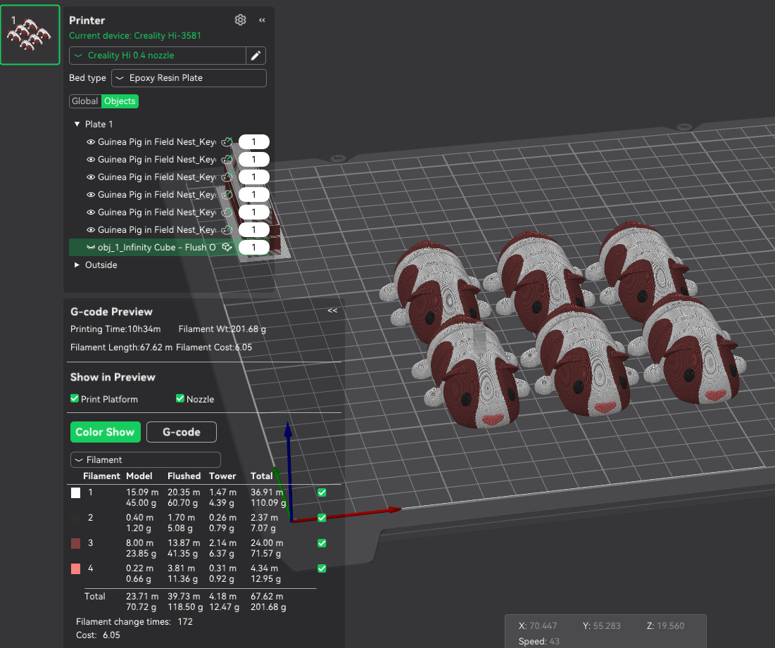

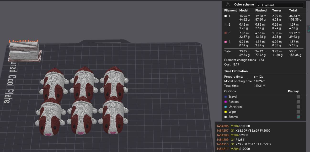

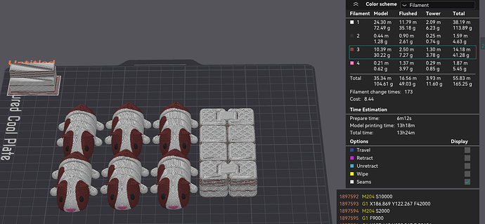

Now creality Print 6.1.1.2277 without a flush object 118g flushed (default multiplier 1.3 - Creality Hi btw)

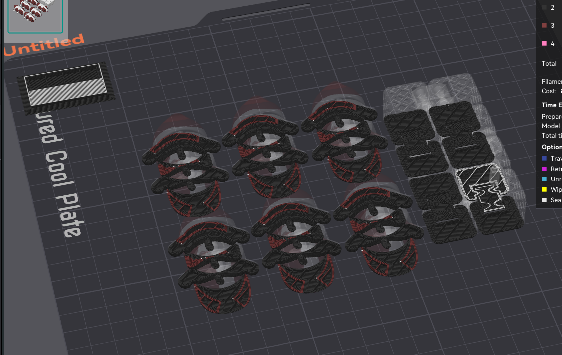

And now with a flush object… nothing has changed in the amount flushed, and the object is mostly red, brown and black.. with white only on the last layers.

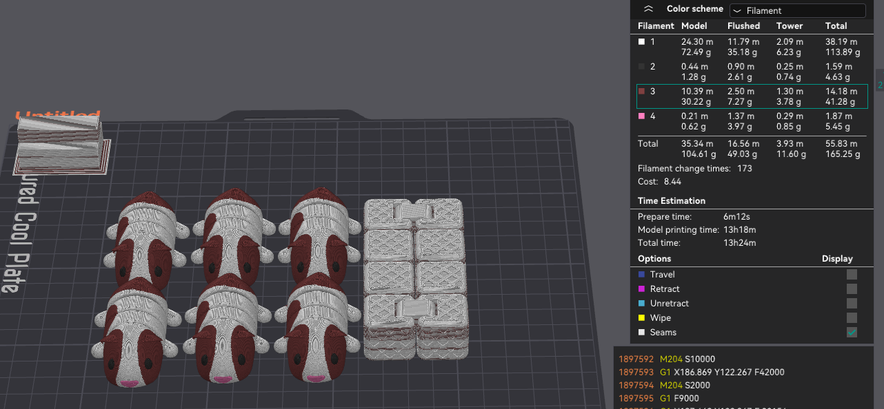

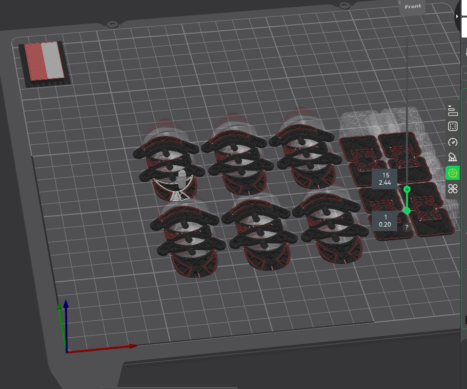

If we inspect layer by layer (layer 15 in this example), It starts printing with brown on the flush object. prints with brown my main objects… switches to white and directly print white on the main object… no white flush on my flush object.
But orca does the opposite (same layer, layer 15).. it start with brown on the main object… switches to white, and correctly flushes the white on the flush object.
So I really think this feature is bugged on Creality Print 6.1.1.2277

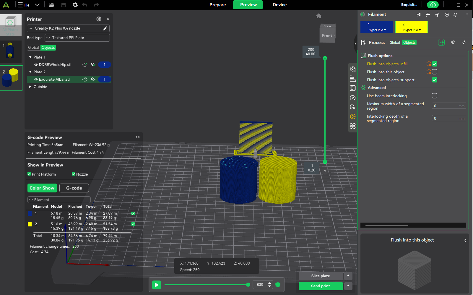

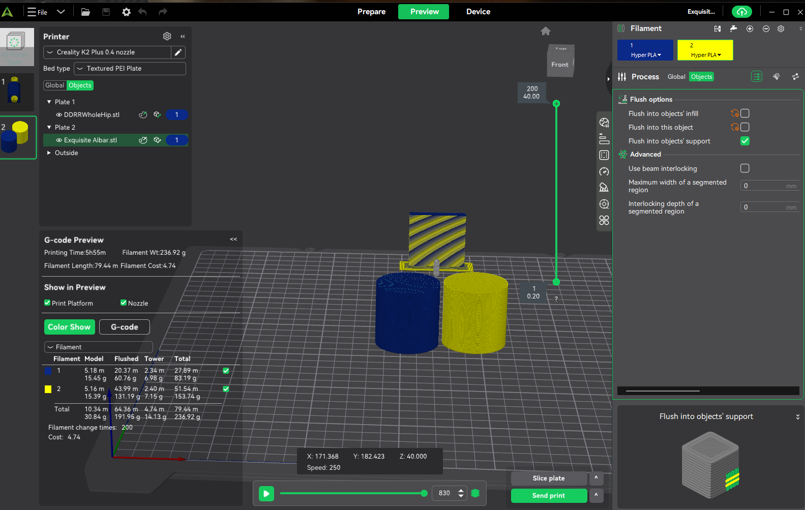

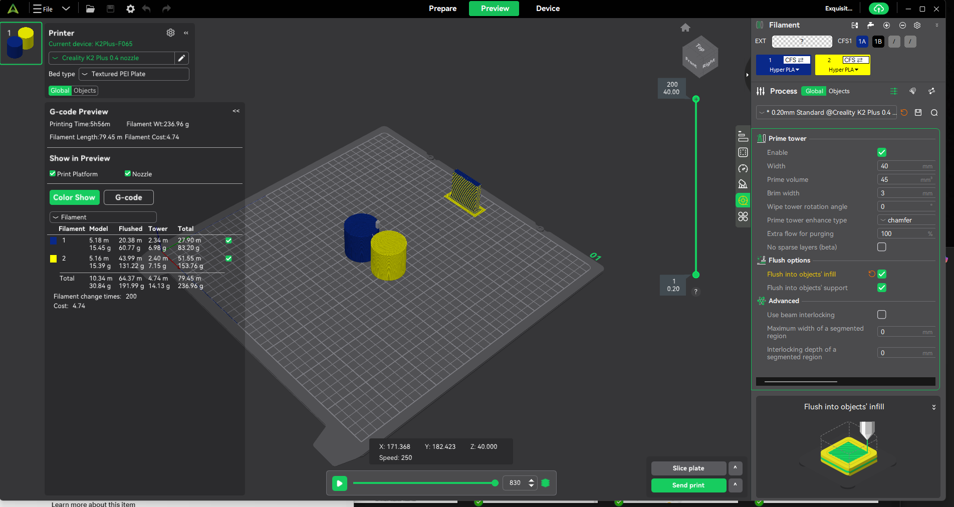

Same issue here, regardless of using right click > Flush options> Fill into objects infill or from Flush into objects infill options under the multifilament menu, though its worth noting that selecting it by right clicking or the multifilament menu does not toggle the other also,

I can confirm these same issues are happening on my K2 Plus with Creality Print v6.3.1.3548. No matter what I set the Flushing Volume Multiplier or other values to the results are exactly the same with heavy bleeding of black or red into other colors in the print that follow these colors.
Same issue for me, this is making my K2 unusable for color printing. This does not happen on my Bambu PS1 with AMS. Do we just scrap using Creality print and use a generic orca like from Elegoo?

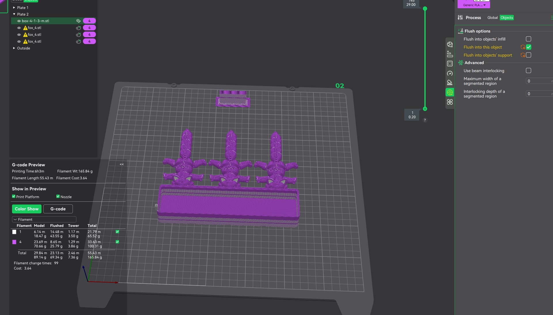

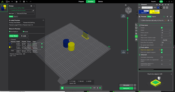

I’m currently on Creality Print 7.2 and still having the same problem—the slicer doesn’t calculate the flush into the object.
Just to be sure it’s not just a software visual bug, I printed a test. The printer still pooped everything out - the sacrificial object printed, but zero filament was saved.
