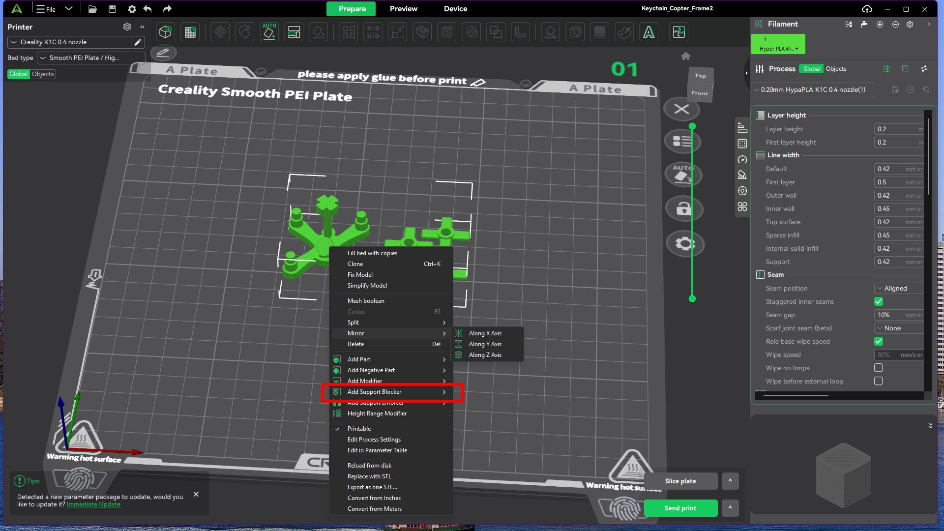

Creality Print PLEASE add a support block feature >.>
I know I should use a different slicer. Hell I still use the old Creality Slicer 4.8 for my 5 Cr6 Se and Max. That one has a support block feature and I love it. Sadly Creality print is needed for my Cr10 se and the K1 Max. It works fine, but if we could get a “Support Block” button it would be a benefit to the slicer. Tree supports are my goto in the new slicer but sometimes they are EVERYWHERE and blocking some would be a godsend.
I would think this would be easy to add. Please? O.o

Thank you for your reply. :slight_smile: My issue I create holes where pins will go to assemble the model. The slicer ALWAYS puts a support in those holes under the model but they do not need to be supported to print successfully. These supports are hell to remove >.> as the holes are small. If we can just block them, problem solved.
It is a simple feature found on just about every slicer.

At the top towars the right side of screen is the support blocker. You can paint the area that want or dont want supports
Well, that sort of works. It lets you add supports manually. No way to block supports, which means you have to find every single spot that needs support and paint it, as opposed to just marking a few specific spots as “do not attach here”. It’s a lot harder to do that way — especially if you are nuking and reloading the model after making minor changes over and over again while designing something, because it means you have to do a lot more work every time you re-import the model.
So I’d like to second the request for a proper support blocker feature, which this is not, unless I’m missing something in the UI.

EDIT: I may have spoken too soon:
https://wiki.creality.com/en/software/update-released/release-notes/release-note-5-1-0#added-support-enforcer-and-blocker-features
Son of a gun. It’s there. It’s just badly hidden, available only in contextual menus (which Mac users tend not to use that often). Why they have two entirely separate interfaces for adding and removing supports, I don’t entirely understand. But it’s good to know that it is at least possible, if completely non-discoverable. :joy:
In creality print 6 right click the object then select support blocker
