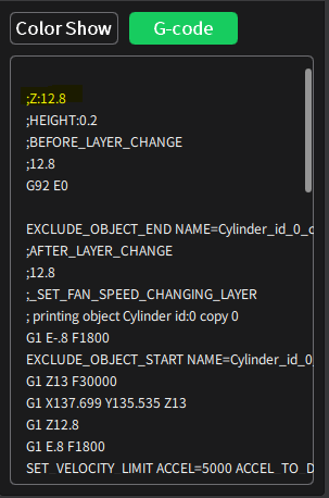

Creality print v5.1.6 how do I auto-pause print to change filament color?

O. my ender 3 v3 KE all I have to do is set an M600 command in any chosen line after presing slice (look for the + sign). But if you prefer to use Cura, just go to modify gcode and choose filament change. Keep in mind that printer’s firmware has to admit it, wich is the norm.

After slicing is complete, look at the G-CODE tab in the preview tab, not the COLOR SHOW tab, to find the layer where you want to pause. Note that you should look at the layer number in the G-CODE, not at the bottom of the slicing software, as the layer numbers shown by the slicing software and the printer may differ.
Unfortunately the gcode in my version or any other versions of Creality Print does not show the layer number… I hope in a future version it does…
You probably could figure it out by matching the layer height..
