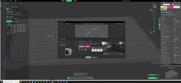

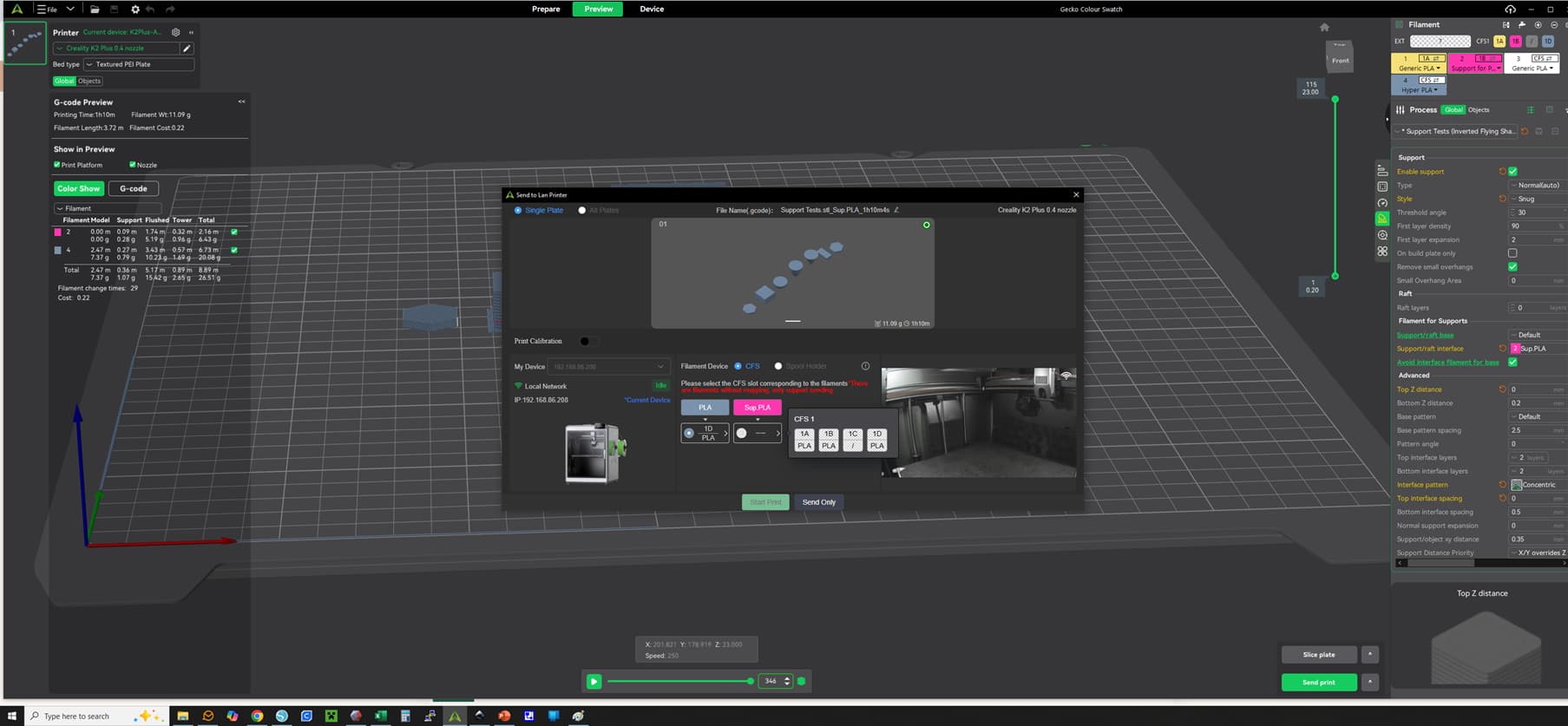

Having same issue trying to use dedicated support filament. By selecting Reel 2 under ā€œFilament for Supportsā€ => ā€œSupport / raft interfaceā€ it seems to create a category of filament called ā€œSup. PLAā€ā€¦and I’ve been into the CFS settings and changed reel two to be
Brand: Generic
Type: PLA
Name: Generic Support for PLA
But when I go to print…
This is what worked for me:
Before slicing click the gear in the upper right-hand corner
Click on Generic PLA and any other filament types you are trying to print with . In my case ENDR PLA was not checked. I checked it and it worked.
Hope this helps!
