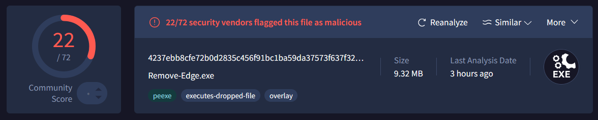

Creality Print v7.0.0.4127 - Adware:Win32/Tnega Detected in "Remove-Edge.exe" by Windows Defender
Hetzelfde W10 heeft alles gedelete
Warning High

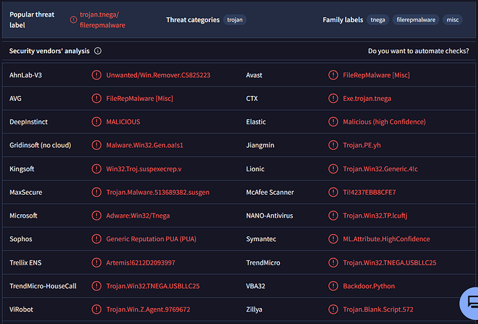

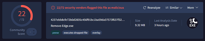

IMO, that’s a pathetic response from Creality. Their claims of a false-positive are contrary to the analysis of the file in question by VirusTotal…
Creality says that 22 security vendors are wrong. Their recommendations to turn off security software and/or wait for the next version are stunning.
I could give them the benefit of the doubt and assume this was unintentional. However, this is quite generous considering the findings just in this thread, Regardless, Creality, you made a mistake. It’s not so much the mistake itself but how you respond and make it right. You are not handling this well and savvy users are taking note.
Acknowledge the problem, pull the affected version before any more damage is done, apologize to your customers, hold your R&D team accountable, and release a version without this malware.

Which file did you test? Only Remove-Edge.exe, which is bundled with the Creality-7 package causes the alarm. Only 1/3 (roughly) of the virus checkers detect it. Many virus detectors will remove or isolate Remove-Edge.exe silently. There is a very good chance your virus detection has done its job and you are good to go.
I would agree that those 22 security vendors are indeed wrong.
Take a look at the github link I posted earlier, thats the project and source code to that application.
Chances are that its not going to run it on your computer anyway, but it is harmless anyhow.
and @PBusardo @Crealitykiwi We may just be squabbling about the definition of Malware. Virus checkers use several methods to determine if a file is infected. Different Virus checkers use some or many of the methods. Most of the methods are marginally effective depending on how sophisticated the virus is. anything that has a virus signature, can be re-programmed to avoid that signature. One method of virus detection that is very hard to fool is “heuristics”. Heuristic’s, in the virus detection world, means detecting a virus by its behavior, not by depending entirely on the virus signature.
The question becomes; If it is not listed as a virus, but it acts like a virus, is it a virus? That is a legitimate question and a source of considerable debate in the security community. Many say it is a false positive if the file is not proven to be a virus in a lab environment. Others say (myself included) “if it walks like a duck and quacks like a duck, it is a duck”. Remove-Edge.exe behaves like the Tnega virus. I do not care if it is the exact code match for Tnega. It sends information to five domains, four of which are not listed in common DNS. That is unacceptable to me. If you consider that a false positive, that is O.k. It is really a matter of what sort of chances you are willing to take with the information on your computer (and in many cases across your network). If you are printing toys for friends and their children, on a computer with no crittical personal information, then; no harm, no foul, no virus. If you work on original designs for an employer (especially a government employer). this is a really big deal. Definitely a virus. Even though I’m retired, my mindset falls in the latter camp. I do have valuable information on the computer that I use to print. I just can’t take the chance.
With all that said, the actual behavior of Remove-Edge.exe is easy to manage as many have observed. My real frustration (which has escalated to anger) here is Creality’ s behavior. First and foremost, Creality has been too opaque about an important issue. Their response to me and to @PBusardo is out right disdainful. Second this clearly demonstrates that they are not managing their software repository with responsibility and diligence. this version, containing this code, clearly should have never reached the commit stage. Now we have a trust issue. I no longer have confidence that Creality can safely manage an open source software repository and even if this is a just an isolated lapse of responsibility and diligence, the Companies response was counter-productive. In my experience it appears that Creality is allowing marketing to over-ride Engineering. That is almost always very bad for the end user, and that is us.

Yes, I checked the code. I disagree with your analysis. Harm is usually not obvious. Information stealers try to stay under the radar as much as possible. They often run for years before anyone finds them.
I very strongly recommend removing the file Remove-Edge.exe immediately after installation.

From what I can tell its just a compiled python script, the code definitely appears to remove a bunch of files and registry entries related to Microsoft edge.
Well, hmmm. I tried the download again, and it downloaded and installed with no errors. I did a search for the “Remove-Edge.exe” file and it was no longer there. I can’t tell if Creality fixed the download, or Windows Defender got smarter?
FYI… No issues with this release/install file:
I forwarded your suggestion to the R&D team, and they’ve released a new software package. Please download it using this link; this version will not trigger false alarms.
https://github.com/CrealityOfficial/CrealityPrint/releases/download/v7.0.0/CrealityPrint_7.0.0.4128_Release.exe
