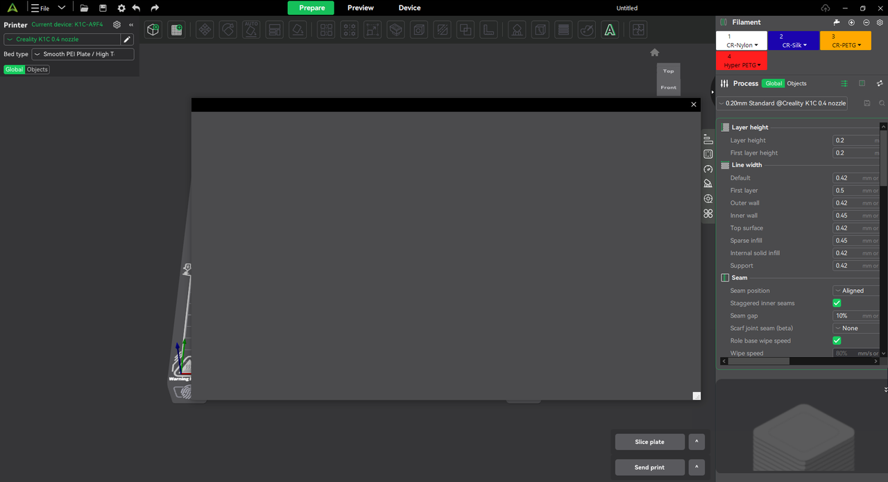

WebView installation failure may result in the following scenarios. Take corresponding steps based on the symptoms encountered:
The added printer page shows as blank
If WebView is not installed or has failed, the Add Printer page in Creality Print may appear blank.

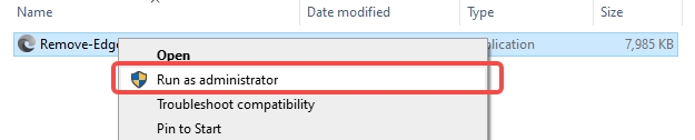

Uninstall existing Edge
Download the uninstaller:Releases · ShadowWhisperer/Remove-MS-Edge · GitHub
(Program source: https://github.com/ShadowWhisperer/Remove-MS-Edge)
Download and unzip the file and run it with administrator permission

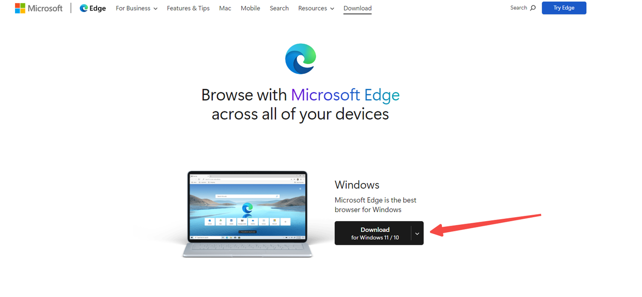

Reinstall Microsoft Edge
Redownload and install Edge browser from Microsoft’s official website: Download Microsoft Edge: Windows, macOS, iOS & Android

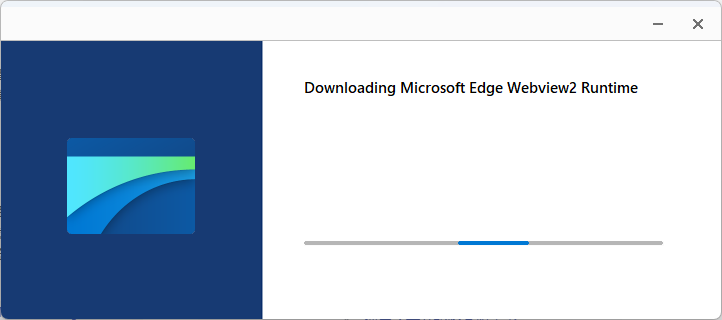

Download and install Microsoft WebView2
/microsoftedgewebview2runtimeinstallerx64.exe

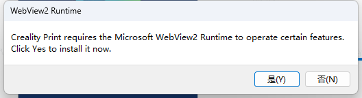

Restart Creality Print
After the Edge installation is complete, restart CrealityPrint,select Yes in the pop-up window, CrealityPrint will be launched automatically after the installation is complete.

This does not seem to work. I have followed the steps. I still get the error that it could not create the data directory. Creality seems to want to write to this directory but does not have permission. It should write to C:\Temp
